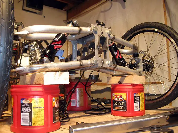

...but the big push came from finally getting the last of my suspension components, three 200 x 50mm 'Rock Shox' Monarch 2.1 air shocks - really couldn't finalize much of the front or rear suspensions without them as there's quite a bit of diversity in available sizes.
I decided to go without coil-overs & "just" air shocks simply because I haven't the slightest idea what my loading will be, air allowing for finer adjustment & there's the adjustable dampener - rebuild kits (seals etc) are also commonplace and inexpensive.
Chopped out the old shock mounts & roughed up some of my own, then trimmed & fit - jus' need to fab up a top plate for the A arm box & it's ready to weld;

I've gotta tack weld the chassis together today & make a coupla brackets, until I do I can't really finalize the rear suspension's location... cause the pesky thing keeps moving heh, but I did get the basics sorted, the lower mount cut and the shock location - good thing my fuel tank has such a large space in the middle, the shock fits perfect in there;

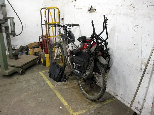

...and the Schwinn earnin' it's keep, haulin' frame bits in so I can weld them - outa be interesting to try and get the frame back home again when it's all one piece heh;

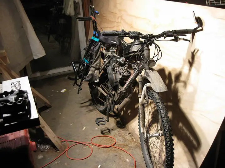

Defo Silver, that poor Schwinn is gettin' crusty with a quickness - tho it's got the advantage of being an aluminum frame, everythin' else is not pleased with my abuses lol Still, much as I like it, it was never more than a prototype/experiment as at the time I jus' wanted ta see if these weird lil China Girls were worth the bother... somethin' like eight thousand miles later, I figure it's proved it's worth heh

So, after hours spent lining everything up, I knocked it all back down again & packed it up in, on & around the poor Schwinn again. If all goes well I'll tack weld the front suspension box to the pedal boom receiver, the receiver to the chassis, the upper rear shock mount & lower stay pivot to the frame...
Then I jus' gotta figure out how in heck I'll get it home again laff
