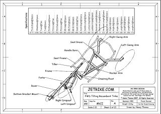

Anyhoo - it's no doubt completely unlike what yer talkin' about... but... speakin' of "leaners" I stumbled over this delta waaay early in my still daydreamin' phase and tried till my ears bled to figure out how to contort it into what I wanted - and failed miserably lol, mebbe it'll be of some interest *shrug* It'd be a smokin' dual drive etrike eh?
Jetrike.Com - FWD Tilting Recumbent Trike
Still, it's really nifty particularly as it's "open source" w/all free access, jus' sharing plans & dreams - here's the link to a bunch of his detailed plans in .pdf format: Jetrike.Com - Download Plans and I really like this page of all kindsa other designs inc. links to their patent renderings: Jetrike.Com - Prior Art & his "fundamentals" page is purty ossum: Jetrike.Com - Theory ...and last but not least, I really like his straightforward honesty - if there's a problem he's quick to point it out, like pedal induced steering issues with his front wheel drive design :)

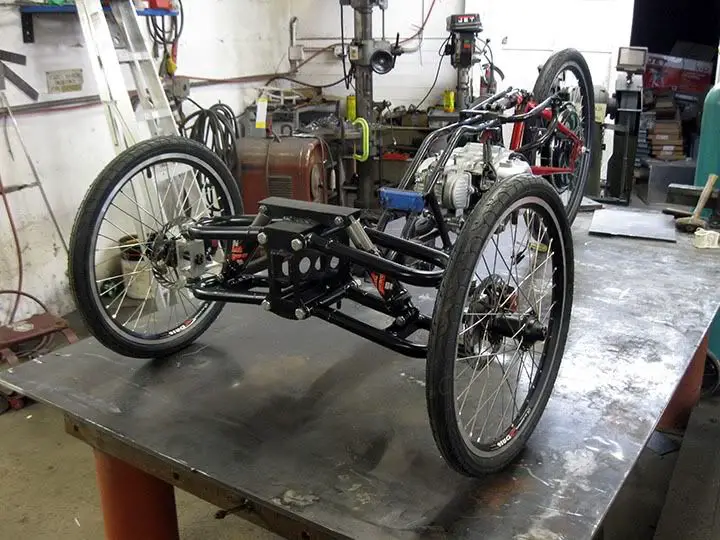

So, being the helpful type - I hid in the corner and played around with my taddy's suspension geometry & started fabbin' up the front caliper mounts heh
I was a bit concerned when I first got the Rock Shox 'Monarchs' mounted up - the fronts seemed ok, but the rear one was awful easy to compress. Worrying that I'd overlooked something in the leverage & travel estimates, I hoped that it was jus' low on pressure - and it was lol, having only 60psi of the maximum 275psi possible: Monarch User Manual. While this itself is some small cause for concern as the Monarchs had suffered a brief recall when they first came out for leaky schrader valves, not only are the rebuild kits for the entire shock inexpensive - we're all familiar with how easy schrader valves are to deal with. Turns out it's a moot point in any case as it's holding pressure fine *shrug*
Technically... I prolly outa not have done this as the front A arms are still only jus' tacked together & it coulda ended up badly with me on the floor w/busted up bits o'trike pokin' outa awkward places... but I couldn't help meself and decided to sit very carefully on the taddy to check suspension sag, travel and overall moments. I didn't have the seat w/me naturally and it's... a bit uncomfortable heh, but I learned to my great relief that all of my shock mount locations save one are jus' where they need to be - and that one that isn't is the only one still jus' tack welded, the rearmost mount on the stays. w/a 3:1 ratio I've a 3/4" drop for 1/4" shock compression & it drops jus' that much w/a squishy 175psi (25psi less than reco for my body weight [not inc engine/batts], 100psi less than max) Leverage Ratio Reference Chart - sooo, by lowering the rearmost mount by 1/4" I'll "perk" up the rear of the trike, allowing it to settle in "perfectly" parallel with the ground under loaded conditions.... prolly lol... tho it outa be fine as I've given myself quite a bit of "wiggle room" w/low air pressure, doubtlessly I'll run it quite a bit firmer than that.
Makin' the front caliper mounts wasn't so easy as they're both "lefts" - they make right and left calipers ofc, but it's seems they're roughly four times the cost for the same capabilities - so I decided to do what other DIYers have done & used two lefties, which ofc makes the mounting... downright odd. Ah well, all DIY projects are a compromise between time and money & I've a heck of a lot more the former then the latter lol, and as I'm downright stubborn about havin' all of the calipers be the same (replacement parts/pads) - to "upgrade" to a model that offers a rightie, yet only has the same braking ability AND getting no less than three of them @ 4x the price jus' wasn't gonna happen.
So now I've got some weird, asymmetrical elephant ear lookin' caliper mounts fabbed up & ready to zot... I can't for the life of me decide ifn' some lighting holes will help them look better or worse, or if it's somethin' anyone other'n me will even ever notice heh, I s'pose the important thing is that they line up & work right *crosses fingers*

Yeppers, at long last the entire front suspension assembly, spindles & brake mounts are FINISHED w00t!!! Fully welded up it's "finaled" save for minor cosmetic work which will be the last step. As I'm planning on sandblasting all of the steel components, such nit-picky details will hafta wait till after that ofc - the paint that's on it currently is simply to stave off rust (and to highlight imperfections), I hope to have the taddy powdercoated by a local shop when all's done & said.
Now that I've managed to get that out of the way I can move on to other things, tack welding the intake manifold has allowed me to establish the motor's position & tack weld the motor mounts as well... to say it's a bit of a tight squeeze may be an understatement lol, fortunately I remembered to shim to account for gasket thicknesses - but as the flanges are so thick and it's the remote choke actuator that's causing all the ruckus I've a bit more "wiggle room" than how it appears in the pics, I can shave/shim the flanges if needed & even reroute the choke's cable mount if it seems to be a problem later. For now - it appears jus' fine w/the only "issue" being that in order to remove the carb and/or the engine from the taddy, I need to pull it by removing the manifold from the intake instead of jus' the carby... but I knew that was gonna be the case ever since I did the frame *shrug*

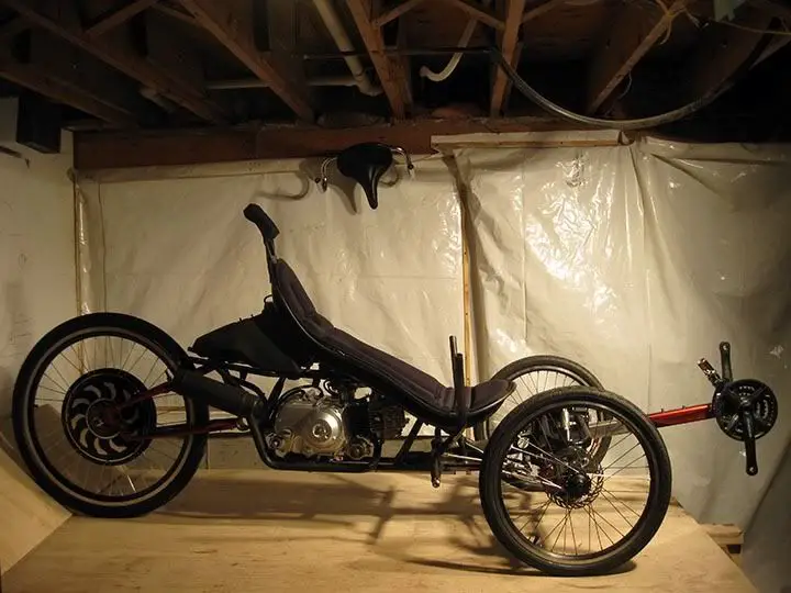

I jus' got it back home again after finishing up the last batch of welding tasks for this round, set the seat & stuff on it sos I could set on it for the first time ...aaand I'm overjoyed to report that my wild guestimates, daydreams, and indecipherable doodles that I like to call "math" have actually resulted in success!!! Everything is where it needs to be! ...not quite sure how that happened, but hey - I'll take it lol
I also realized something that should have occurred to me long ago - it my be comfy & fits like a glove (it outa, I made it fer me heh)... but sitting there w/hands on the controls jus' about a foot off the ground I did finally notice that this thing is gonna be terrifying to ride O.O I can't wait heh
Now I've gotta figure out about a gazillion mounts & whatnot... but here's a coupla updated pics;
