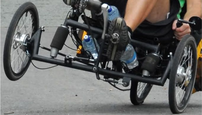

Here's a pic of something similar on a taddy;
Tho as it stands I think I like your trailing arm suspension idea a bit better as it takes bit less vertical room, particularly in the middle of the chassis where I've already got some height issues. Granted, the dual A arm doesn't help w/that either - but I've already ordered 'em so well see lol... The more I think about it the more I'm liking the advantages of the beam & trailing arm suspension should the A arm setup not work... but I'm gonna skip the chrome ifn ya don't mind :p
