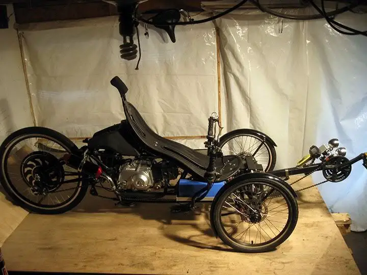

I did get me new shiny toys finally and I gotta say I'm stoked! While everythin' is just resting in place (helped mebbe w/a squeeze clamp or two) it looks like I'll not be trimmin' down the front fenders at all, I really dig 'em jus' the way they are... tho I will need to find a rear one - and the Vapor speedometer/tach/etc? Much to my relief it fits perfectly exactly where I wanted it, indicator light dash & all :D
With a lil more than 1/2" on either side it tucks in between the pedal cranks like it was meant to be there - it's a lil far to be messin' with it's buttons ofc, but I don't mind, don't need them "in flight" so to speak (and they make a remote anyway ofc lol), more importantly it's easy to see while still keepin' an eye on the road ahead, the bar graph & speedometer numbers plenty large enough despite the distance. The engine temp is a lil small, but it has (programmable) warning lights so no matter.
I obv need to make mount plates for everything, the fenders are pretty easy w/jus a coupla tabs needed & ya can prolly see why I didn't cut the old D tube down on the bottom bracket yet as it'll be part of the speedometer mount... and until I had the speedometer, I couldn't know where to cut lol

Well what with thanksgiving cold season & being all cracked out on the cough syrup again I've not managed to get much done, seems I can't be trusted to cut a straight line in my condition heh - still, I managed to cob together a test mount for the Vapor instrument panel, though it's just for testing and I won't be keeping it *shrug*
I really wanted to be sure there'd be no pedal interference issues, that it wouldn't be too close to the front derailleur and chain yet would still be easy to see, & to be sure of that I had to somehow manage to have the dash where it's supposed to be and pedal the thing... so a throw-away test mount seemed the best answer, particularly as I haven't got wide enough channel to make it for reals in any case lol
There's also the issue of I'd like the dash mount to also serve as a headlight mount, but until I get said headlights I haven't really any idea how that's gonna work save the vaguest "well, make it longer w/a crossbar" kinda thought... yea, prolly better to wait till I have the headlights :p
Anyway, after cuttin' down the old seat post tube & some tinkerin' I got the thing stuck in place, clambered aboard (sketchy whilst it's up on the bench YAY) and pedaled it (there may have been some vroomie noises made) and much to my relief - it's just peachy. The mount needs to set about 1/2" lower with the dash about an inch or two higher up on the mount, but that's jus' me bein' particular about it and another good reason for a test mount I figure ;)

Speaking of "sorting things out" I went and built another test dash mount w/lighting in mind this time, unitizing it all in one mount to try and simplify things a bit... usin' an old chunk of a (bent thus useless) carpenter's square & a pair of wallyworld halogen driving lights I managed to get everything's locations sorted - I may or may not keep these particular driving lights, I don't much like chrome but it's what they had lol
They're also 50 watt halogens & together, a bit too much for my itty-bitty ICE charging system to handle, tho the light (spot) is simply awesome. I'll be swapping the lower light's bulb to a 12v LED for normal use (daytime driving light & low beam) & if the 50 watt halogen still proves too much, I'll pick up a 35 watt halogen bulb or thereabouts *shrug* Onboard electricity really isn't a problem w/this build given the battery packs, but I'd still like to conserve it as much as possible for the hub's use.
So, after figurin' locations & triple checking pedal/foot/derailleur clearances (any excuse to set on the thing lol) I got some shiny 3" wide aluminum stock, bent it up, hacked at it a bit and drilled some holes n'stuff - I'm particularly fond of the lil aluminum & rubber grommet anti vibration mounts that came w/the indicator dash accessory - so ofc I used em;
Re: The Bent Zombie Tribrid Tadpole Trike (build phase)
...and I'm diggin' it - or it's the best I can figure out anyway lol - I still need to weld a small "cap" under it to be sure it's secured to the old seat post tube as well as the rear and front mounts for the ol' "three points of contact" rule, but that'll hafta wait till tomorrow (yes, that's a happy time motor mount for the front YAY).
So, other'n that it's good to go with my lil GPS fitting perfectly under the Vapor dash so I don't get lost... as often anyway heh, tho I'll prolly paint the mount to reduce potential sun glare problems.

...but this isn't yer typical bike lol & my rear frame rails, top of the seat & fuel tank are all around the 8" mark so it "fits" the width of this build well - that is, if I had something to mount it to ofc.
So, this was one of those weekends - where I spent hours on end fiddling around w/the taddy, yet have not a dang thing to show for it heh. Fraught with indecision I've not figured out if I wanna just mount the taillight above the fuel tank... or scratch build a rear cargo rack for it to mount to. So I spent my time measuring out & sketching rack ideas (as obv that's the harder of the two) & the more I got into it - the more of a challenge it became.
It's trickier than it seems. As the rear wheel is suspended there's travel clearance that needs to be considered & as the tank & seat are so low in relation to the wheel the rack needs to be higher than expected, which ends up lookin' kinda gommey - tho it's got the advantages of being suspended & I can integrate mounts for panniers. If I mount the rack to the stays instead it's nice & low, matching the rest of the build - but it'd be unsuspended and kinda far back, defo too far back for panniers & I wouldn't want that much unsuspended cargo weight anyway...
...not satisfied with anything I've come up with so far, I switched tactics and actually cleaned up my shop a bit instead heh - which seems to only happen when I've got a project brain lock. I've got a deck designed for a potential rack, I'll prolly cut & bend that out today at work to help visualize the issue.
In any case, with the bench nice & clean I took summore pics & as usual, some items are just resting/clamped in place ofc, yes - my front fenders are still crooked lol
