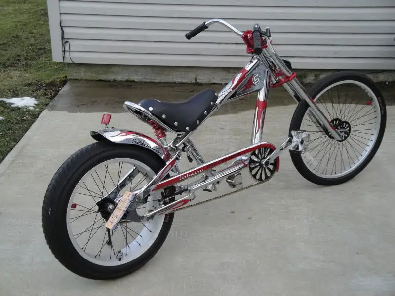

Gorewound - I found this idea for supporting the OCC seat. It was on Ratrodbikes.com
