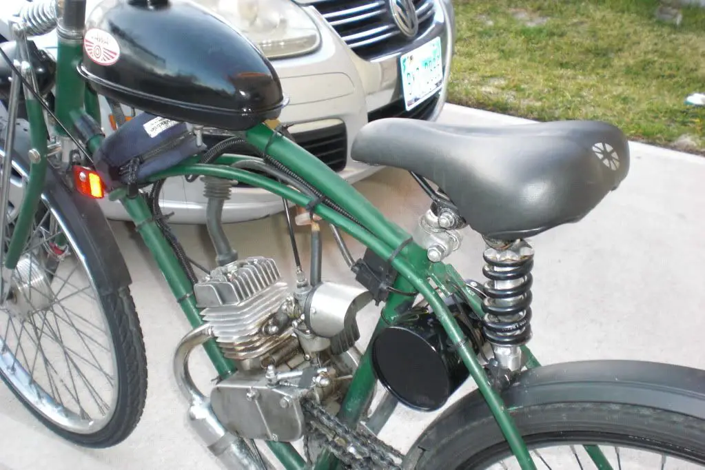

You could rig up something to support the rear of the seat. I used a pocket rocket shock.
That's a cool idea... I used a go kart front shock for my front suspension since it was originally one of those polymer type shocks and I wanted something that wouldn't melt with age, and a true oil dampped shock.
For your seat idea, that would be a very viable alternative for bikes without rear suspension both for ride comfort and to take most the shock load off the frame.

Wheelbender6, the spring on that shock is basically what i am looking for, but slipped over the seat post, attaching it at both ends will be the hard part. once the bike is moving again I plan on rolling around some junkyards for something to use (I don't wanna buy a new shock just to rip it apart) my hope is that the El-Cheapo method will work just well enough to offset it's near zero cost.
Check these out just for fun http://www.scooterparts4less.com/ALL_Shocks.htm ............Curt
Excellent link Indeed... Bookmarked here too.
My front end uses a modified go kart shock, modified in the sense that I had to drill the bottom eye hole out to 5/8" and the top hole to 1/2", then use a MTB spring to get the right spring rate. Looking at the availability on that site they might just have one with the right spring rate and length pre made, but I do see some that would work if I make a swing arm and dual shock setup for the rear... Now you got me thinking again :D
