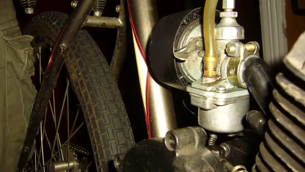

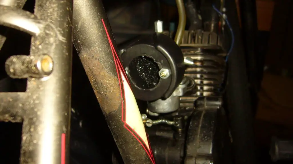

We started working on my bike.
The frame is a bit smaller than my son's cranbrook, so we cut the intake and and repositioned it and welded it together so the carb will set off on an angle.
the only issue with the reposition is I am going to have to be really careful pedaling so I dont kick the air cleaner. It looks like the throttle cable is tight against the frame but it was the maximum amount of room i could give it without drilling a hole in the frame.
