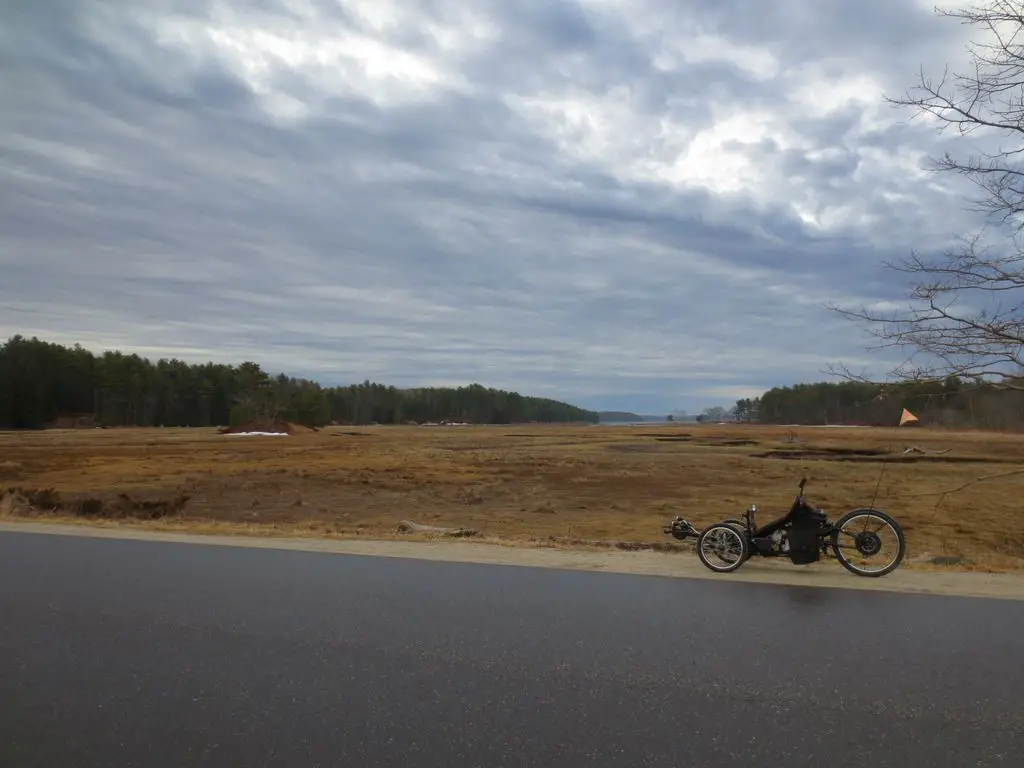

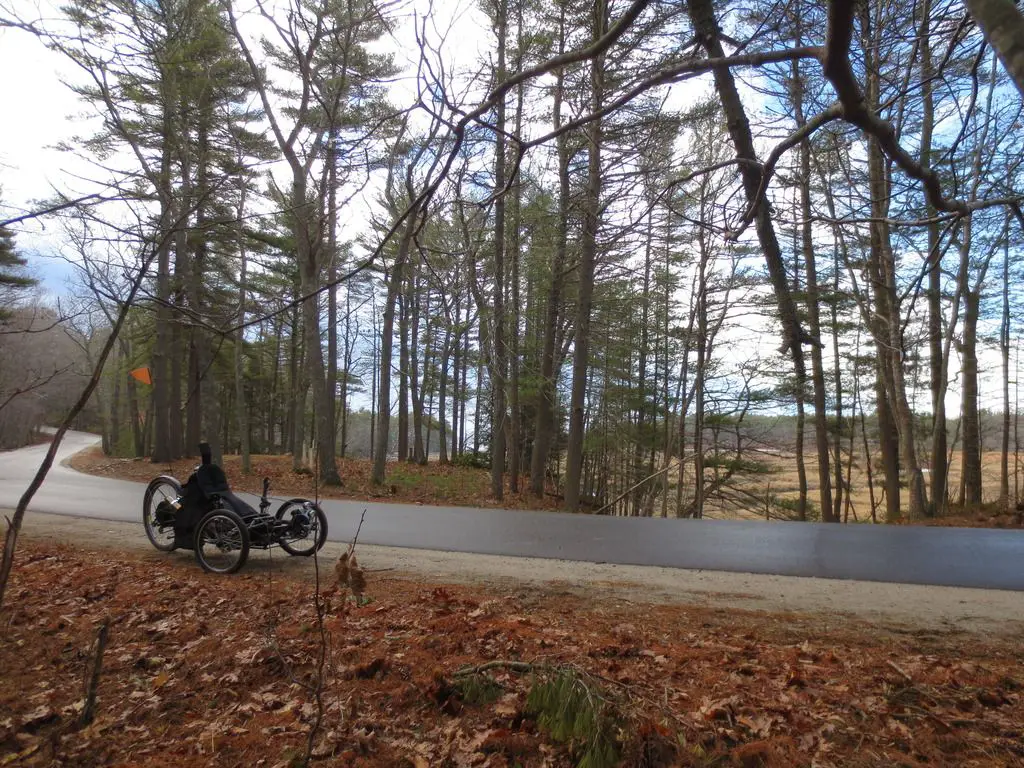

Hello old friend! I see you have bike riding weather again in Maine. Must be good to take the tadpole out for a run. It looks as fine as ever. What a machine! Does the old Rollfast ever get ridden?

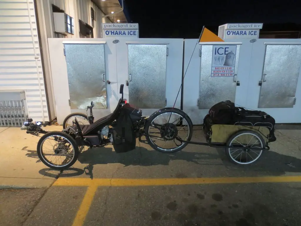

Seems the tad is a heck of a lot better at haulin' firewood then it is hittin' the trails lol... ofc my trailer is displeased either way... silly thing, I still need to make a better one;
