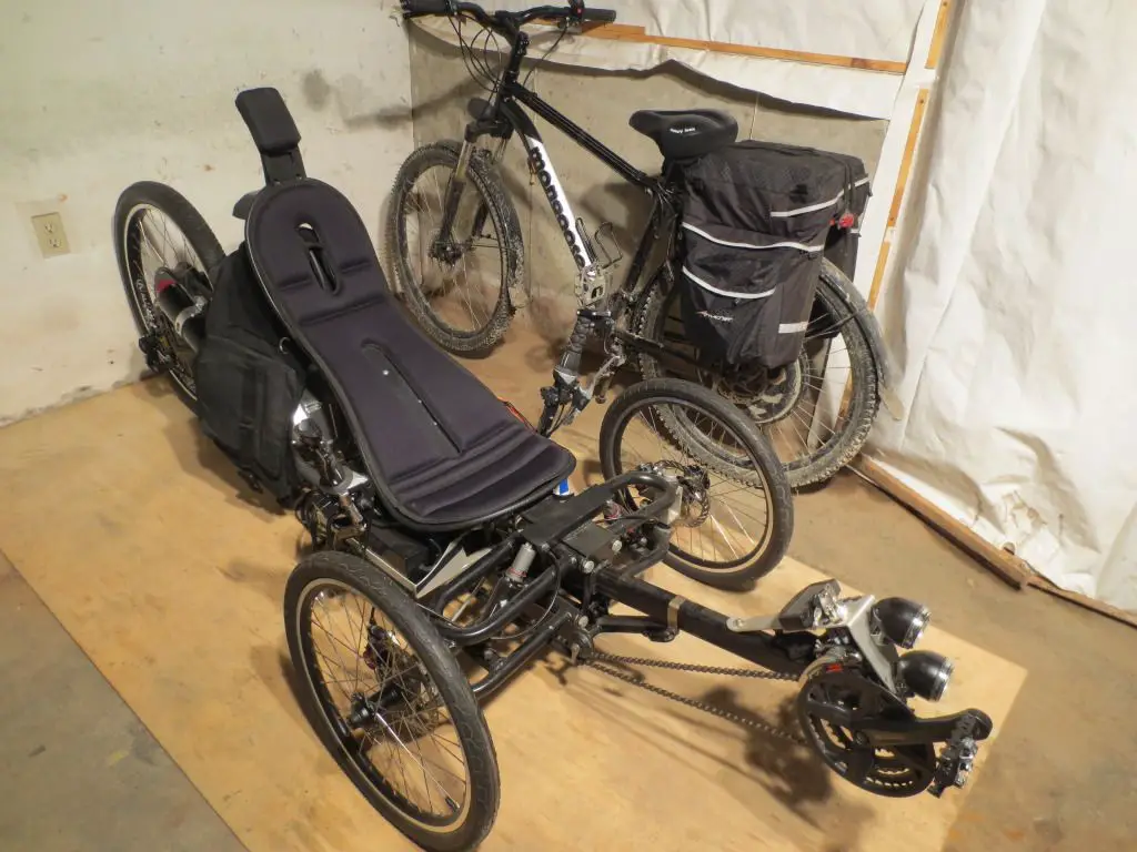

So, the time had come for the taddy to no longer be "put on a pedestal" so to speak, it needs be on the floor for the final assemblies. So I installed tie-downs to raise the project, to clean & disassemble the project table & then lower it to the floor... I'll spare you the woes of a filthy shop, but I'll admit it was more of a bother to clean then it shoulda been lol
While the taddy isn't that heavy at all, it's cumbersome to lift. With two people it's no problem, but waking a friend at 3am when the tinkerin' urge hits is a pretty good way to strain a friendship heh, besides it outa be handy for the occasional flood too I figure;
It seems so little settin' on the floor o_O

I've done a buncha assorted lil things in the meantime, most insignificant & some more experimentation... I'm still fiddling around with the upper seat mount trying for "perfect" (which is no doubt a myth), did some more electric system trials, finally attached the seat cover, but in all honesty as it's on the floor now, I might have spent a disproportionate amount of time jus' settin on the thing & chuckling... and attending to some ergonomics such as the above (amazing how 1/2" will change a seat frm awesome to eergh), handle bar & pedal boom position etc. ...ok, mebbe a lot of just makin' vroomie noises & leaning into those hard turns lol
Now that the rear wheel & cassette is finalized, I did get around to modifying a rear derailleur to fit, I'm hesitant to say "finalized" though it should do fine - but it is a junk derailleur, tho a new shimano it's a stock take off from a box store bike, as they tend to refuse to index properly I'll replace it when it irritates me enough.
I stuck poor, filthy Mongo in the background of the last coupla pics for scale as although the taddy is obv settin on a 4x8' sheet of plywood, it's still kinda hard to figure scale w/o a reference;

Oh boy! Looks like it is a few feet closer to making an escape outside... maybe by spring or early summer. I'm so used to seeing pictures of it in your basement it will be a shock to see it with trees and such for background. Eventually we are going to want to see a vid of it in action being ridden by our fearless super moderator wearing full regalia of flowing hero cape, mask, tights and colorful boots Taddyman Rides Like The Wind or maybe just Taddyman Breaks Wind! It will be a classic video...
SB
fasteddy
Feb 13, 2009
7,487
4,999
British Columbia Canada
Re: The Bent Zombie Tribrid Tadpole Trike (build phase)
Wow, On the ground and nearly ready. How many times did you live this moment over the builds life time.
Also in my opinion a real friend would be up at 3am helping you.
Looking wonderful Sir.
