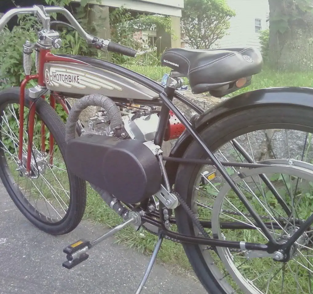

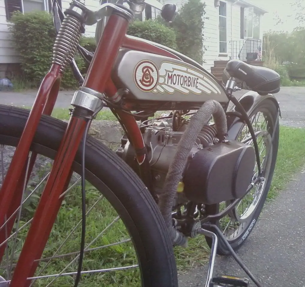

Here are some pics I took this morn before a ride...sadly the ride was short I had to go to work.
A fantastic ride chain :) more beautiful than I could have imagined. The decals were the right choice too. Just one more question, did ya name her yet? :)

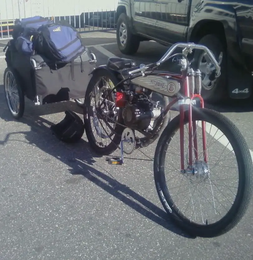

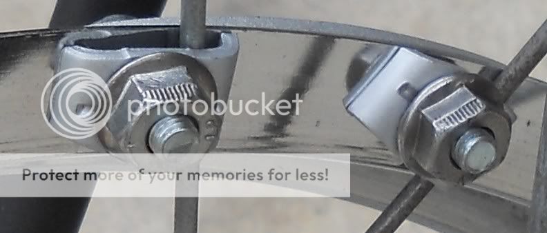

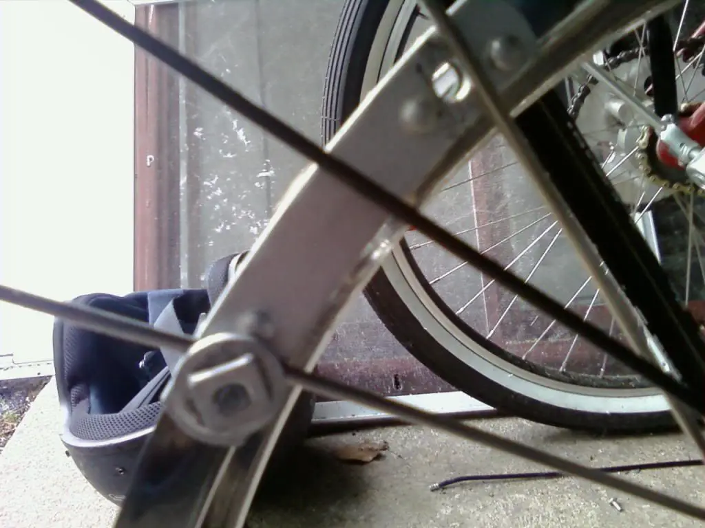

I took the bike over to Marthas Vineyard last week for a camping trip...lots of looks and questions. Pulled a trailer with about 75 lbs with no real issues. Snapped a throttle cable so I went to a bike shop the first shop owner wouldnt even acnowledge Me..the guy across the street hooked Me up with a new cable for a couple bucks. Had to switch My throttle (tried everything to get it to stay in place.. kept slipping around. I installed the SBP throttle. I need to replace a pulley in the gearbox it disenegrated on Me yesterday. Here is a pic of the bike with trailer and a pic for SB of the sheave mount.

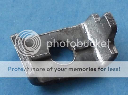

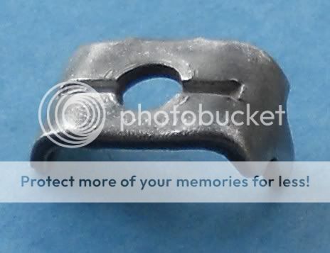

Way to go, chain. Very nice bike. Total vintage look. Another way to attach the rear pulley is by using control cable clamps found on most small engines. I collected used ones and purchased the rest from the local lawnmower repair shop. A little trimming on the two legs of the clamp and it fits nicely. On the original Whizzer pulleys, they all face the same direction, but on the late Whizzer pulleys they fit in opposing directions unless you have a large flange as on a drum brake like mine in which case I used a late pulley and they all face the same way. Hope this helps because I searched for years trying to find a suitable clip and ended up with this method as being the most solid.
chain, oh gosh, how do I put this delicately....Your bike is still INCREDIBLY beautiful :) Hope I can see it! Peace

Thanks for the close up of the sheave and also thanks to msrfan for the alternative clamps. So many choices!
Your bike looks great and the tank looks good that way, I think, with it bare of paint and with just the decal. Do you have a link for where the decals can be found. Mine are badly damaged and I'm thinking about stripping it down and starting over.

That is a very nice looking bicycle Chainmaker!
