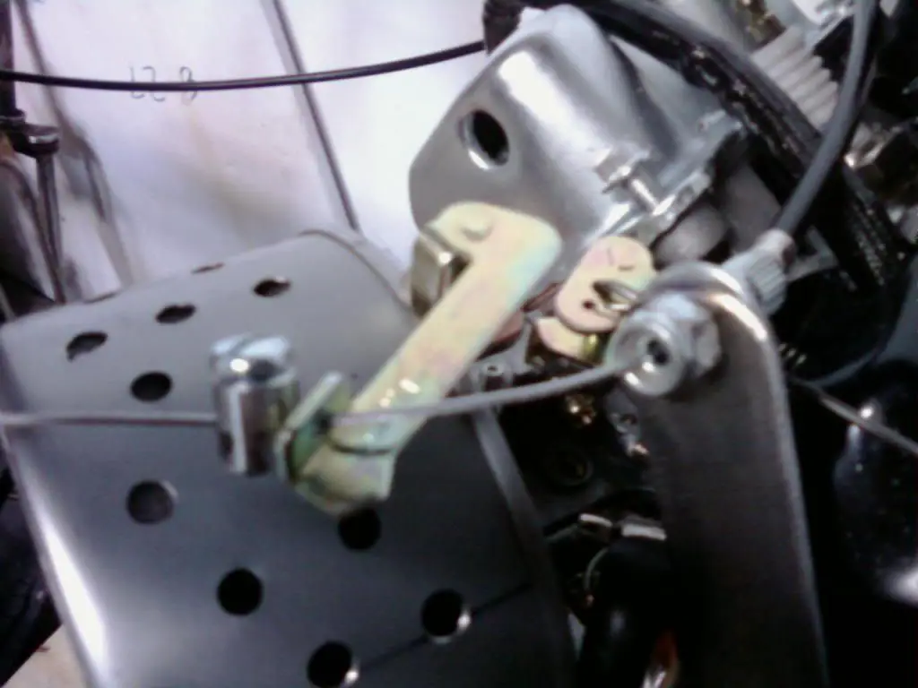

I picked up a throttle yesterday and hooked it up along with the stem choke lever. ( I need to get some tighter springs for both) Here is a pic of choke

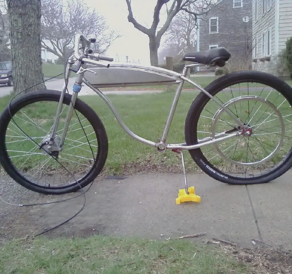

I received and installed the sheave on the rear wheel. New return springs on the choke and throttle. Put the bike together to check out the lines. Waiting for the EZ to arrive so the mounts can be welded in. After that a couple warm days to paint and put everything back together. (air in tires also)
Cool chain! Looking great. I like the idea of the choke cable though I'm not the biggest fan of your throttle setup (it's not mine ;) ) I can't wait to see it all together! Sure will be a sharp looking one :)
Very nice. You're getting close now. Hope everything lines up for you. that's going to be a smooth, sweet ride.

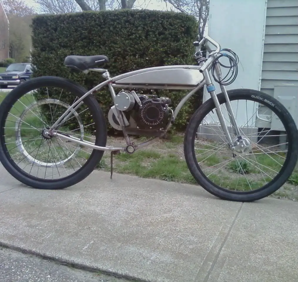

Here is a pic for posterity. Like Taco said He welded in the mounts "they are one with the frame" Off seting the motor wont work, the seat post is in the way. You can see in the pic how the drive pully bracket smacks right into the seatpost. They do sell shims for the sheaves so if I can find a pic Im going to try to make them myself add the shims to moving the motor over the 1/4 inch that I can..it will work. Thanks for the Help Taco !!, cool to meet a MB forum member. Silver bear, I will take some detailed pics for you when I take the wheel off for the shims.
That is a beauty Chain! I can't wait to see what you do. Sorry about your alignment troubles :(
thats cool on the spacers. def gonna have to spread the stays a bit for clearance. It was cool to meet you too. let me know when your ready for the exaust.

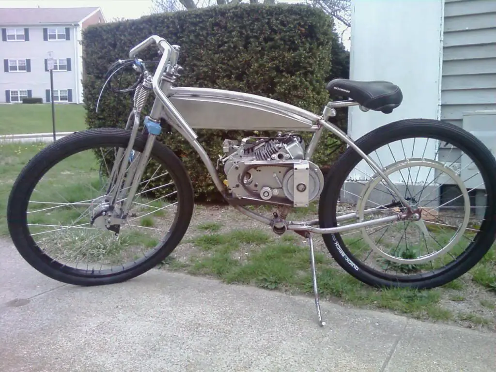

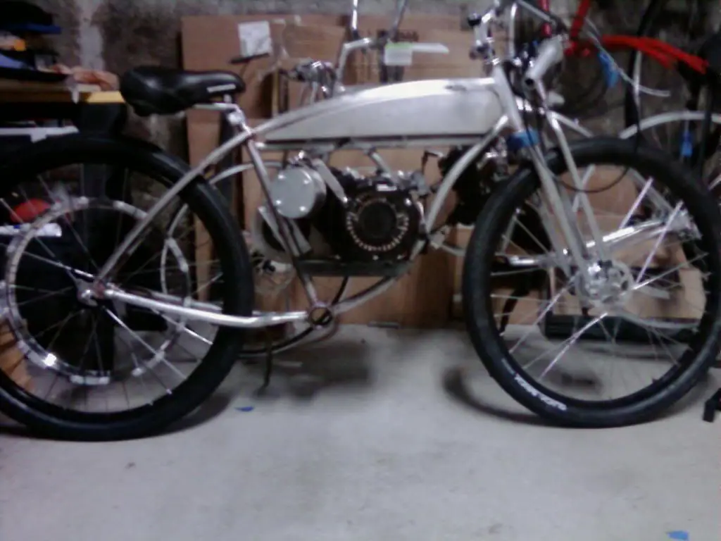

Got My motor moved over and the sheave all lined up with the pully. Good to go on that! Spent a day knocking out a punch list for the two bikes and shortening the to do list. Started working on a belt tensioner, measured for belts, and loc-tit a boatload of bolts. Pulled both bikes apart and gave them one last sanding. One last set of pics for before and after paint.
Good job Chain! Looking great! Sure is one beauty of a bike. You are bringing her to Jay's rally right? :)
