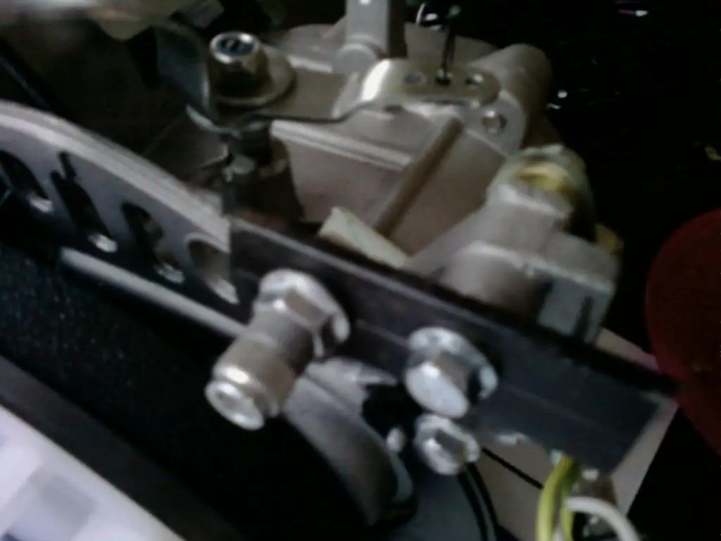

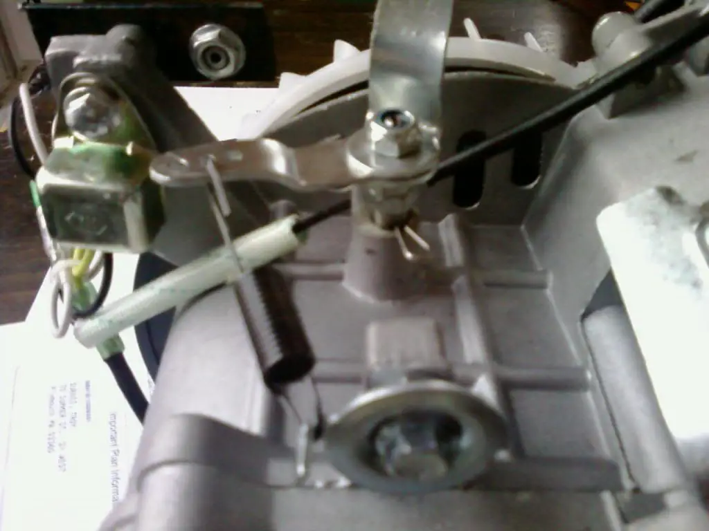

Took of the engine shrouds and painted them, I filed down the hip? on the choke swivel to give less resistance for a remote choke lever. I think I figured out My throttle for the most part, just need to order some swivels.

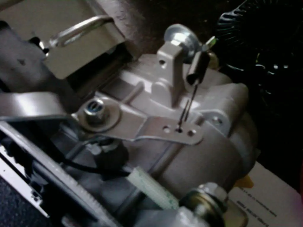

You can see where the cable will exit lined up with the hole for the swivel on the linkage
I havent got the throttle or cables yet but here is where the throttle cable will go through the housing into a swivel atop the governor
Lookin good chain! Not how I would do the throttle :p but still lookin good. A stocky little engine aint she?

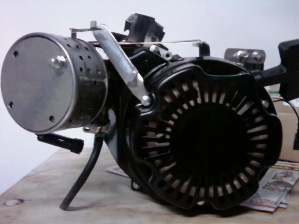

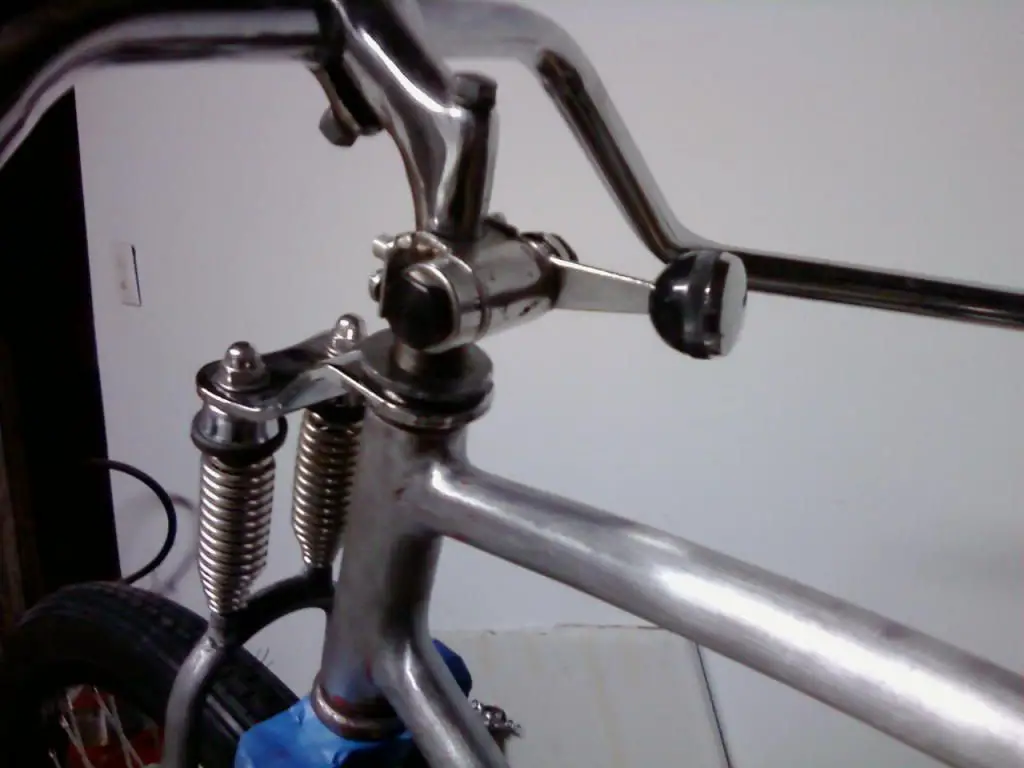

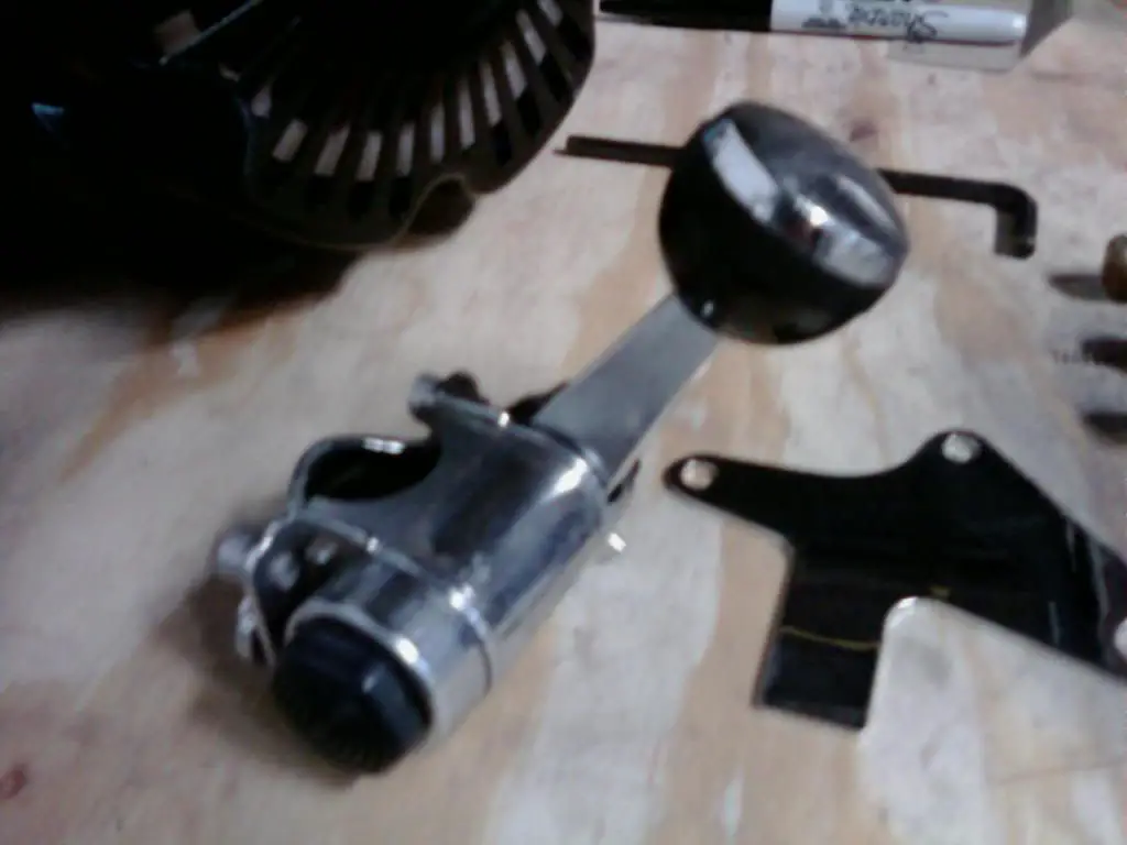

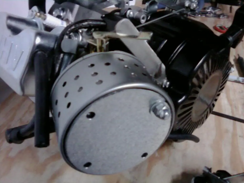

Been pretty busy..(with work) Got My Tuna Air filter done , made a bracket for the choke cable with some 1/8 x 3/4.I have a vintage stem shifter Im going to use as a choke lever. Been working on the Misses bike a bit more (started a new thread) waiting for the sheave to arrive, and got word My EZM kit should ship soon. As soon as it arrives Im taking it to a forum member for some angles welded in for mounts. Here are some Pics
Wow! Looking cool chain :) Is that metal bit bolted to the engine the imagined choke pulling assembly that the lever will go to? Your paint looks good on the housing btw :)
Thanks..LS. Yeah the thing that kinda looks like a spoon handle is where the cable will come out. Still have to get a throttle, some cables, and another layback seat post mine was commandeered for Her bike !
You may wanna twist the starter so it is easier to pull, just a thought. I'm thinking it could be a fun summer project to power my HF on woodgas :D We'll see :D
