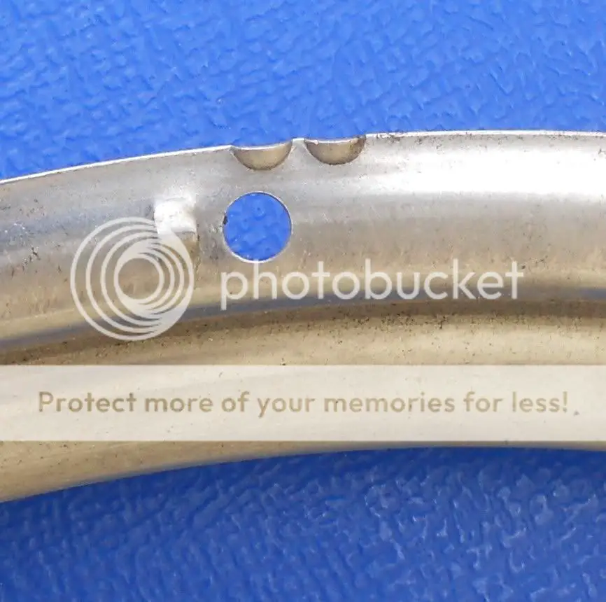

Way to go, chain. Very nice bike. Total vintage look. Another way to attach the rear pulley is by using control cable clamps found on most small engines. I collected used ones and purchased the rest from the local lawnmower repair shop. A little trimming on the two legs of the clamp and it fits nicely. On the original Whizzer pulleys, they all face the same direction, but on the late Whizzer pulleys they fit in opposing directions unless you have a large flange as on a drum brake like mine in which case I used a late pulley and they all face the same way. Hope this helps because I searched for years trying to find a suitable clip and ended up with this method as being the most solid.
Thanks for sharing that. Do you know of a commercial online supplier of those clamps? If we go this route it looks like you are using 1 per spoke times 36 spokes times two Indian builds (Fasteddy's and mine) which makes 72 clamps in total. My local small engine guy tends to be pricey and I doubt he even has that many on hand. The rear wheel I laced uses 12 gauge spokes and Steve's will be a Worksman which I think is 11 gauge. Looks like your clamps would work nicely with either gauge. I like that it snugs the sheave right up against the wheel, unlike the bent tabs approach. I'm trying to tuck things in as closely as I can to avoid a major alteration to the frame.

If you look close there are two different sheave's msrfan's is flat. The cable clamps is the best. But if you look and the other you can see reaised dimples next to were the clamps go, so a flat washer would be good enough,but would be better with a indent or reses for the spoke.
If you had acses to a press you could make some. two blocks of steel one with a reses and one with a raized hump. Just like the frame crimping tool that was made. Drill a hole in the right spot and put a washer in stick a pin to hold it and press, might even work with couple of bolts like the frame crimper?
That was my first thought was the cable clamps. Like the Indian I used to work with called Injinanuity................Curt
Hi curtisfox. The original whizzer pulleys had dimples to accommodate the spokes and just used a bent washer to retain each one. The modern Whizzer pulleys are flat and have different hole spacing.

Then you need to use cable clamps. As many lawn mowers my son and have fixed or scraped out I could have saved a bunch now I will, or make my own.......Curt

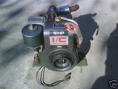

I got the governor out last night and the motor put back together minus the carb and throttle linkage as I might try drilling the jets from the tutorial on AGK. I should be putting the bike back together and be up running on Sunday. I thought Id share some info on My next project. I wont pic the bike up until sometime in August but I got a Briggs for an early birthday present here are the specs on it and a pic.
NEW OLD STOCK FACTORY TESTED 5HP BRIGGS ENGINE COMPLETE flat head
HEAVY DUTY MODEL MODIFIED FOR MILITARY USE MODEL 132436
DOUBLE BEARING BLOCK ,IC STEEL BORE ,INDUSTRIAL VALVE TRAIN,UPDRAFT CARB,WITH STATOR ,POINTLES IGNITION, MANUAL PULL START,CRANK IS 3/4" X 2 1/4" , 3/16" KEYED AND TAPPED MODIFIED FOR MILITARY USE, WILL ACCEPT ELECTRIC START

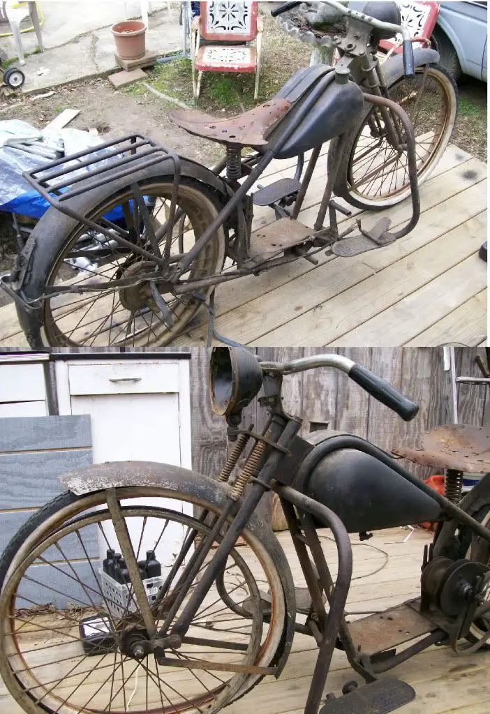

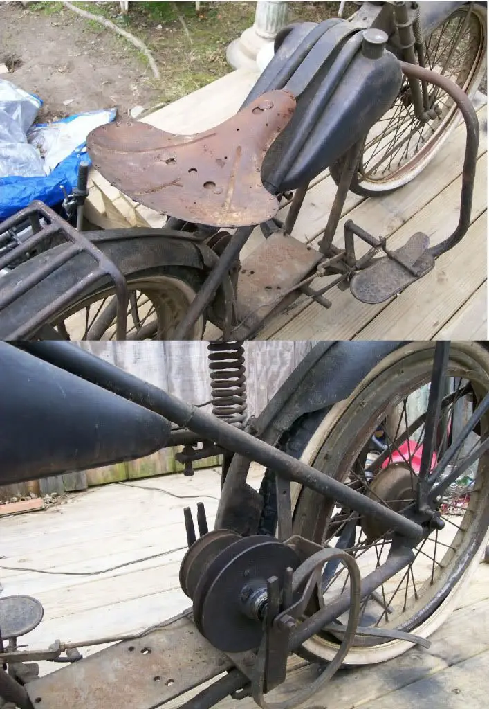

And Here is a pic of the Bike it’s a 1949 Simplex Servi-Cycle.. As I said I wont get the bike until august so Im not exactly sure what is going to be done with it but tenative plans include lacing a Worksman front drum brake in , Electric start, And the briggs will have some performance mods done to it. Other than that it plan on re-doing it pretty much stock.

Holy cow!!!! That engine is a real beauty and all, but it pales in comparison to that simplex. Unbelievable, I wish I had one of those, or the money for one for that matter. After seeing your other work I know this will be a good one :)

Thanks !! Im going for motorcycle legal. The Simplex motors are pretty scarce a complete if you can find one re-built run around 1200 clams. I plan on using some of msrfans little tricks to pretty up the motor if I cant find a simplex motor I can afford.

Nothing says you can't make your Simplex an improved version of the factory model. Electric start... woohoo! And better brakes. I look at that seat and visions of some nice foam padding and black harness leather come into my mind. If it were mine, I'd also want it street legal, licensed as a motorcycle and ride that baby for the rest of my days. Vrooommm...
