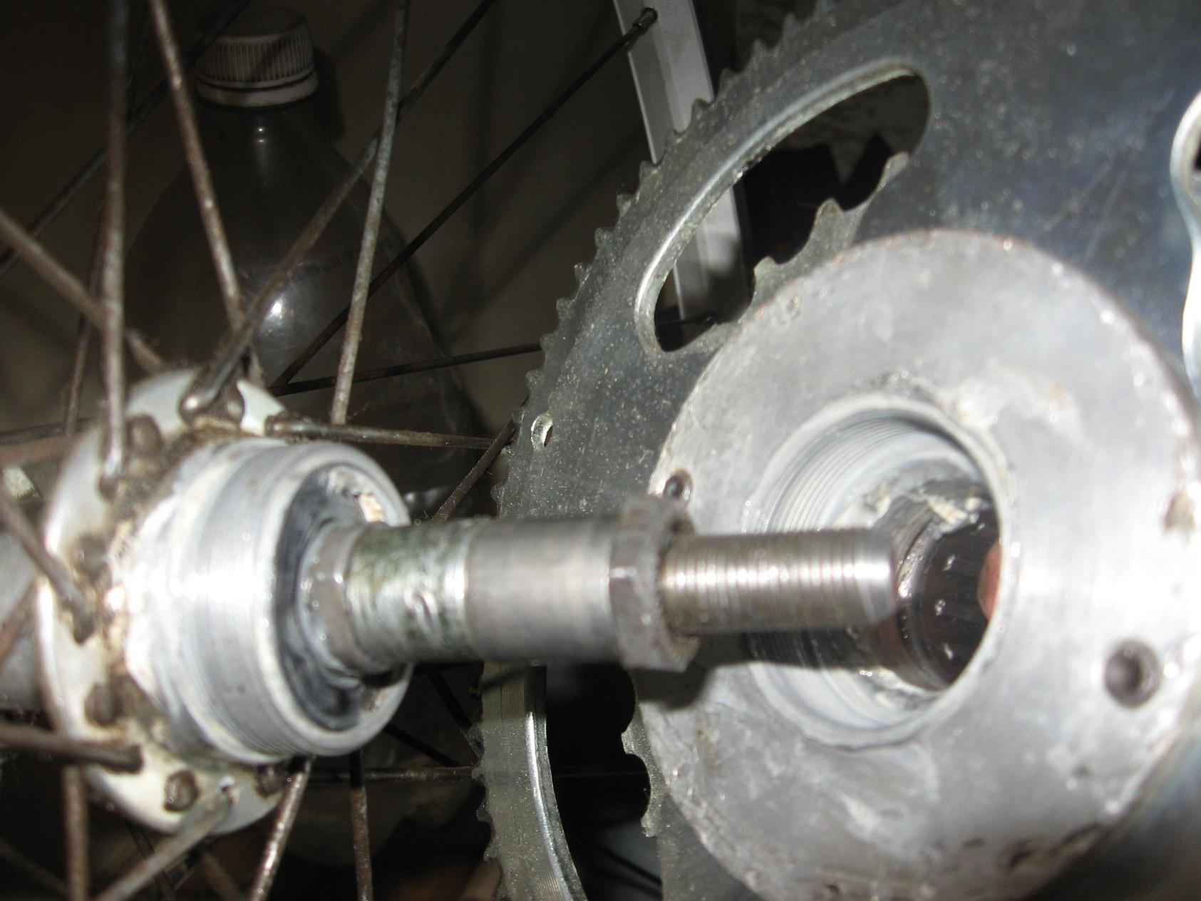

It seems to me that hub adapters are the best thing that s happened to those type systems. Also Staton Inc. has all kinds of goodies including hubs and left hand free wheels, adapters etc. for just about everything. They also sell heavy gauge spokes. I could easily spend all day just browsing their site. if you click on these links, you will see pics of my system where the adapter threads on to my hub.
http://motorbicycling.com/attachment.php?attachmentid=78527&d=1434381644
