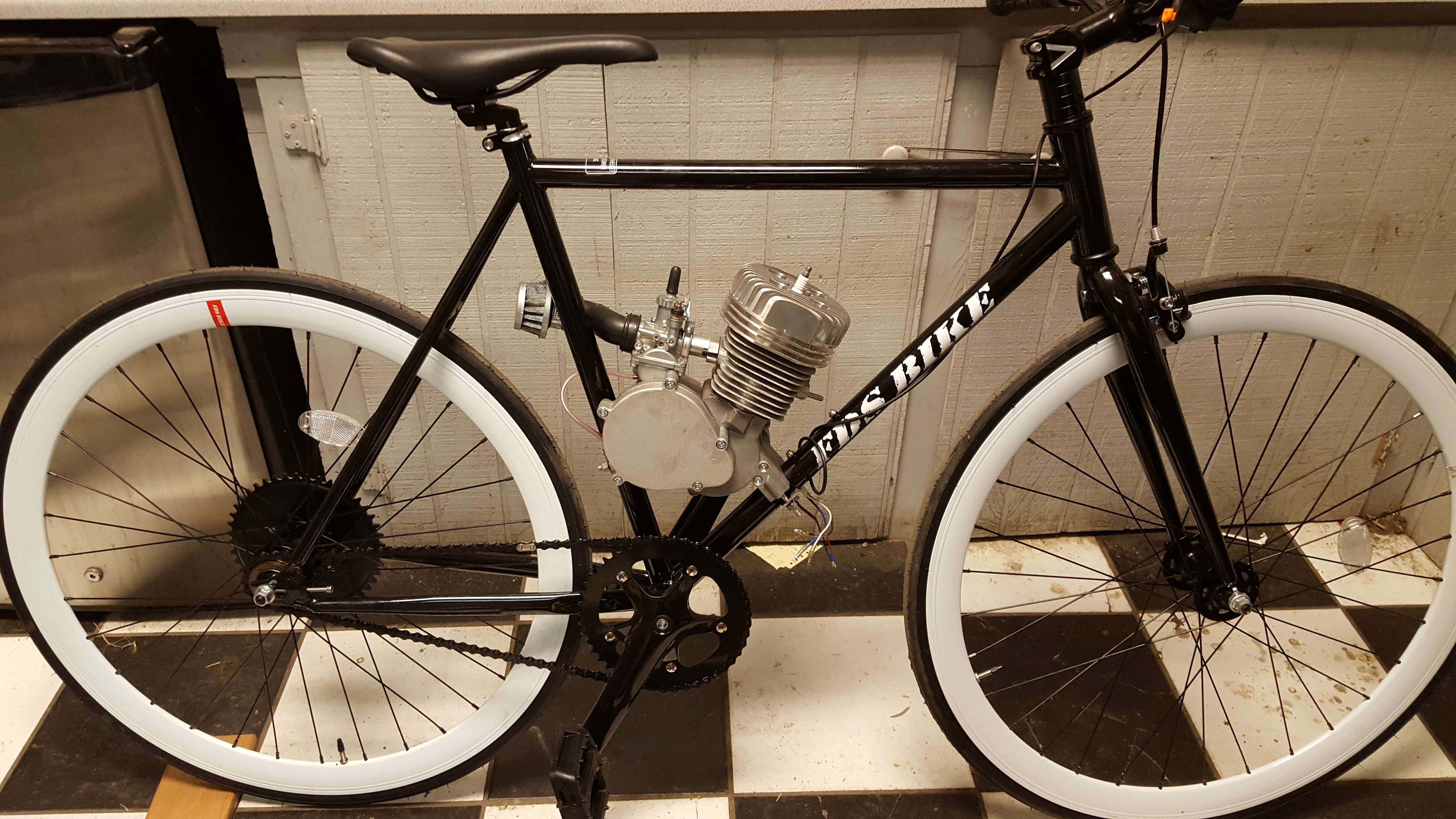

The project is now a ride-able bicycle. Now awaiting motor mount. . .
