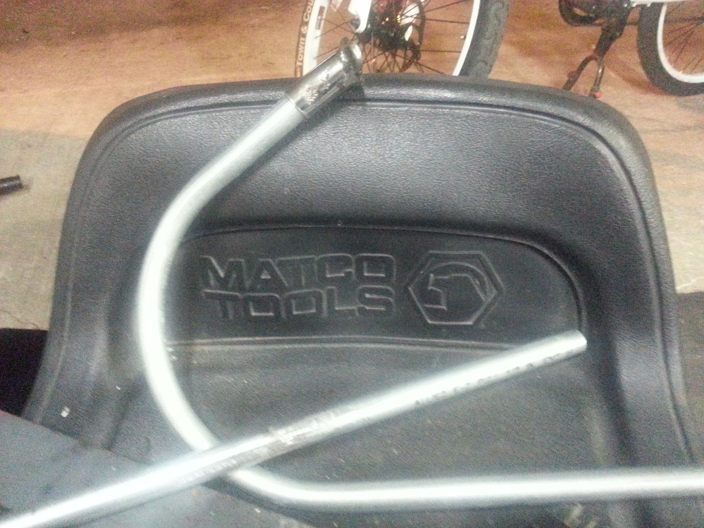

Went to Harbor Freight today. They are having their huge tent sale tomorrow, as a member of some HF deal they let me have tent prices today. Picked up their 90 flux wire welder. Never welded before and I gotta tell you it is some fun.
When I got home momma said walk the dogs and in an alley I just happen to find a bunch of perfectly good conduit just laying there. Imagine that. So I stated playing and this is my first fab project. bent the pipe and welded two pieces together for the straight piece. Don't know when I will use it but fun to know how.
I love this hobby...
Oh, the 212 motor is 99.00 bux might as well go get one tomorrow. Maybe I could use the pipe on that. LOL...

Know what you mean Pluto.
Hey, the bend and weld look great.
Got a welder and was teaching my self with the help of folks here. Was too funny. The phrases "You welded what to what!?" "You hit it with a sledge?" and "POOR bikes..." were used, lol.
One thing I was warned about and am glad, conduit can put off some nasty fumes. Just be sure to be in a well ventilated area.
Listen to what Dan said about fumes, conduit and any other galvanized pipe or tubing puts off lethel fumes if you breathe enough of it, I know people personally who have been in the hospital from zinc poisoning because of welding galvanized pipe and breathing to mush fumes..... its nasty stuff so be very careful.
