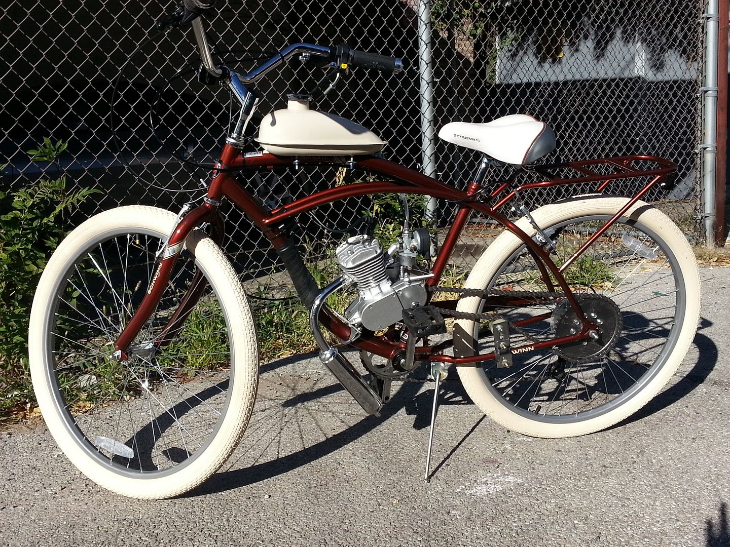

I finished this.
I think I have lost my mind. Can't stop playing with these things.
Will finish the Cheapo Mountain bike today as well.
Cant wait to start on a 4 stroker but need advise. Will have to check out all the builds on this site.
It is a sickness...
