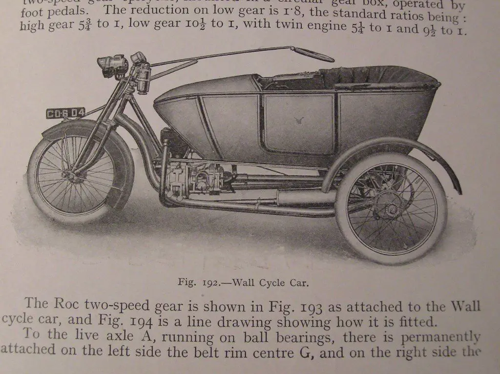

Is this a cyclecar? Or a Sopwith Camel?
Kudos, Intrepid. I was curious to see what car that lady in the picture was cranking. A Wall, eh? I wonder if they were temperamental, thus spawning the phrase "driving me up a Wall"? ;)

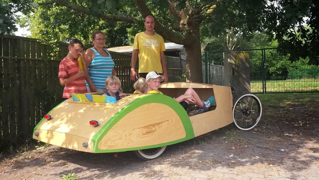

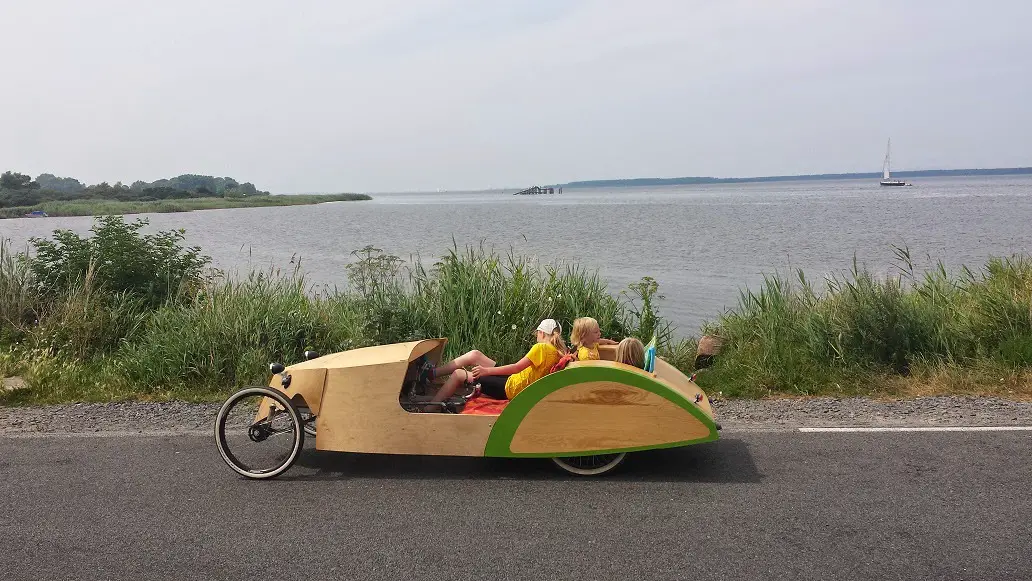

I stumbled over the Mochet Velocar a few years ago.
It was a German site of two collectors of the Velocars, that catches my interest.
The site can be found here
Although I wanted such a vehicle, there is no real chance to get one.
I guess, around ten to twenty vehicles in Central Europe survived.
In 2011 I started a Mochet inspired self build.
It's not an exact copy.
I mixed the simple Velocar concept with the use of todays bicycle parts.
For example nowadays rear wheel gearing or front wheels for recumbent trikes.
Due to the very complicated and expensive procedure of proving and permission of a self build bicycle motorisation, it's still just a pedal powered vehicle.
Only an electric 250 watt motor is planned (registration/license/tax/insurance-free)
More pics and description here
As you can see I build in a backseat for my younger childs.
It's also fitted with drum brakes in front and disc brakes in the rear.
Drivetrains for pilot and stoker are independent, basically like two recumbents welded together side by side.
Shifting system is recently an Shimano Alfine11 gear hub for the pilot and cassette shifting for the stoker.
I want to build a lighter version in plywood monocoque.
The recent vehicle weights around 80kg/160 pounds empty, due to the birch plywood I used for the shell.
Birch is strong but heavy and I will use the much lighter Gaboon/Okoume for the next build.

Hello Kai,
Thank you on presentation of your wonderful velocar! Great joy for entire family? What are your impressions for driving it around? Is it too hard?
It seems to me that you have strong chassis and plywood body is just for style and protection - doesn't have any structural influence? I like plywood too, but maybe better to use some kind of "corroplast" as Paul Elkins did? I am not sure how it could be named in Germany or elsewhere in Europe, but here in Swiss we had similar material in various colors - but I saw only smaller plates...
To stay in limits of E.U. regulative, we must have electric-motors up to 250 Watts (too small for velo-cars) and speeds up to 25 km/hour (not so bad)... But there could be some kind of "inocent" cheating - later add another motor of 250 Watts? Than, both of them powered with more Volts that is nominal - so could approach to 1 Kilo-Watt in total? That could be enough, with two persons pedaling!
I am thinking in such a way with my present HPV-quadricycle (or to use generator in hybrid style), but next vehicle (if ever built) could be in category of "Light Quadricycle", according to E.U. regulative: could use gasoline engine up to 50 cc, or diesel up to 4 Kilo-Watts, or electric-motor up to 4 Kilo-Watts (which I would like) - and speed up to 45 km/hour (which I really wouldn't need)... of course, expecting problems with attest, registration and insurance!
