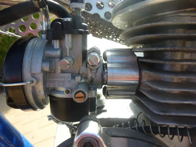

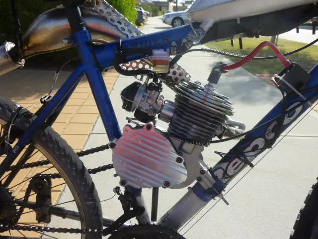

Nice build dude heres mine, i got the adjustable air fuel mixture screw, the choke is not needed on mine as it has something called a semi strangler starting system, you can also see it running along with the reed valves here : http://www.youtube.com/watch?v=tR4dqSf16xE
Wow! nice setup.. I need to get an intake like that I have like no space by the seat post tube.. where you get that intake? if you don't mind
That intake is actually reed valves what you see is just what the carb clamps on to Rock Solid Engines Australia supply them
