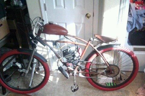

A little more about my setup and a pic
http://motorbicycling.com/attachment.php?attachmentid=45130&d=1329434669
