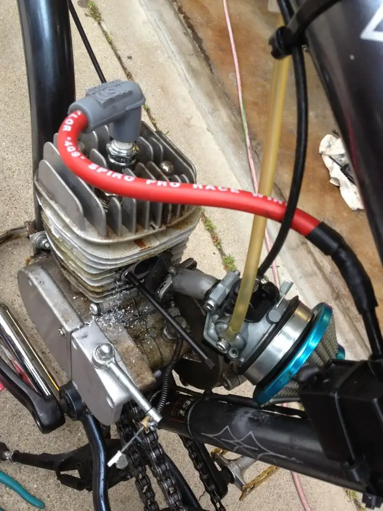

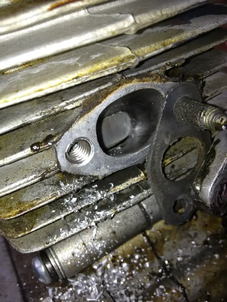

Have not updated in awhile because the threads came out of the head for my intake. Next project is install heli-coil.:-||

A new head is like $30. I've used helicoils on my jets ski with great success.

Come on surfishjoe! It took me an hour, including going to get the
Helicoil kit!
Just remember that you are working with soft metal, so go slow!

Robboy did you hand drill the hole and thread chase on the bike? I am getting ready to pull the motor off the bike to drill it but if I can do it on the bike that would be better? Thanks for the pics!
you need room to get the drill in,straight with the hole.i see there was some filings in the port.make sure piston is down all the way in the cylinder,better yet,tape the hole over so nothing gets in the engine.
if you cant drill the hole straight,its best to pull engine and put it on a bench.
