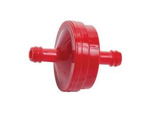

If the gas is eating your fuel filter, maybe try a different brand. It could be ethanol in the gas, too. Briggs And Stratton makes a lot of little red button-shaped lawnmower filters that work for gravity fed tanks, are cheap, and hold up to deathanol.
Also, be sure it is not touching the engine or vibrating against the frame to cause cracks.
The Briggs ones look like that and are marked for gravity fed carburetors/non fuel pump carbs.
