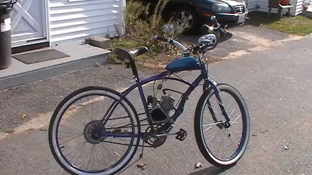

[QUOTEATTACH]61132[/ATTACH]
View attachment 61131[/QUOTE]
i HAD THE SAME EXACT cRANEBROOK HUFFY MAY i ASK WHY THE MOTOR IS SO HIGH UP ? i COULD UNDERSTAND IF YOU HAD THE PULL STARTED AS i DID BUT i GIT RID OF MINE DROPPED MOTOR DOWN WHERE IT WAS ALMOST LEVEL AND IT RAN SOOO MUCH BETTER
p.s. i CANT BELIEVE I just typed all this in caps
