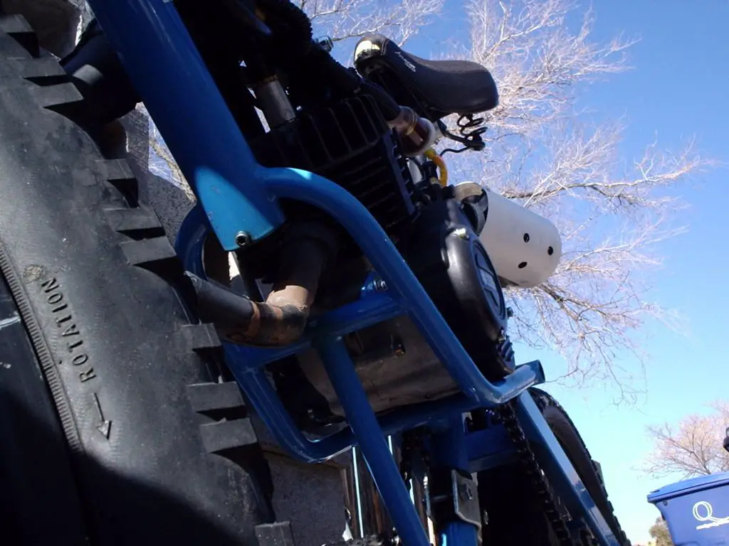

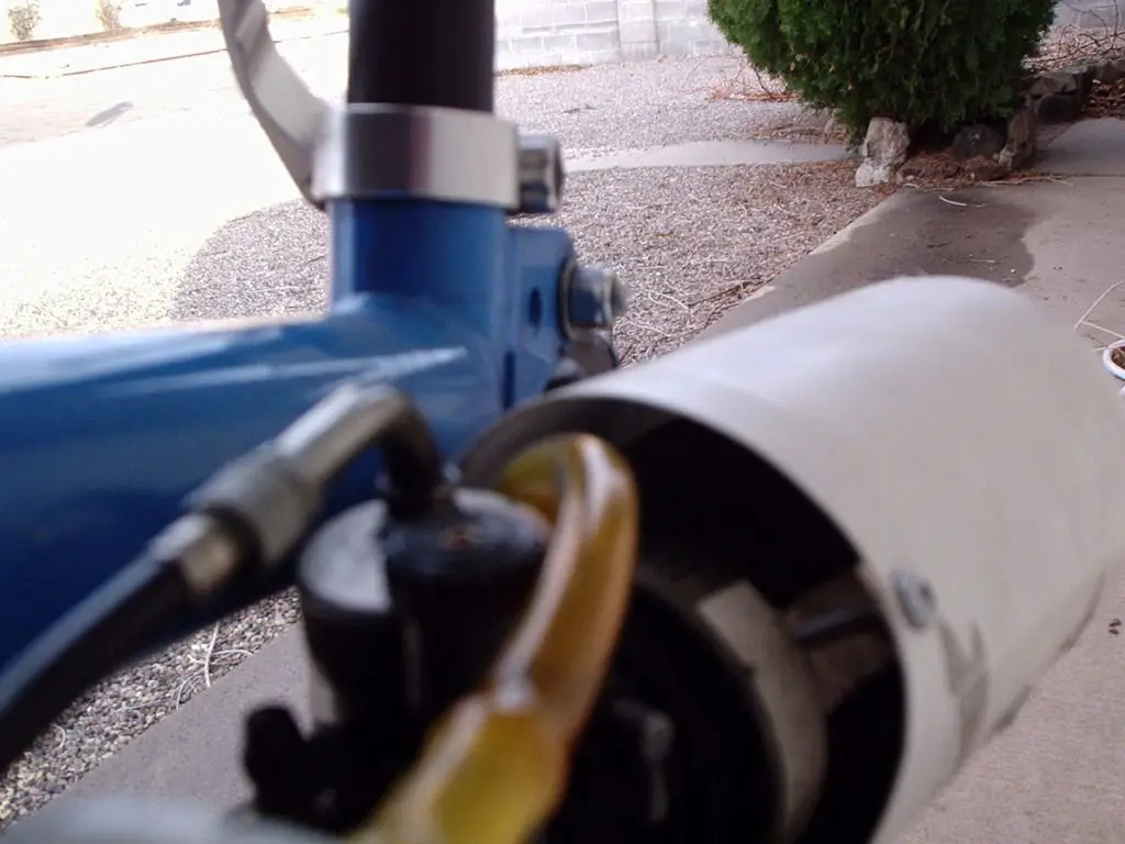

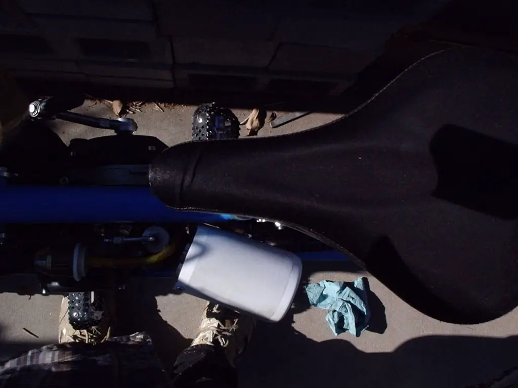

Been playing with a intake silencer. Ever since I got the bigger 21mm del on with the little plastic velocity shaped air filter attachment on it..it acted like a mega phone. The bigger carby lets a little more noise out too.. The exhaust is actually very quiet.. All the noise comes out the carby. It is not much just an experimental air box. My learning with this is that any restricted flow is backwards on performance.
I basically have a 12mm gap around the cover to where the box never touches the air filter at all. It now makes a deeper quieter tone. It is growing on me a bit and I will play with this a bit more. Here is my prototype. This little cover cut the noise back in half.
When I first started learning about this motor and the bigger PHBG carb..plus the freaky nasty dirt storms I had in the spring.. I used nylon stockings to cover the foam racing filter and whilst getting familiar I did not want to run the motor lean.. The nylon makes a great filter by itself but put over the foam filter made things coincidentally quiet.
Unfortunately any time air filter restriction is put on a two stroke you sacrifice power. This mod is very quiet and is just over the foam racing filter by it self containing the little sonic booms putting right me at H.T. noise level territory again, if even quieter.. Depends who's H.T. lol..
I used a Organic Vally brand yogurt bottle. Truly the only thing I have nonchalantly come across that is remotely close to the dimensions of the filter embodiment . The plastic from this bottle appears to be fuel resistant too. I also figure I can put a nice reflector on the back of something like this ..
I used a old drywall saw blade the handle was gone. This in turn is very resilient to vibrations and has spring steel to it, it holds memory of where it needs to sit very well. Just need cheap tungsten steel drill bits , a high speed drill. Then right when the drill bit turns cherry red the hole gets drilled through lol. Drill bits don't like spring steel.

I put a new intake silencer on tonight . Nothing all that special. Except I made it about 15mm longer. Then ran it up closer to the carb body intake up pretty flush. Put a little bigger gap at the back of the cut bottle spacing to the gap on the back of the foam air filter. Made the Whole cover longer. Last no holes in the side walls on the plastic bottle body or underneath like my first one. Just a solid sheath with a nice gap to the back.
Same plastic yogurt bottle. http://www.organicvalley.coop/products/yogurt/plain/ It offers a nice air gap around the entire foam racing filter!
Darn thing has a way deeper tone to it like a Thumper motor. Kinda its a way deeper tone than stock with the higher revving of a Morini course.. Sounds wicked! :) It is even more quiet than before!! All the noise has been coming from the carb side on this bike.
This silencer gismo is awesome. The bike is too quiet now. ''think getting the proper attention of cars in traffic'' The noise it is very peaceful. Can totally hear the little nuances in the machine now for the most part.
My first one cant tell from the pictures that were posted but I put a long open slit underneath and had drill some holes as well. This one is liken to the first one, but no holes any where save slipping it over the air filter. Tried the new one and it is not air restrictive at all. Just muffles the sound very well!
