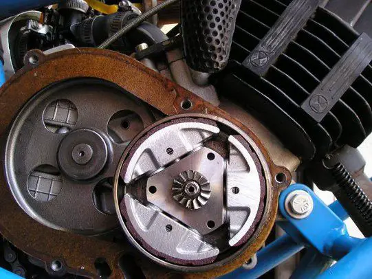

Goat, the 3 shoe is a good clutch to have and I do miss the slight slip off the line. The new disk clutch doesn't slip and the engagement was consistant even after 12 hard laps.
The only reason I got the clutch was my 3 shoe delamanated 1/2 a shoe.
do you guy's use a reed stuffer? and can i use a 3 shoe in my 2 shoe drum? thanks dennis [mag. your bike haul's''A'']
The shape/length of the intake pipe that came with my Boxer might be doing that for me dunno? I order the performance package to go with the S6S then went to the 21mm carb. Never tried a reed stuffer on my Morini's. This intake being a tad longer helps the low end on my currant machine nice I think. As it has always pulled hard from a stop. Likely gonna do the same with my L/C motors next as I bought the same manifold for them and the next BoXer build up..
I think it compliments my pipe coming on like it does.
The last few days with a new plug has totally cleared up my prob's. I set my carb back to about how rich I had it before , and cleared up my D.H. http://www.motoredbikes.com/showthread.php?t=4394&page=5
Yeah you can get a Three shoe clutch stuffed into a Two shoe bell, but the two shoe bell is narrower in width so part of your shoes will be hanging out the outside
edge. Something like mebbe 1/8 inch more minus than plus if I remember right? The two shoe bell has the same inside diameter just narrower. Never ran that combo for very long. It was working good tho.
I tried it briefly with the first grippa I bought and got the right bell as soon as I had the money. Last I wanted my two shoe bell to be left alone to match up with the cherry two shoe clutch which I still have not used.. Holding on to it for a rainy day.
