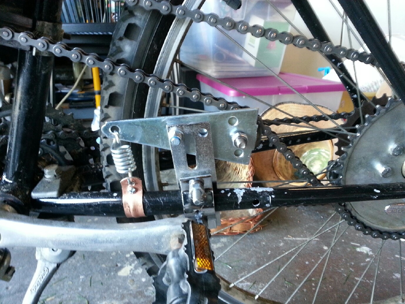

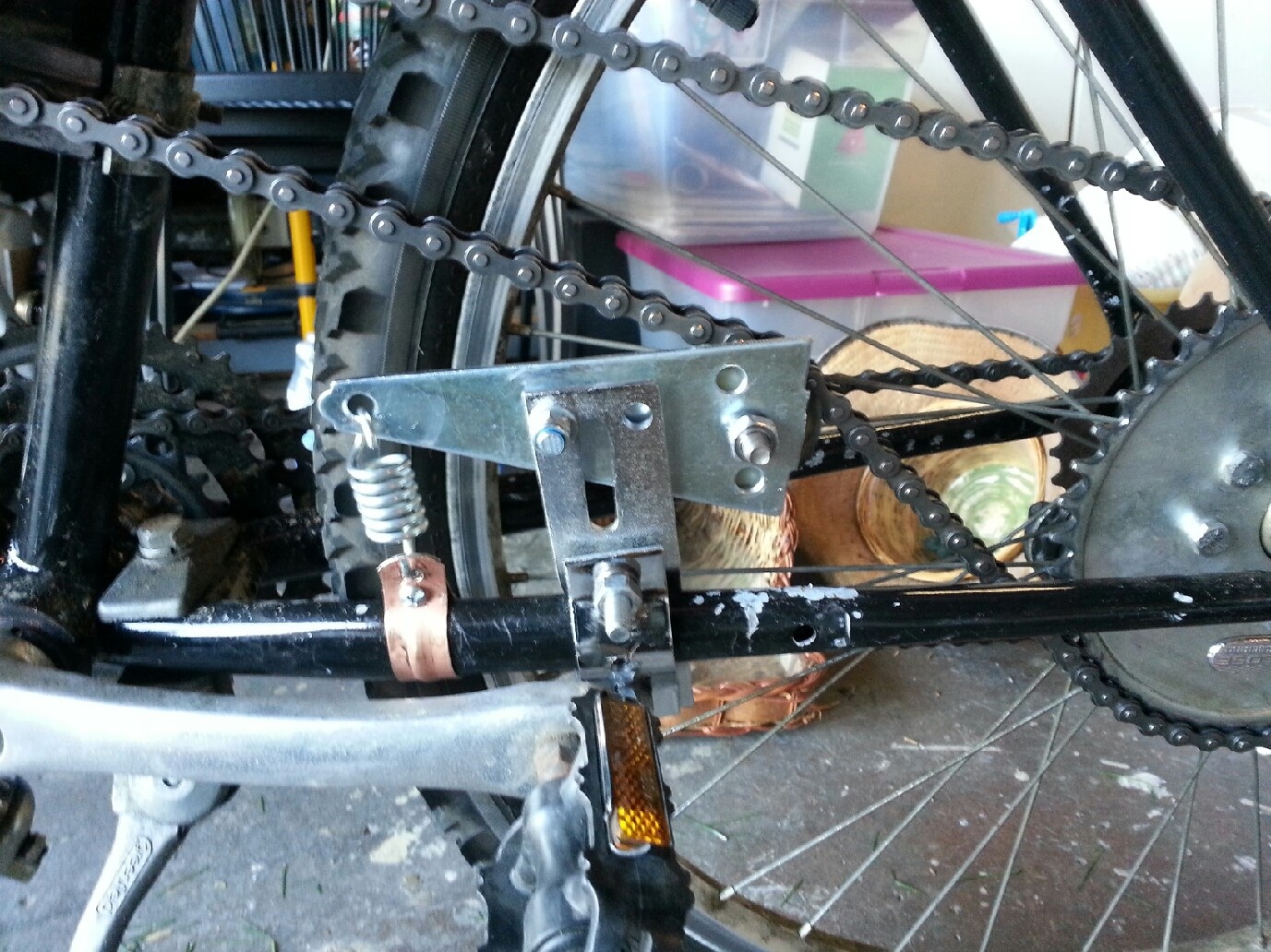

If I figured this out there should be a pic of the Frankenstein tensioner. It worked. Only I didn't have that much gas
Venders charge a lot of cash for that same design. Good job bro, Glad it worked out for you.

I just noticed, It's a cut off door hinge. THAT'S GREAT.

The spring...whats the specs on it...I've been searching for a sturdy enough spring...and that tensioner looks awesome...great job...
Thanks for the complement.
I just threw the packaging away last night too. I do believe that the spring is .105 gauge and 1 3/4 inch. Not sure on the weight it needs but it took two people to get it on. Some of the other springs were too long so it took a few trips to the hardware store to get it figured out.
