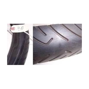

Could just be a defect. See if you can get a discount or your money back. With brand new tread they shouldn't take it for JRA, like if you wore them out and then said you wanted a new one.

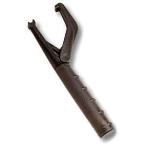

and THIS last one is REALLY neato looking!
Kool-Stop Tire Bead Jack
I think if i had the bucks, I'd buy 'em all, all at one time!

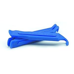

Those blue ones are the ones I broke.:( They were fine for others tires, yet with those tires I could almost use my bare hands. Thanks for the links guy's! Gonna do some studying. That kool stop looks interesting Happy.. When I come up with the approach and technique that makes sense enough to share. I will definitely share it! I don't give up easy ever. Too many years as a auto tech etc.

Please don't take this as mockery at all, but this link might help you with the tight tires (park tool instruction pages). I used to do a lot of road biking and some road tires seem terribly tight, but this almost always worked.
http://www.parktool.com/blog/repair-help/tire-and-inner-tube-replacement
These ($5 shipped) will get any tire off, one way or another! You might need to grind them a little to prevent scratching your rims, but they do not bend! http://www.google.com/products/cata...&sa=X&ei=ezNMT-TzH4eusAKY0YwF&ved=0CF8Q8wIwAg

Hey those TL5's look pretty kewl I think I will get a couple of sets one for my compadre as well. 8 inch long is decent leverage. I wounder if they will bend? There directions there is pretty much how I do it. Except for my ho-made levers were a little too thick.
Just notice after googling...They say Heavy Duty ''''Forged Steel'''' !!! Not like a cheap tool where the only thing forged on it is the namelaff
Me like !!! Ideally I want to prolly have three tho.. Thanks!:)(^)
