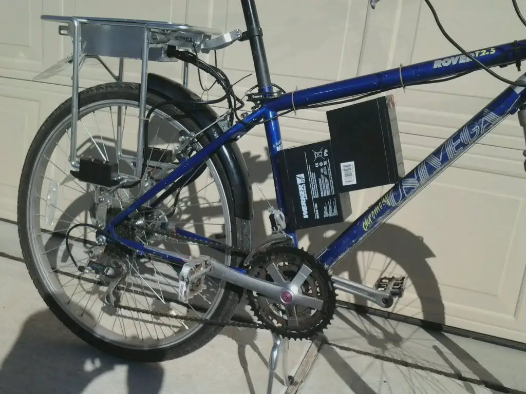

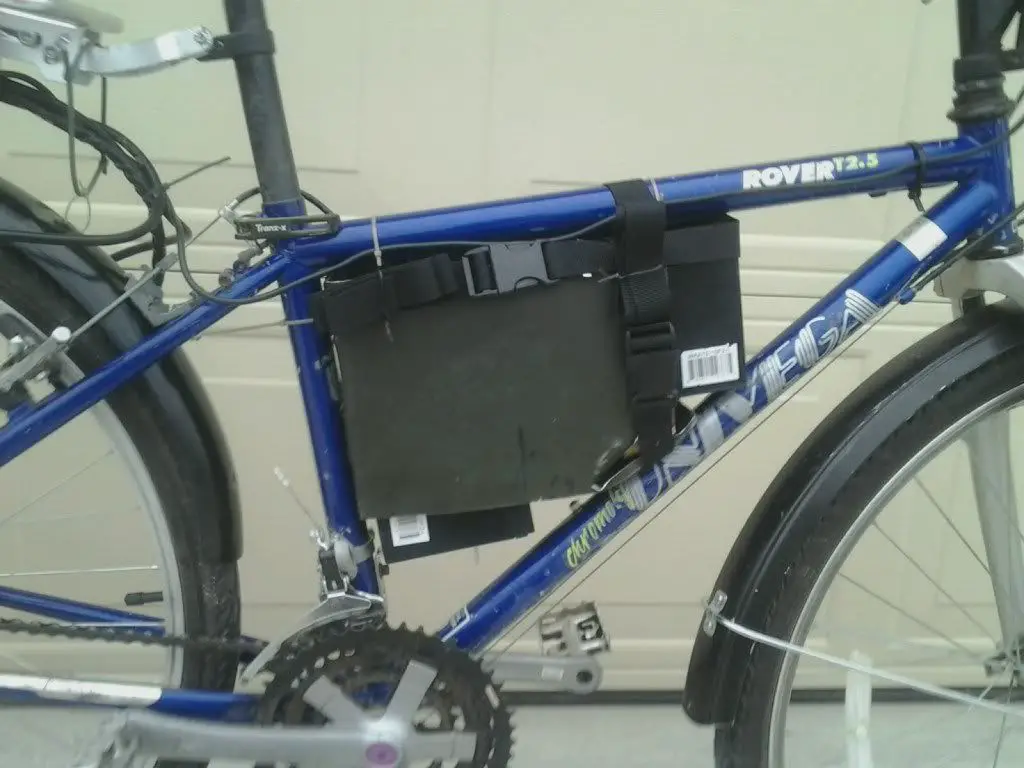

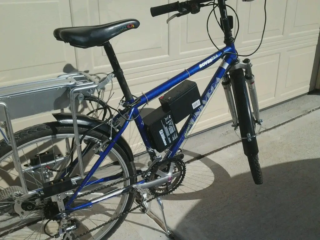

Moving my two SLA batteries from the rear rack to the frame triangle and it is a very tight fit. My battery box will be a trimmed 7.62mm ammo can.
I can mount the batteries parallel or in an L shape as shown in the pics. Any thoughts on which will work better? It's going to be a PITA either way. I need to be able to remove them easily at my office for charging.

My battery box is more of a battery rack now. Two bottle mount bolts support the bottom and it is tethered to the seat tube with a zip tie. Two sleeping bag straps have been added to to support the front and prevent the front battery from absconding.
Once I repair the wiring harness, I'll be ready to ride again. I'll paint the box when the weather warms up a bit.
