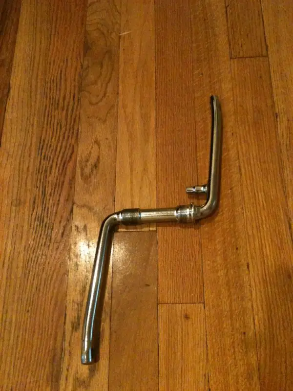

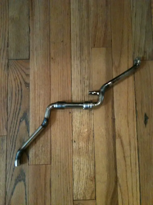

i'm looking for a wider pedal system with a pretty small front sprocket. i can't find out where to get one. does anyone have any suggestions?
You could have a machine shop make you a crank for a 3 piece setup, give them a regular one and have them cut off the tapered part and extend it. Idk if they would charge too much to make it worthwhile. I think a couple of vendors that sponsor this site sell a one piece wide crank. Ask a bike shop where to find a really wide crank, don't mention that it will go on a motor bike.

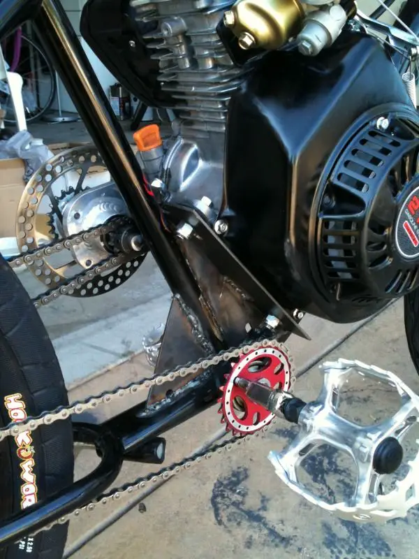

yesterday i ordered a 25t sprocket so i would have more room to mount the engine. i also bend my stock 1 piece crank to make room for the engine. used a torch and bent them in a vise. i did a pretty good job. don't think it will wobble at all. maybe 1 side...
thanks for your advise Jeff.

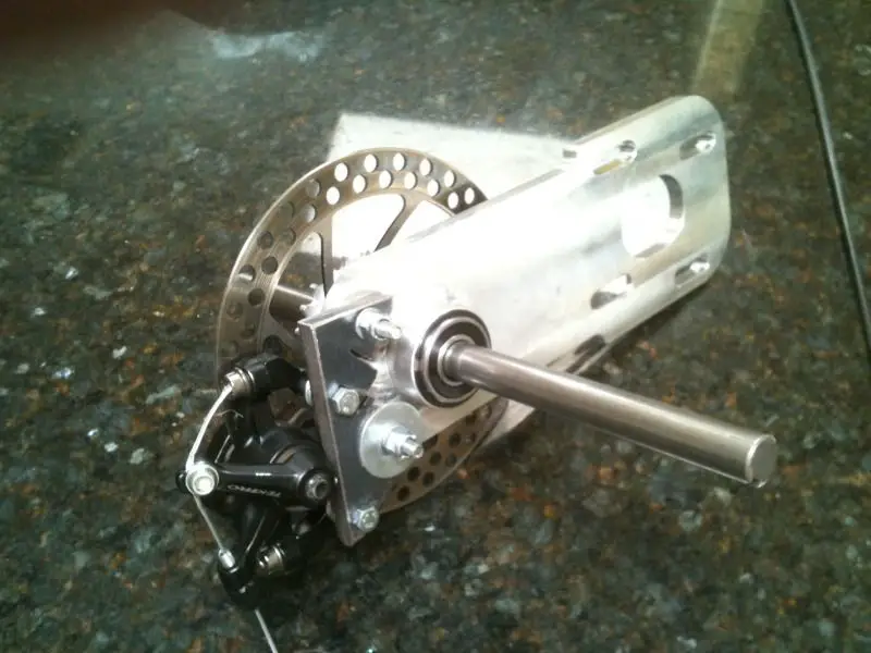

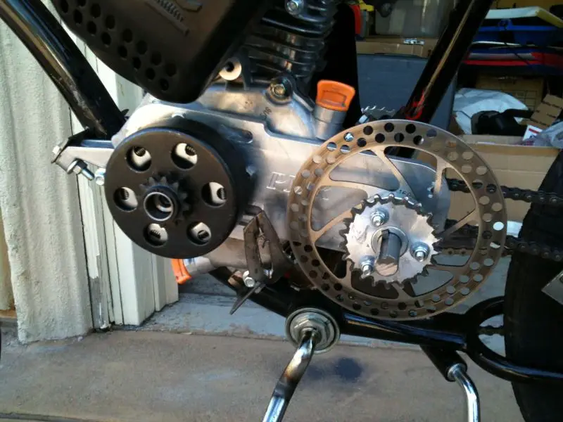

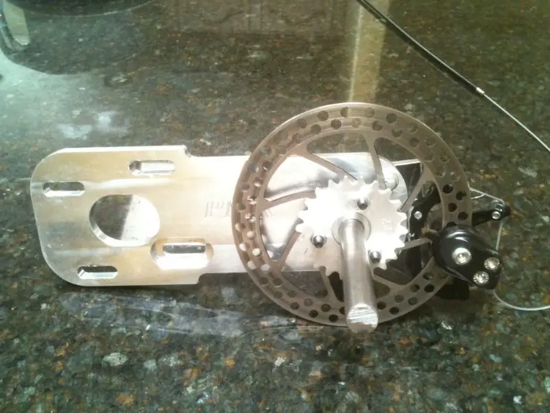

also decided to just buy a jack shaft setup. diden't like my original idea.

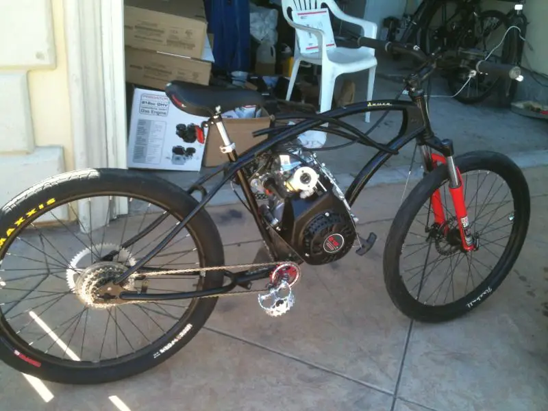

before:
and after:
i'm almost done. just have to figure out a gas tank, cut my chains to size, do some final welding, make an exhaust, and solve all the problems that i'll have in the future.

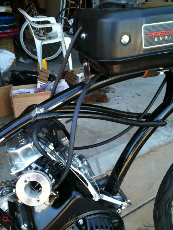

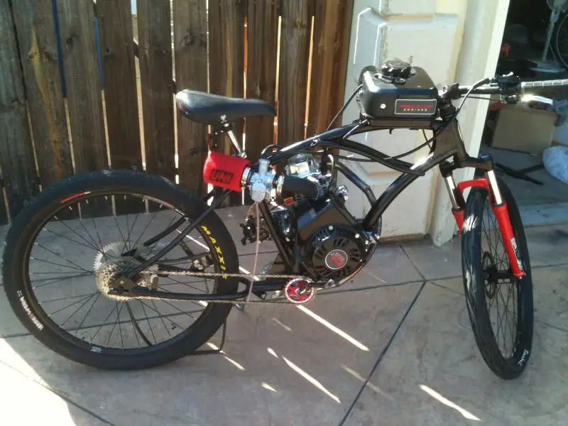

got a temporary gas tank on the bike. i'm planning on something that's better looking but i just want to ride this bike now. let me know if you have any suggestions on a gas tank.
also welded the frame support back. i made it a bit higher so i can remove the valve cover without having to remove the engine.

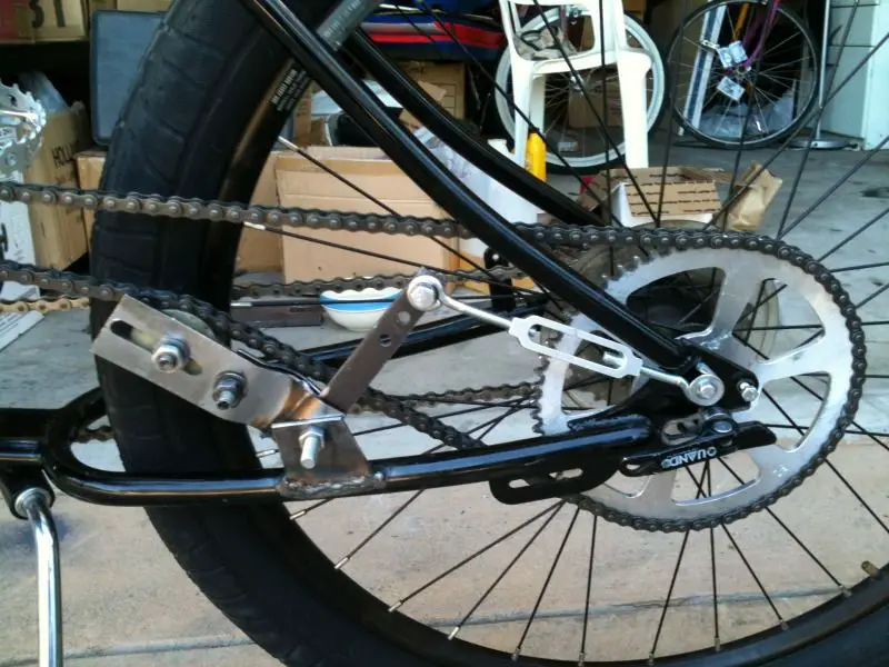

all the chains line up.

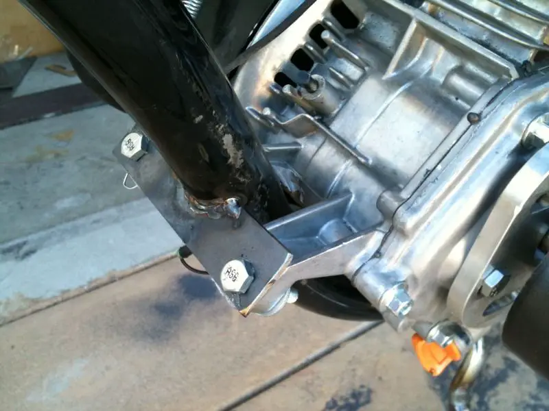

look at the engine mount i made for the front of the engine. those mounting tabs use to hold the gas tank. this engine is not moving anywhere unless the frame goes with it!

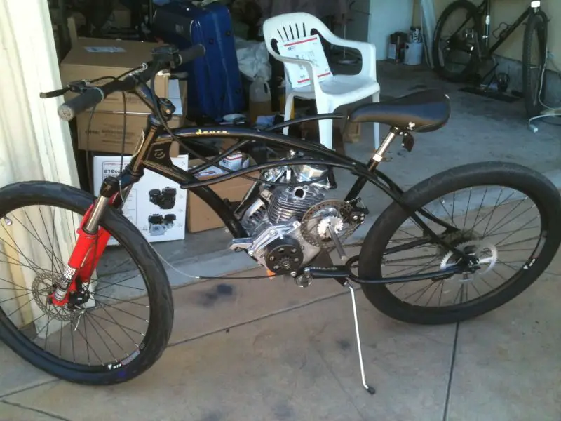

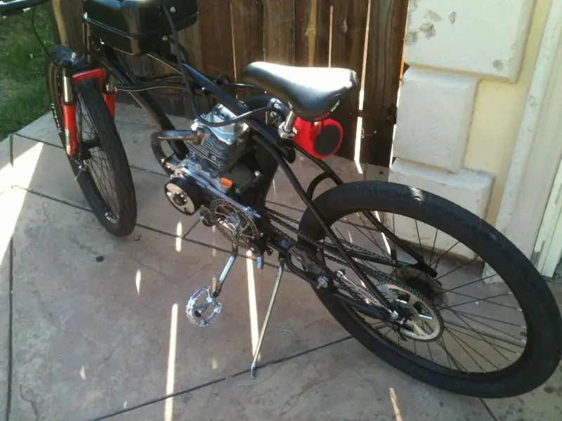

i got it started and rode it around the block a few times. it rides really nice, and feels like it can take some fast turns.
i'm still waiting for my 22mm mikuni carb and adapter, and for my 1 inch exhaust. either than that the bike is done!
i'm hoping to make it to the race on the 15th. well see...

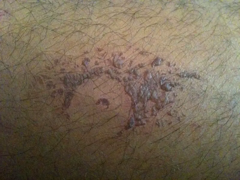

this temporary exhaust burnt my leg yesterday. if you look closley you can see the philips screw imprinted on my leg.

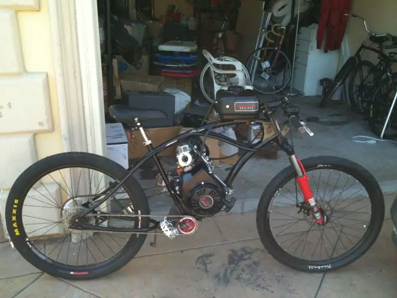

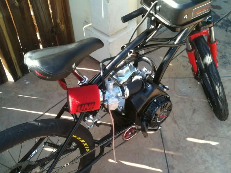

ok i finished the bike today! took it for a test drive. WOW it's fast. very stable and predicable handling. no vibrations at all. it is a blast to ride.
i do have one pretty big problem with the 22mm mikuni carburetor i got from agk. i installed it and it started perfectly on the first try. but it idles at way to high rpm. the clutch engages as soon as the engine starts. i have tried adjusting the two screws on the carb but they don't change the idle at all.
i know scotto and ccc have these carbs on their bikes. what do you think i need to do to get the idle much lower?

The problem is the slide is not seating all the way due to the outer cable sleeve. You are going to have to trim 1/8 to 3/16 off of it. This will make the cable longer to close the slide. You can do this with a dremal and small cut off wheel.
The idle adjustment screw is the one on the right hand side of the carb.....turn it counter clockwise. You might check your throttle cable as it could be hung up on the ferrule at the grip ;)

thanks guys! i found out the problem. the lead piece of metal on the end of my throttle cable was to big. it protruded out past the end of the slide. so it wouldn't go down all the way down, but felt like it did. fixed that by grinding the lead piece smaller.
