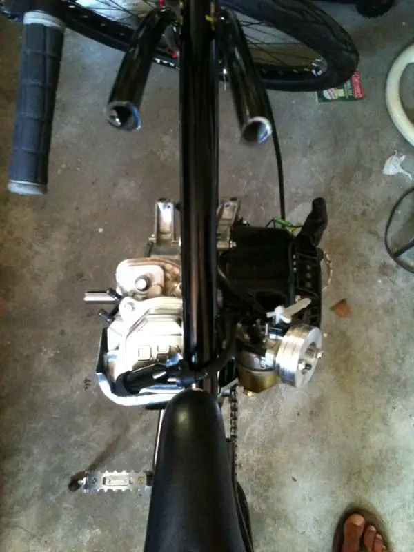

anyway, update for today (so far):
i think i found the best way to mount the engine. do you guys think he angle is to extreme? will the engine be able to self lubricate itself in this position?
i could mount the engine in 2 different way's which is better??? i want to make sure the engine will stay lubricated.
That looks good as far as mounting it, what does look bad is you cut up such a nice frame. To each his own... you have two people on this site that have made that motor fit into that frame with no modifications to the frame...Please look over their builds...it will truly help...laff
really??? i tried every way and couldn't find a way to make it fit without cutting the frame. i sat there for 10 minuets thinking to myself before i started cutting. who has done it? could you send me the link? i can't find it.
he can't be using the same dyno frame as me.
so i would just have to fill the oil level to the point where the plastic gear is partially submerged in oil correct?
o, i didn't think i could mount the engine vertically because the oil would not flow correctly. i know it would fit that way, just thought that was not even an option. dam i feel sooooo stupid now.
Mount the engine in which way it would be easiest to remove the valve cover if needed, just my opinion.
To give you more room to work with you may also want to remove the cranks and put those aside since you would need to put on wide cranks. Or you can bend those 1 piece cranks to make them wider.
Just in case you want to check the valve lash every so often, or on a situation like mine to see what the heck happened to the pushrods, I bent a valve and pushrod because the valve lash was set incorrect.
maybe use a 24 inch rear because the cylinder should be tilted back for lubrication due to the angle of the oil scoop on the connecting rod. attach a clear hose to the oil drain to see the oil level in relation to the output shaft, and make sure it is at the same level when you fill it up in the mount position you want.
yeah i'm just going to fill it up until the cam gear and some of the connecting rod is submerged. i'll measure how much oil it took and that's how much i'll put every time.

i'll probably just mount it like this bike. i'll be sure to make it so that the valve cover can come off easily.
The only way that valve cover is gonna be removed easily is with the engine removed from the frame........trust me.
