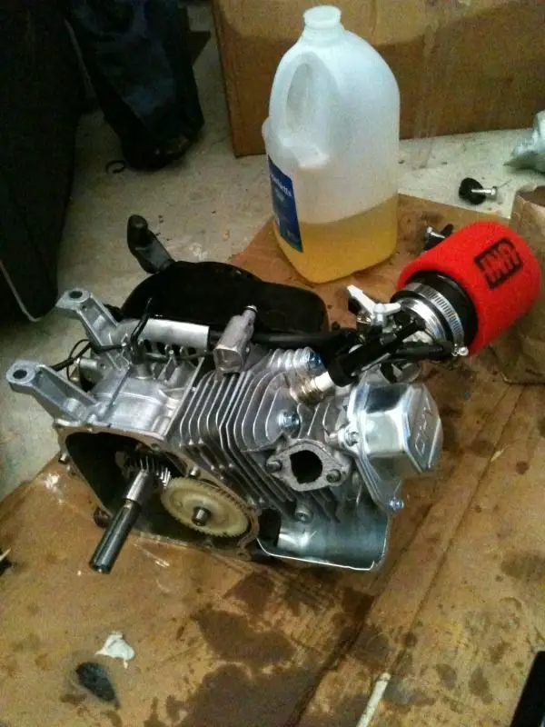

I'm gonna make a j shaft with a go cart front wheel hub, get them for $20 on eBay and lotsa colors to choose from. All it needs is to be bolted up to a plate. Gaaahhh, off with the covers! We wanna see your nude engine! Lol. I took the pull start off my 99, I will make a low-profile pulley to put on the flywheel so I can use a string to start it, even though I am making a manual clutch so I can bump start. You don't need the blower with a bike as long as you're moving. The pull starts make motor bikes look like goofy mini-bikes, not like a motorcycle. You can mod the engine while waiting for parts, start with a thin copper head gasket. Anneal the copper sheet first by bringing it up to red heat, it relieves stresses from rolling and makes for a better seal. That will bring up compression.
The copper head gasket will anneal itself after the first run with initial torque down, then re-torque it for proper seal. Re-check the valve lash while you're at it, the valve cover is already removed ;)

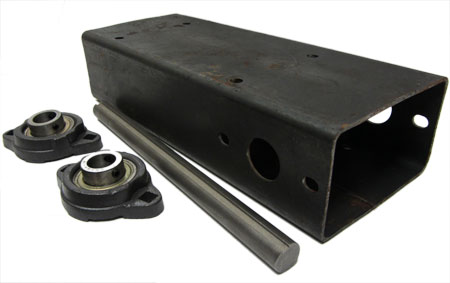

ok here is my jack shaft idea!!!! i ordered this motor mount /jack shaft.
http://motorbicycling.com/attachment.php?attachmentid=50409&stc=1&d=1343663529
i plan on cutting off the whole motor mount part and using the jack shaft part for my bike. but i'm going to leave one side of the motor mount so i can bolt it up to the side bolt holes next to the output shaft of my engine. then it should look and work the same way as $135 jack shaft works from AGK .once i get it i'll post some pics. total cost was $85. and i think it would be pretty heavy duty and look great in red.

i'm cutting the whole engine mounting part off except for the left side part. i will use the left side part to mount to the engine's side in back of the clutch. the whole piece is 12 inches long so it should easily move the jack shaft away from the engine. hopefully it will work. it's in the mail now.

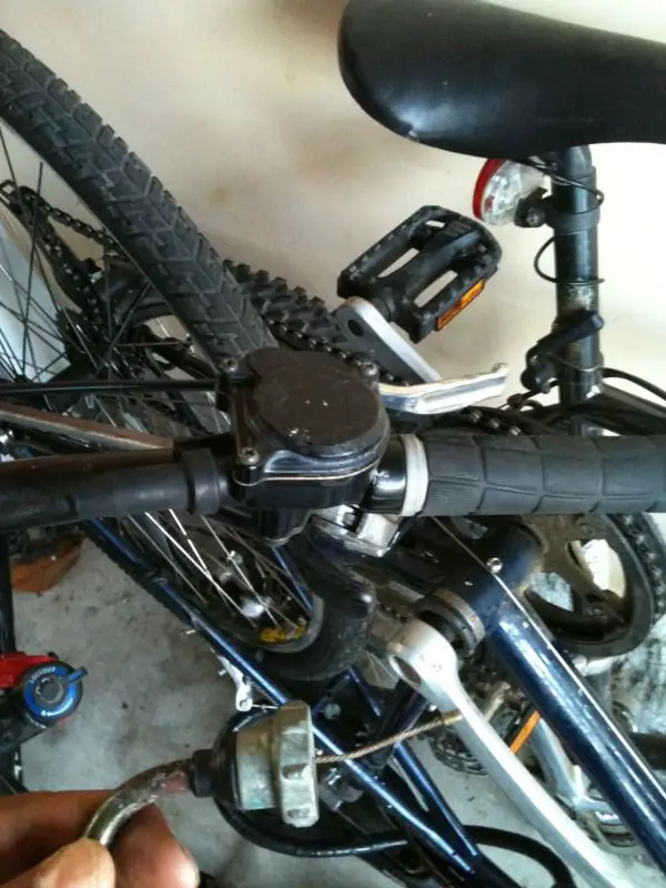

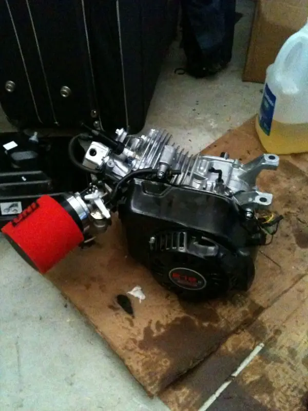

anyway i got some minor work done today. new thumb thrortle (i dont like twist thottle), new bear claw pedals, took the govenor out, installed air filter and made the engine naked!
