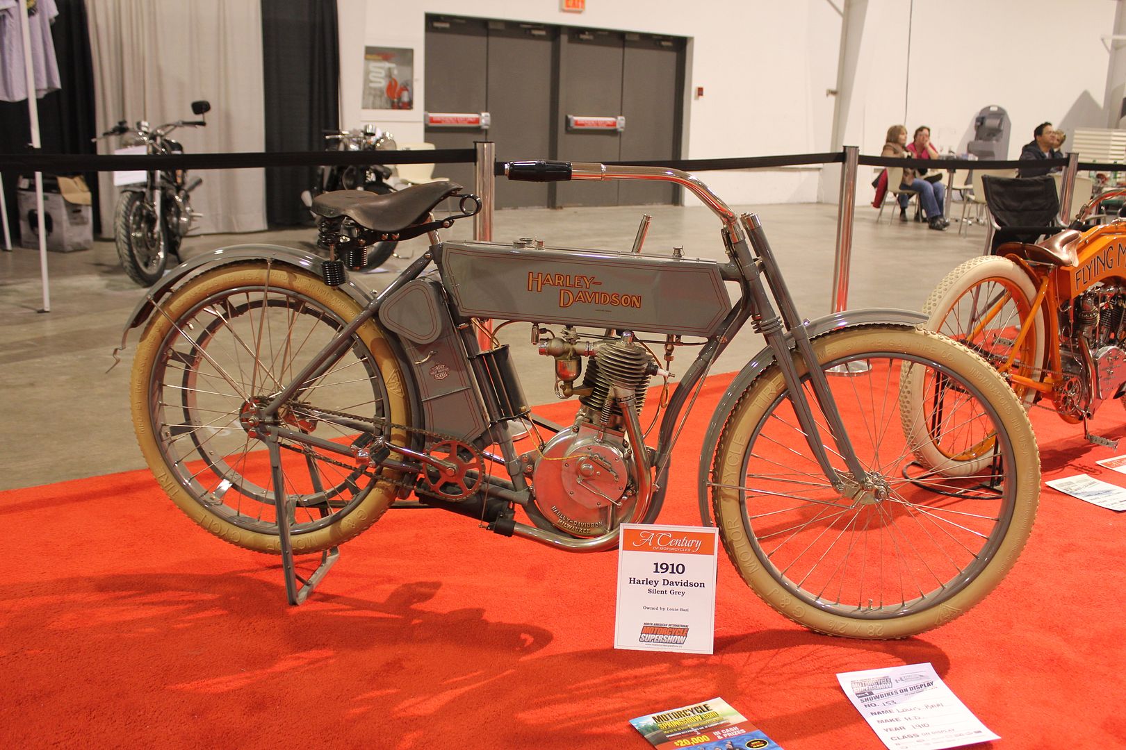

For some reason your bike reminds me of the Harley-Davidson Silent grey fellow.
Different and yet period correct.

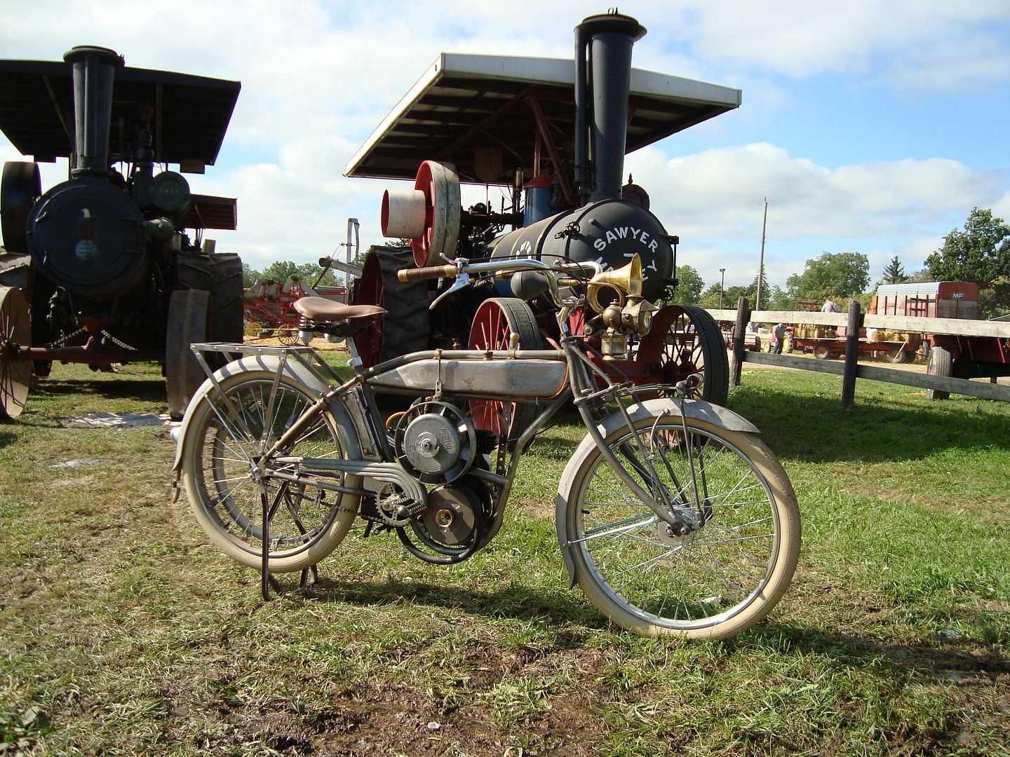

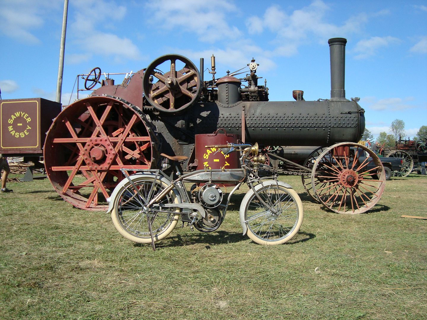

I took it down the block to a Steam Era agricultural fair in my town this weekend. Got lots of comments when I stopped riding, but mostly just rode in, rode around the event for awhile then home again. Once or twice a day for four days. Saw stuff like this.

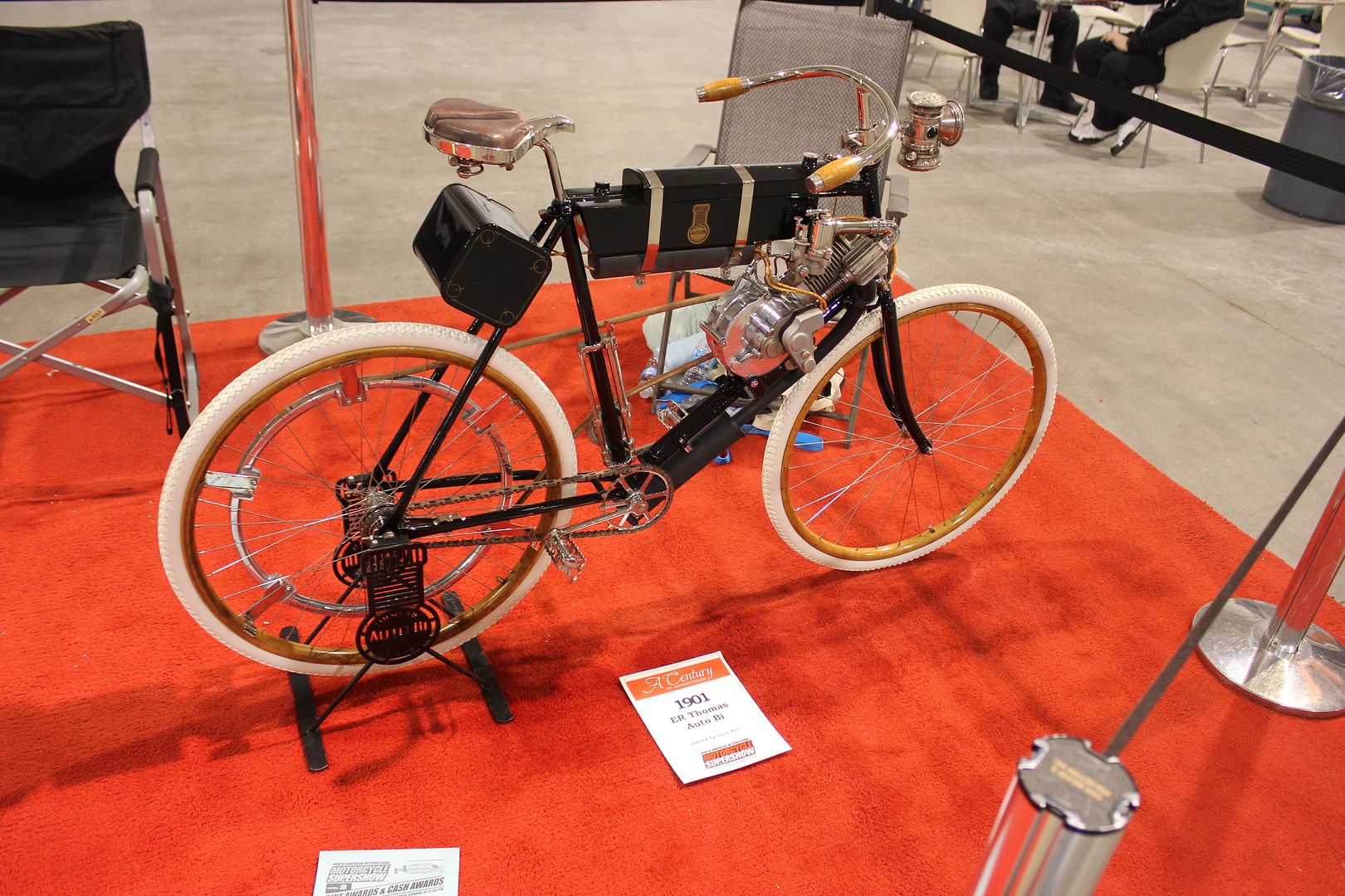

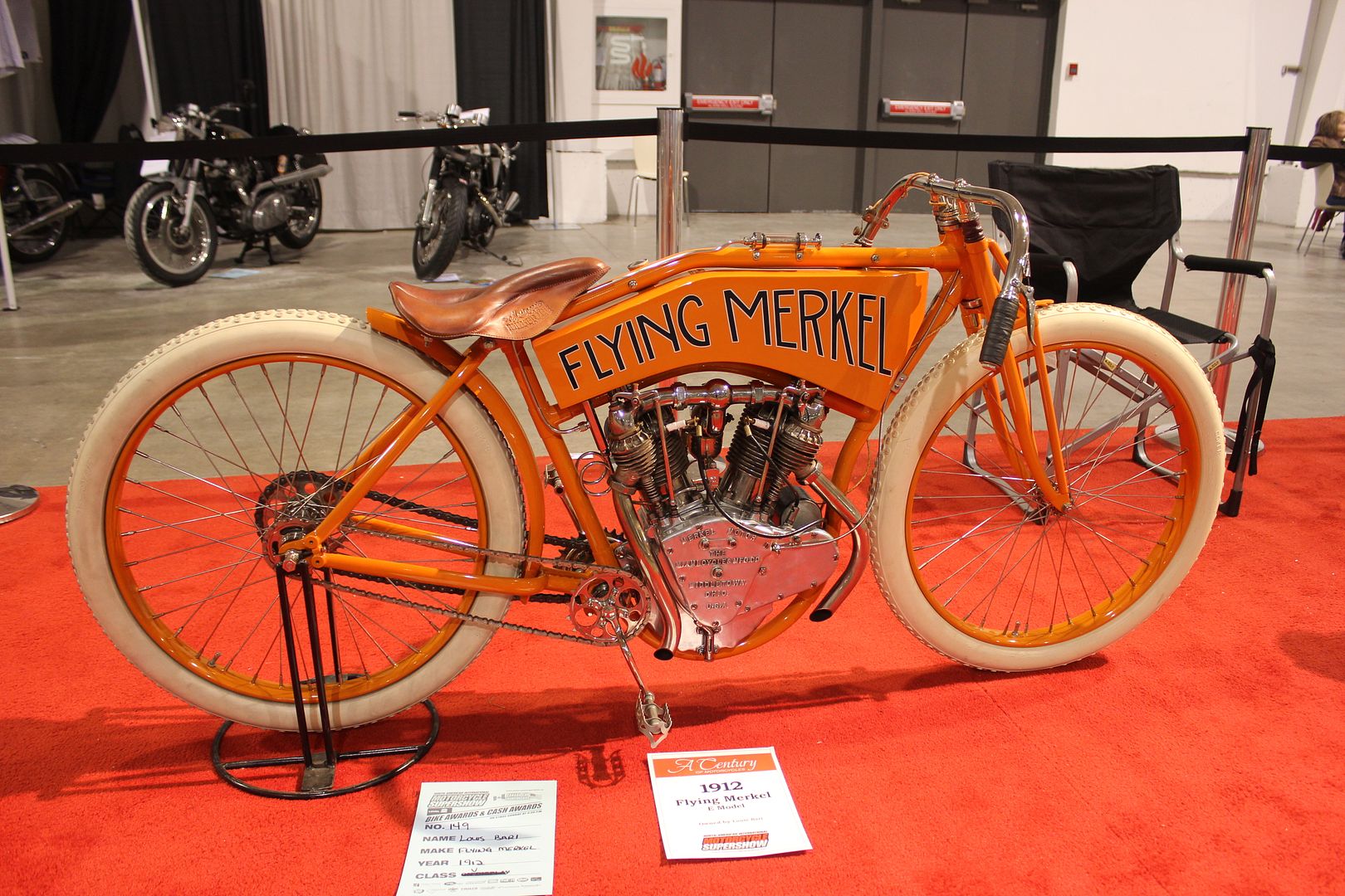

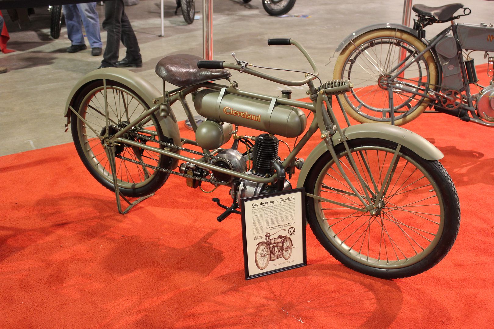

Here is some of the real vintage stuff
