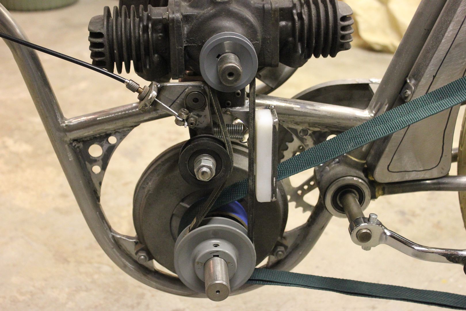

I see a pulley on the engine now, are you going to have a belt(s), jackshaft, and for a rear wheel drive a whizzer or washing machine pulley on the rim or spokes?
I used a type of belt that has links to add and remove to change length. Recently I felt that it slipped badly and links came apart when tightened a lot.
Now I am going to try either a regular vee-belt or another link type belt I just got, it is the Power Twist Plus instead of Accu-Link. Power Twist Plus seems way more rigid and should not stretch nearly as much and hold up I hope. Power Twist Plus notes that pulleys smaller than 3 inch diameter should not be used, which is why I’ll probably use at least one regular belt for a 2 inch pulley I am using.

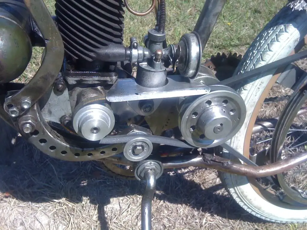

I will be going with a belt primary drive and a chain secondary drive. I will also use something like in these two picture for my clutch setup.
