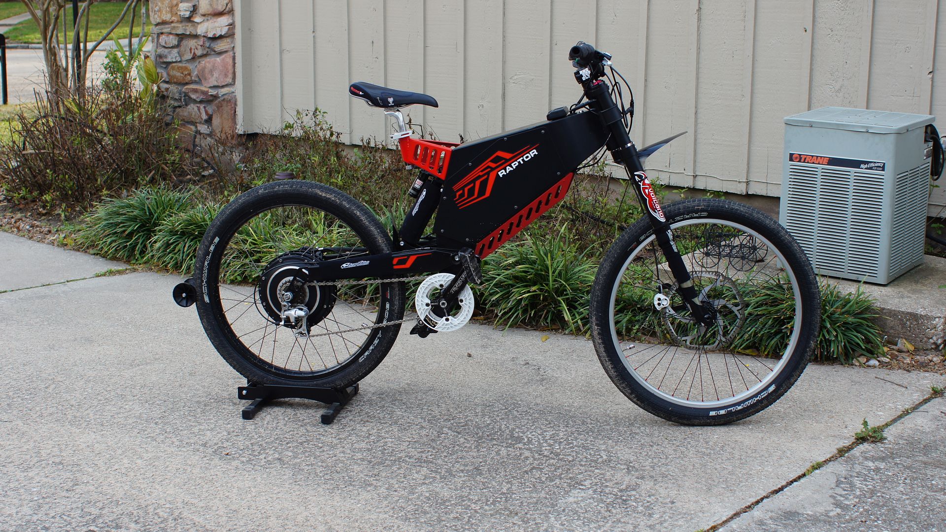

53mph Raptor Build

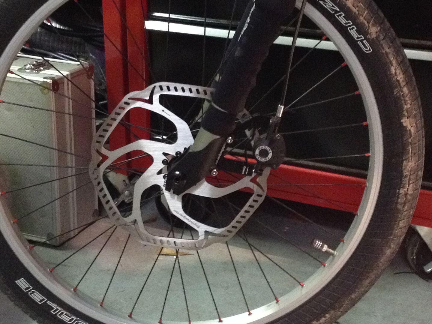

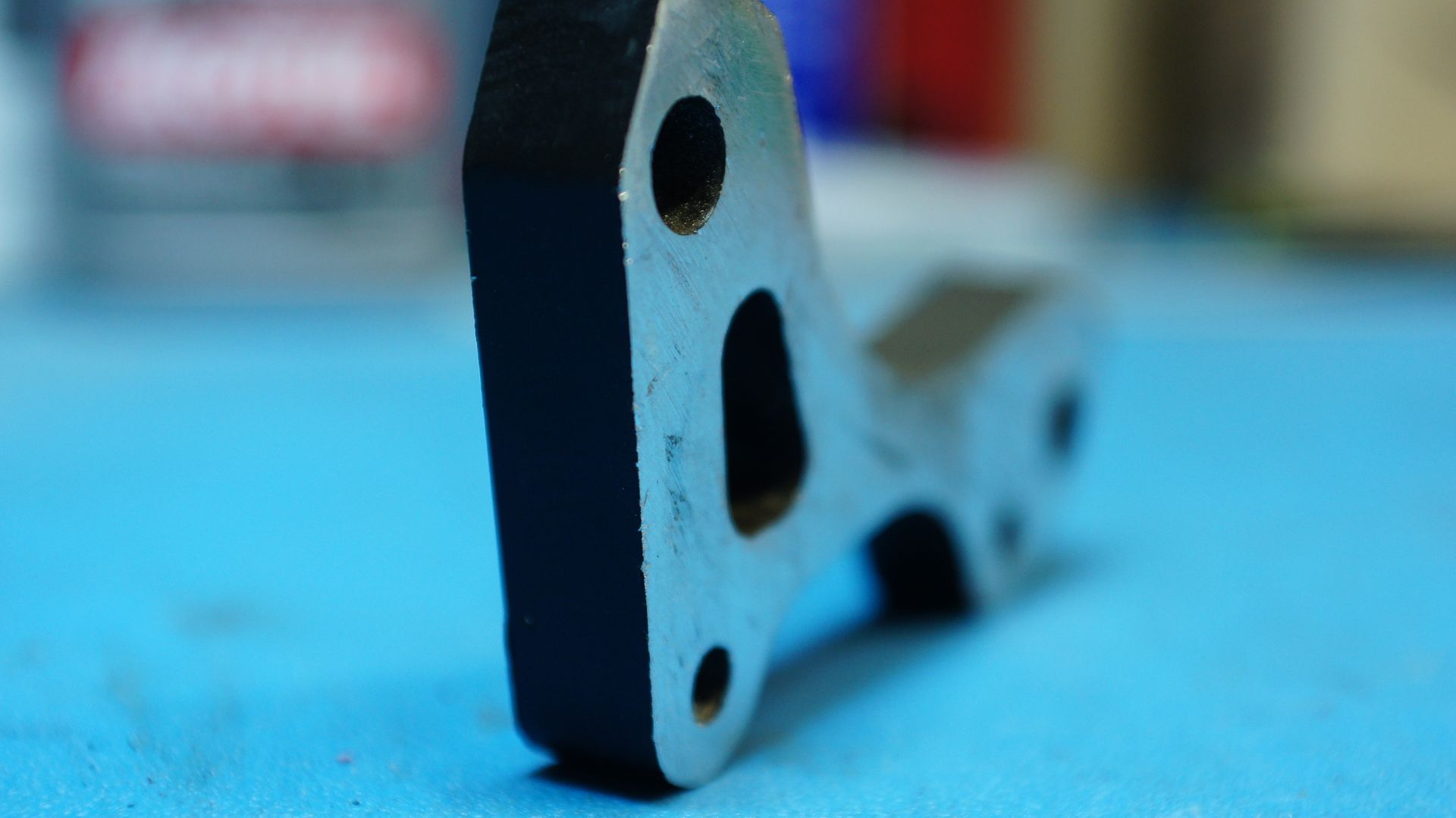

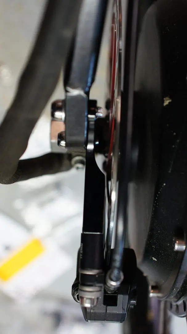

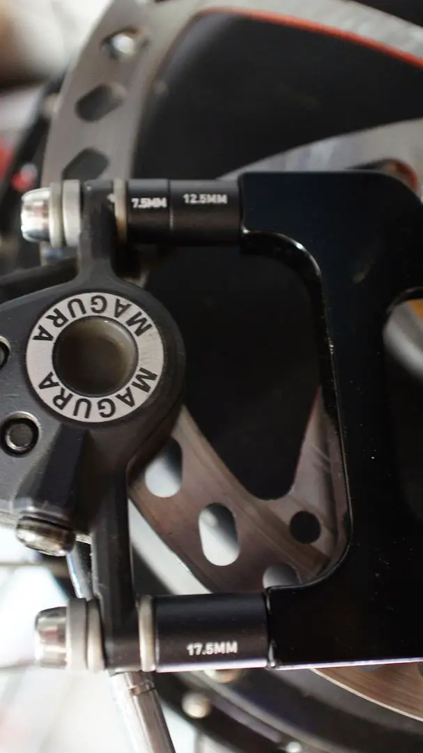

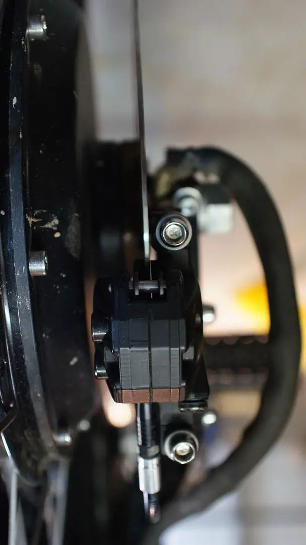

Well, I broke my front caliper. The brake caliper broke by the screw mouthing holes. I ordered a new brake and some other adapters to take the side stress off. I'll see how well it does before spending money on some better brakes.

That's a great bike you built. I think I remember reading about those frames on es. They're said to be hard to get. The swingarm resembles the one on HPC Revolution bike, and the way the BB fits on the fame looks similar. The frame kind of looks like my Stealth too.
I wish I knew half as much as you about controllers, and battery's. My bike has a CA3 also.

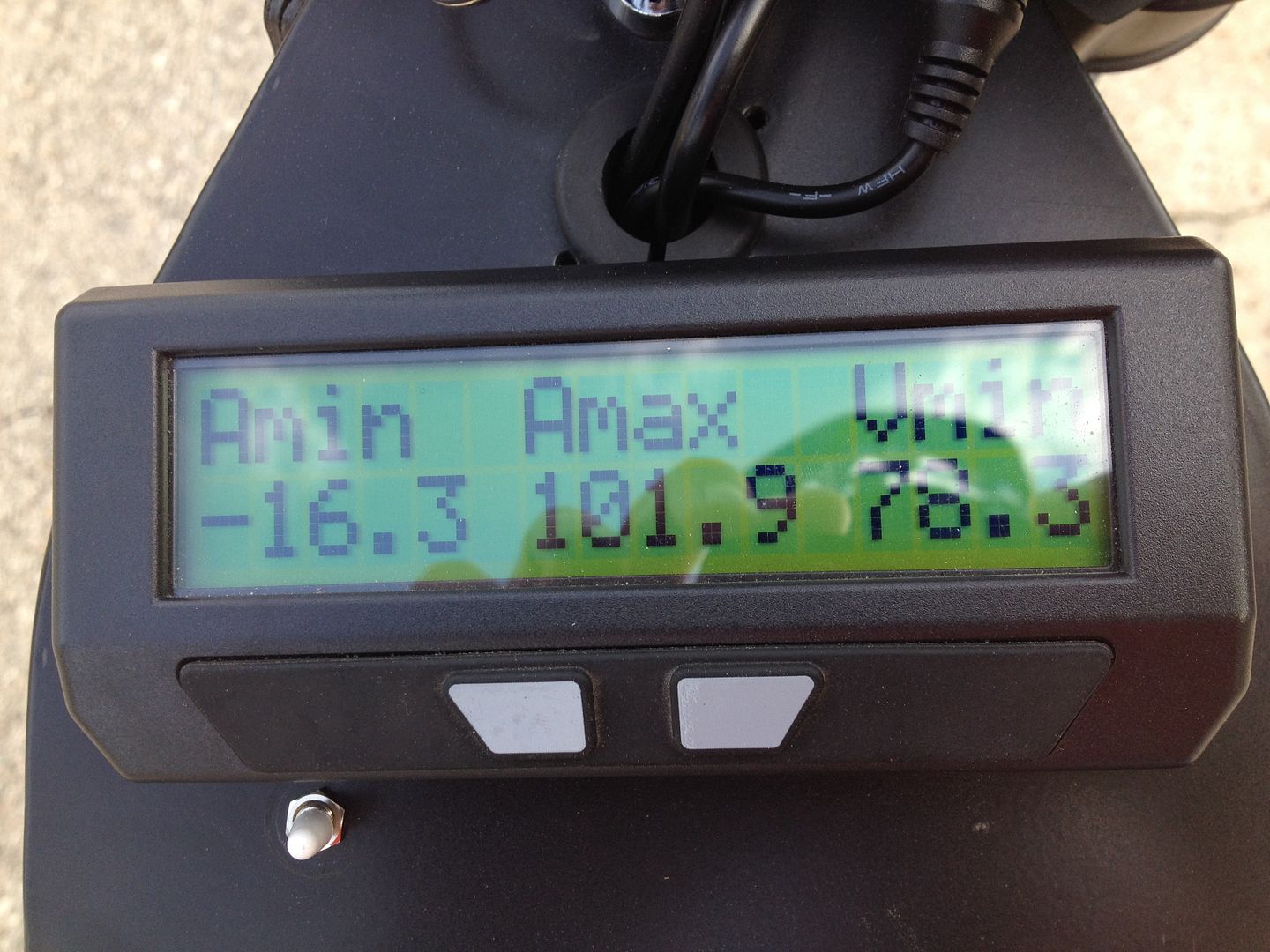

I reprogrammed the controller and got some more torque. Seems a bit too much for my taste, so I'll drop it down a notch. I also reconfigured my little white toggle switch to be a current limiter vs a power limiter. The current limiter is smoother in behaviour.

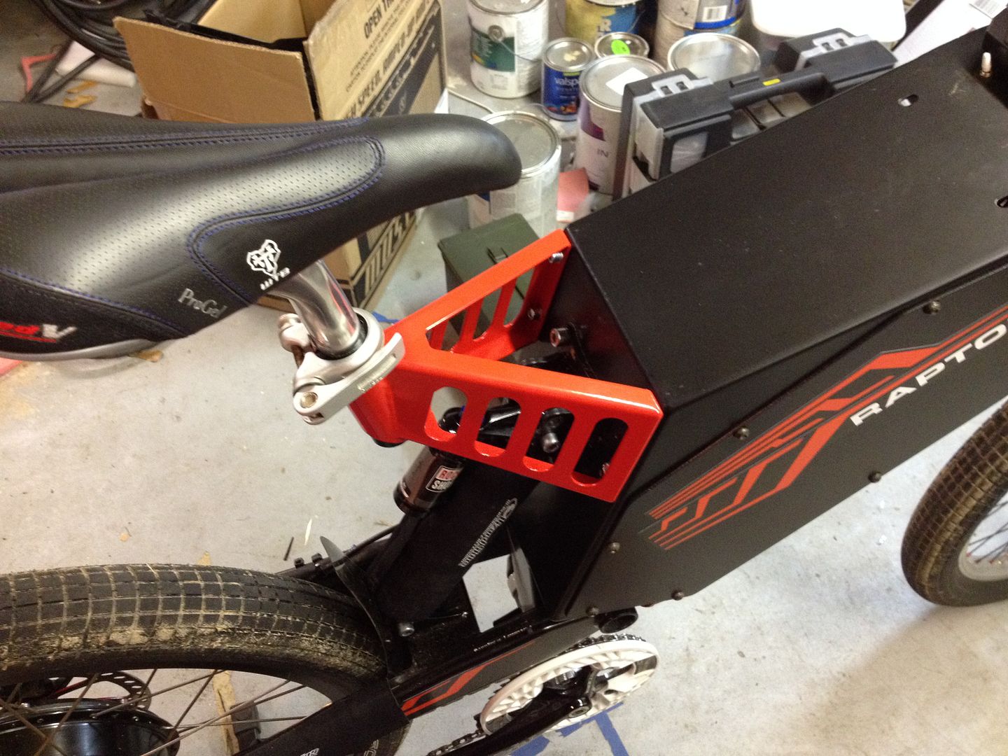

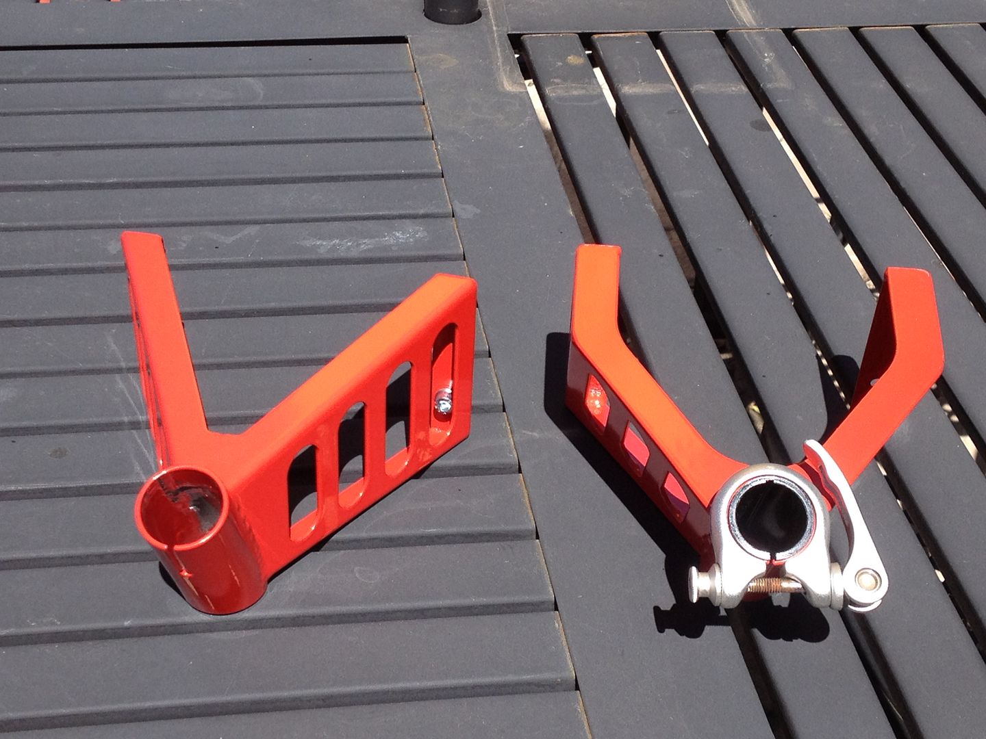

I did get me the new bicycle seat assembly. The new version is made for short peeps like me. My inner thighs don't rub on the assembly anymore. It also lays a bit lower vs the old one.
The new one is on the left

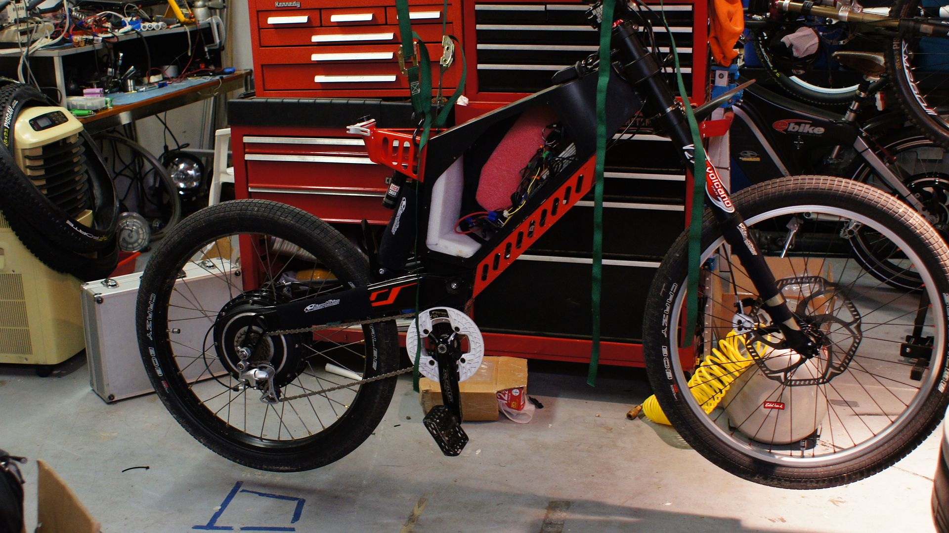

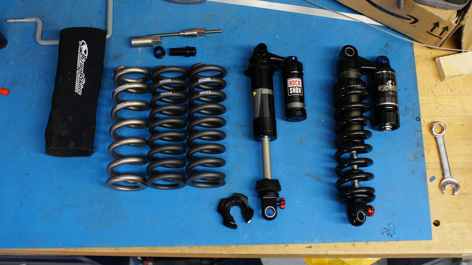

Messed around with the bike today. Swapped shocks and springs along with a new brake mount for more clearance.
Swapping springs. New spring is 400lbs. Left spring is 300lbs Titanium, center is 350lbs and right spring is 400lbs.
I just hang the bike when I work on the shock or drive train.

I'm wondering about your spring weight. Your bikes shock ,and swing arm geometry looks similar to mine. My spring is 750 lbs. I wonder why your spring is so much lighter then mine?
