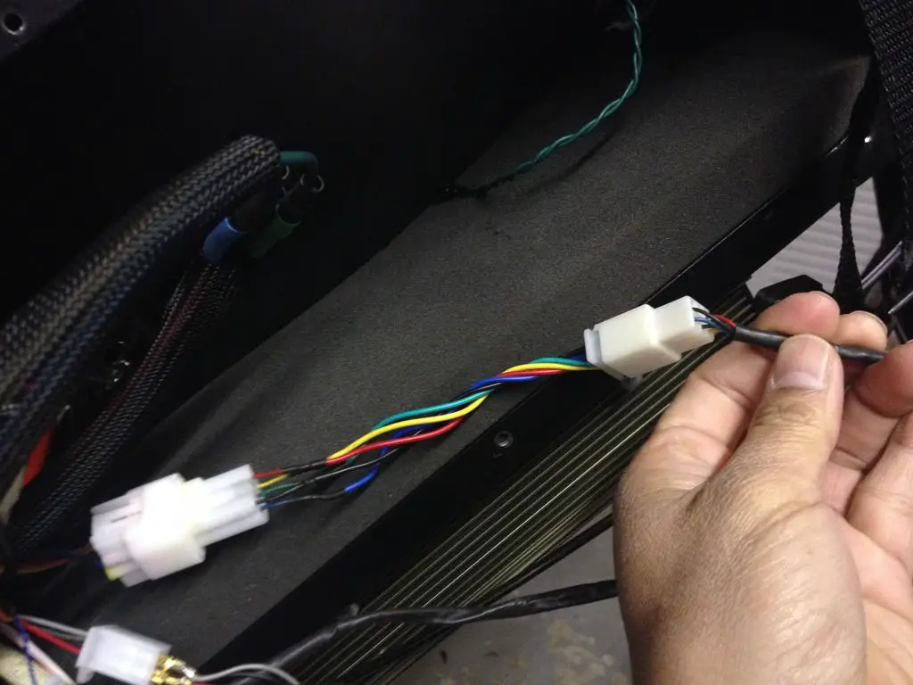

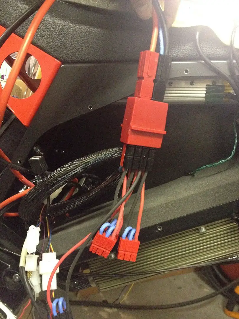

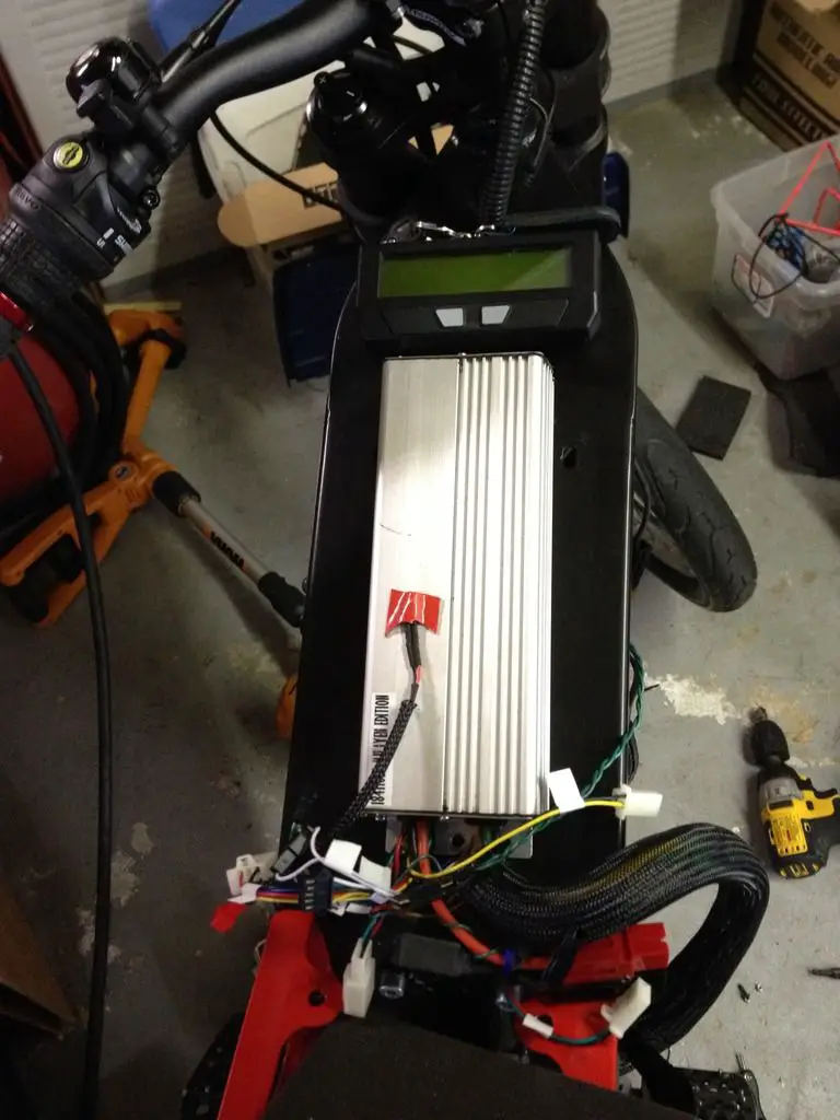

So my controller died on me and have to send it in for repair. In the meantime I hooked up a sensorless controller, but I'm not so happy with it. I'll be wiring up a Sabvoton this weekend and hope to have it running by Monday.

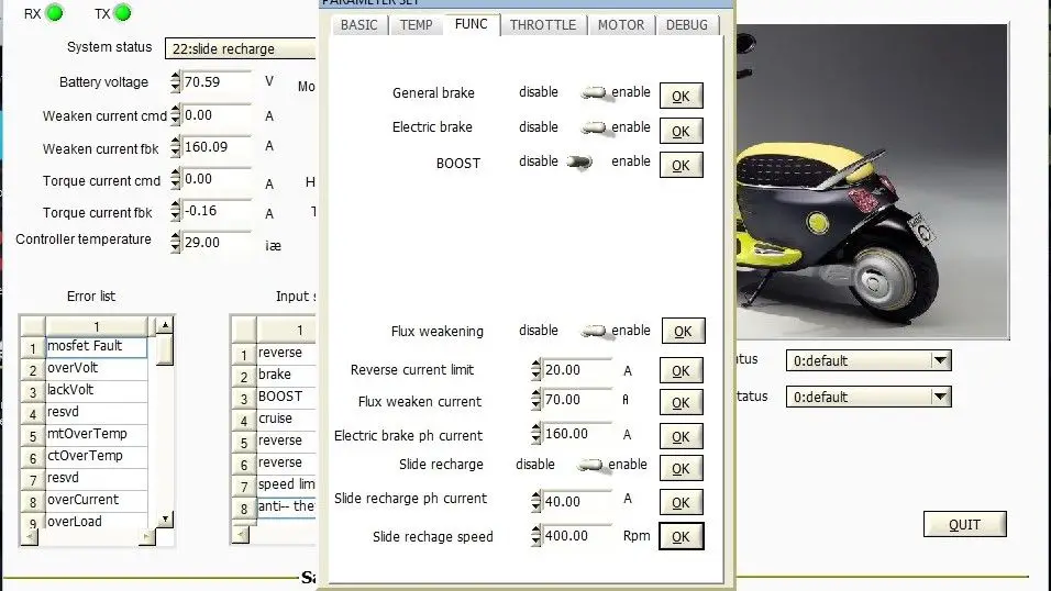

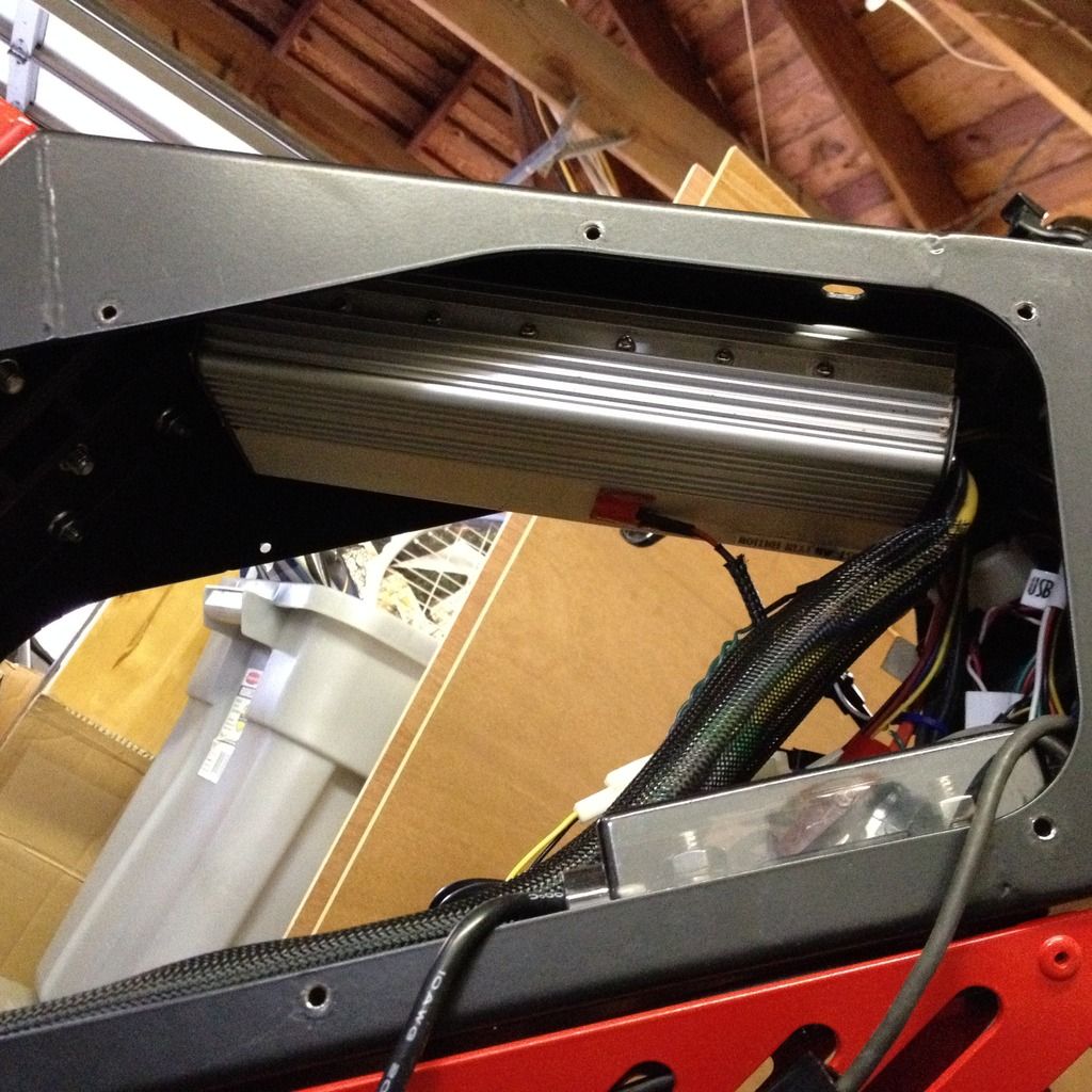

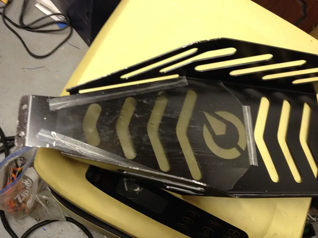

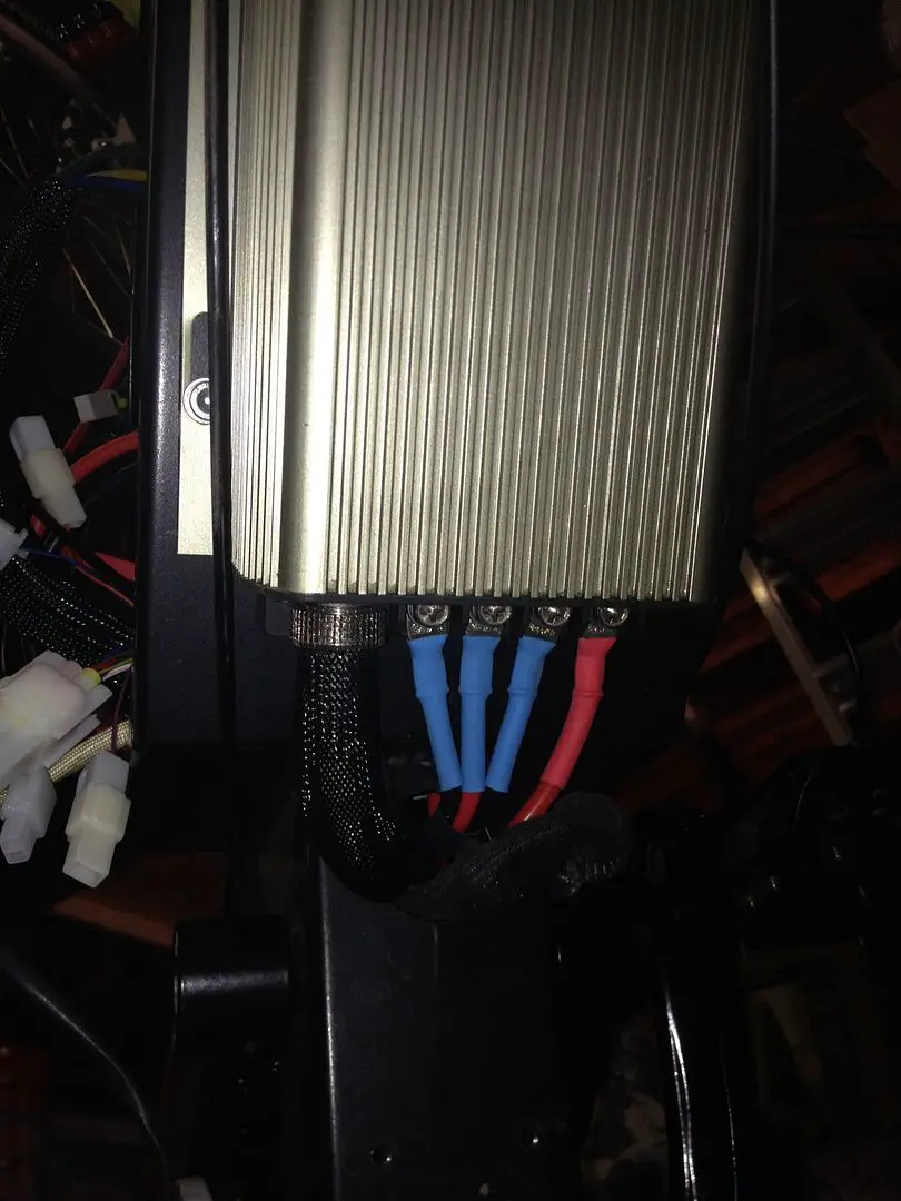

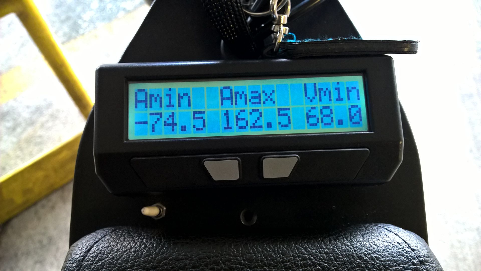

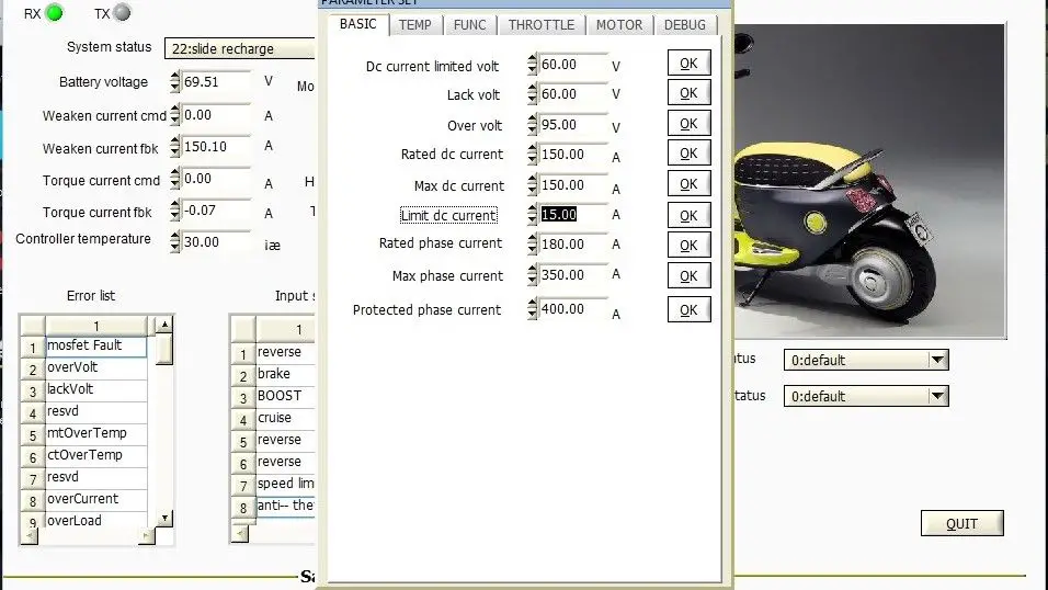

Sabvoton is nice, but freakin' huge. Torque is crazy, throttle response is nice. Not using the boost feature, just the slip charge and I miss the 3 speed setting I had with the Lyen controllers.

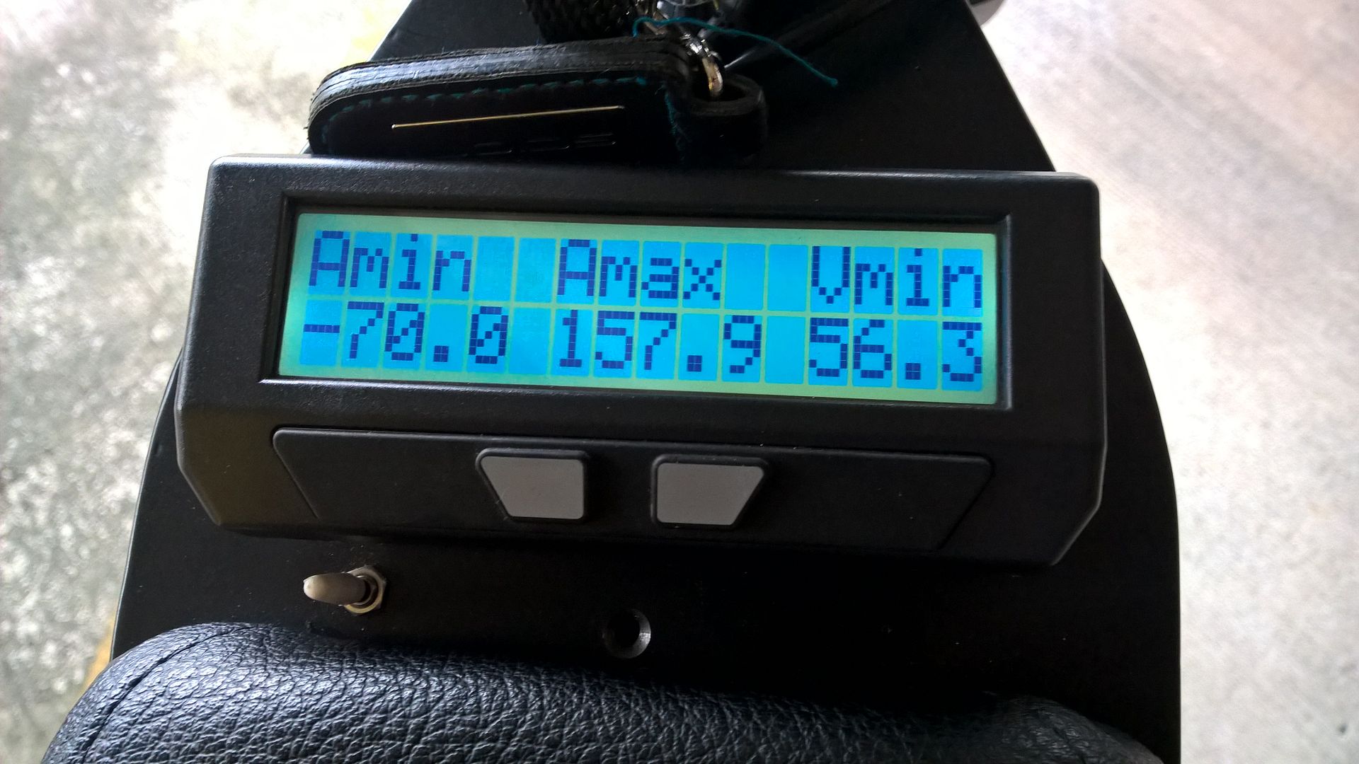

I peaked a bit over 10kW on 18s lipo. Smoother and more powerful vs the 18fet blown controller it replaced. Top speed is the same.
The Sabvoton in default setting is really quiet and underwhelming. It's just as "loud" as the Lyen controller at startup when tweaked for more Powa!

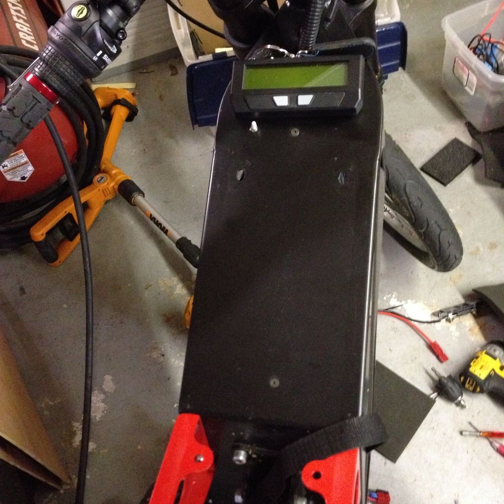

Added dust/water shield to keep the wires clean.
Big shield painted black and covers up the Sabvoton

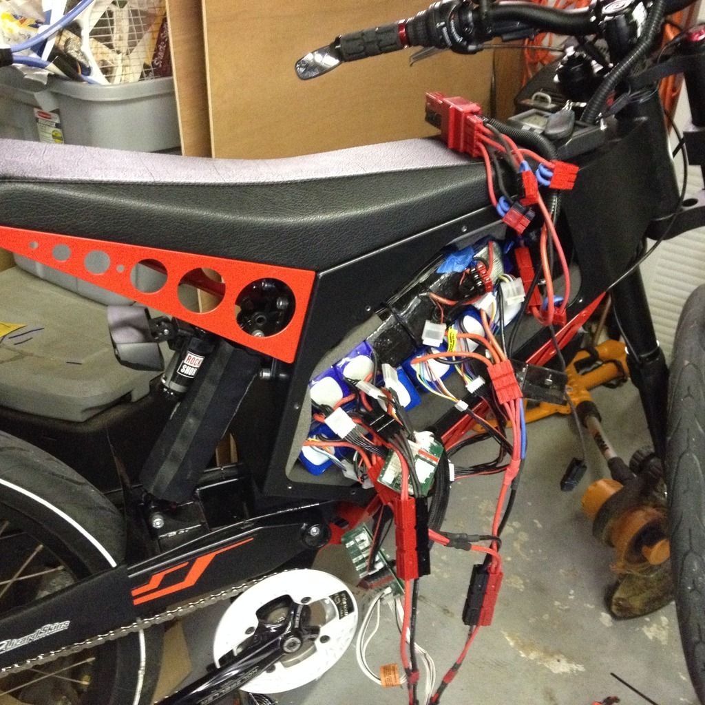

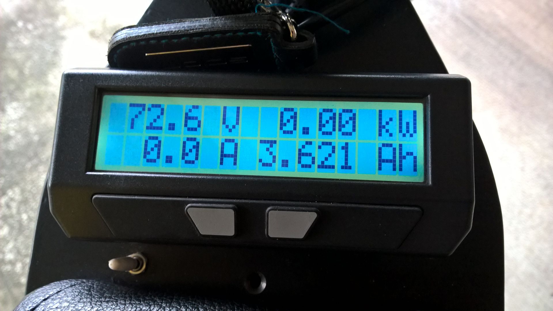

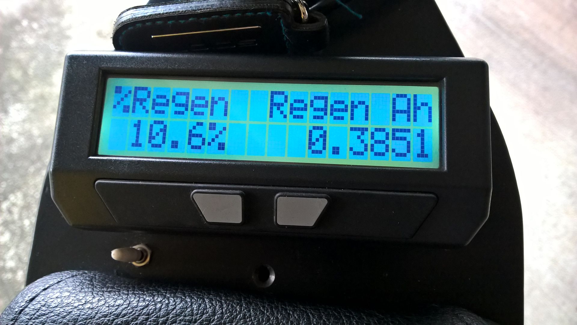

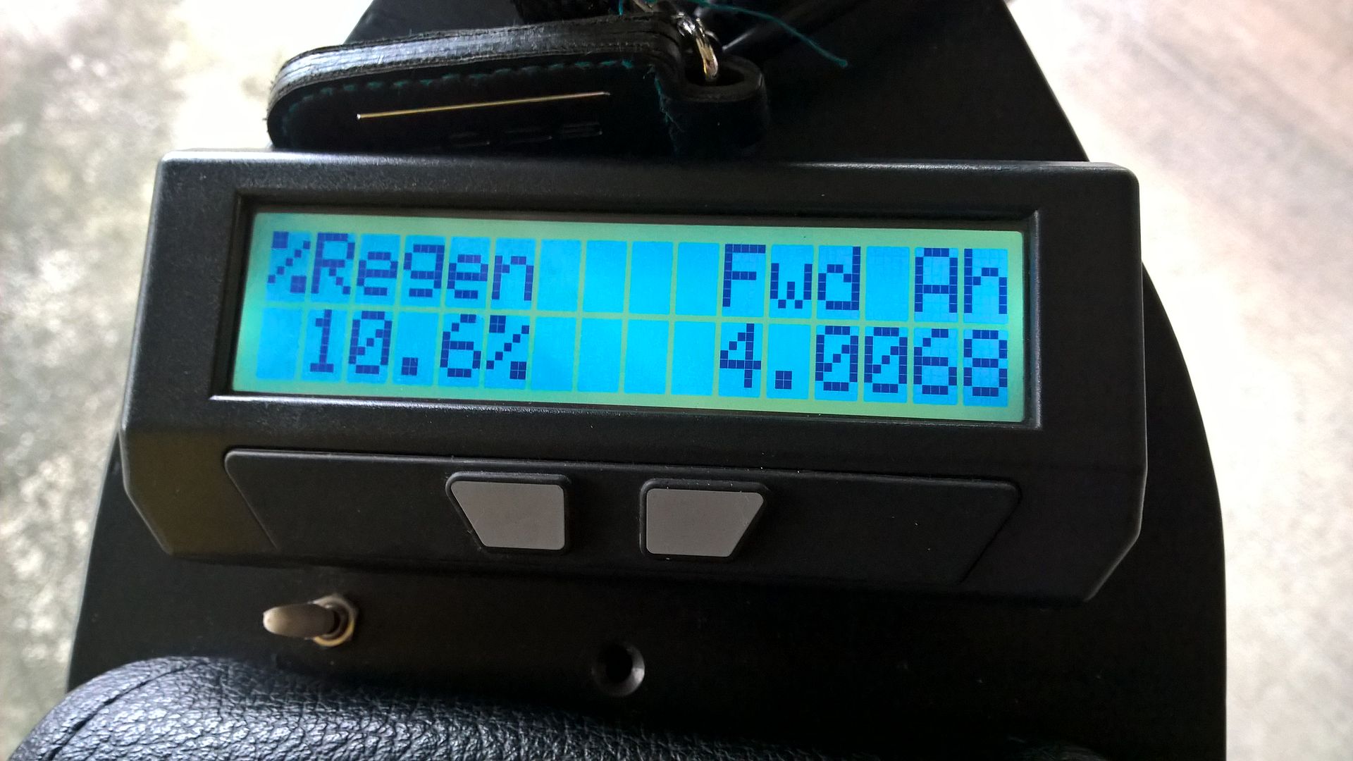

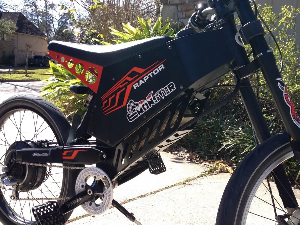

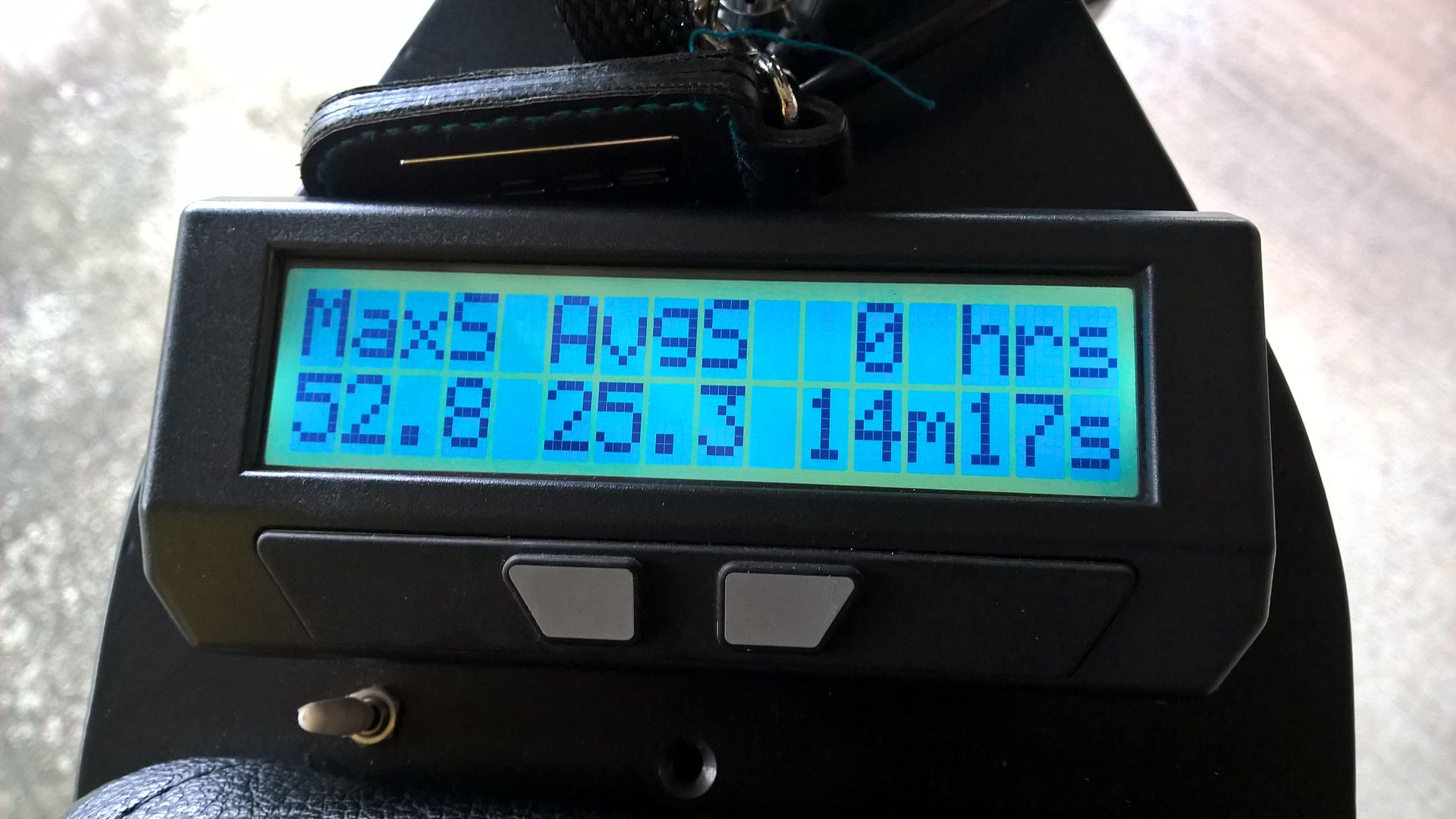

Finally got the Regen to work on the Sabvoton. Installed a automotive relay hooked up to the dc-dc converter, which is activated through a button. I omitted the variable Regen idea and just shorted out the signal wire to ground. I use Slip charge on top of that. This setup works out better for me. Regen is strong as ****. I get the same top speed on 18S lipo , as I did with 21S lipo with Lyen controller. Below pics are from my 15 minute commute.
