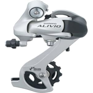

Use any "modern" derailleur (like this type)
http://ecx.images-amazon.com/images/I/41EgDS3tl-L._AA300_.jpg
on any bike with long dropouts (like we were discussing)
$10
http://www.yourprosolutions.com/images/thumbnails/551a82a5da4040aaafc8543f878ff997_168x126.jpg
http://www.yourprosolutions.com/pro...-1259?osCsid=2b35fe0687ca7681ccc0e48b1e234abc
Really, though, you can craft one from a piece of aluminum or thin steel flat stock. I made one of aluminum before, and the bolt on the derailer was hard enough to cut threads in it. It worked fine but flexed a little when cross chaining heavily on a 20" bike.
Ebike stop is good company, they have the fancy "emergency hanger" $13. I've bought from them before, fast shipping.
http://www.ebikestop.com/problem_solvers_universal_derailleur_hanger-FS0920.php
Here's another emergency hanger that gives some adjustment $15
http://derailleurhanger.com/dh199.php
