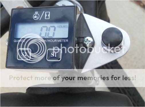

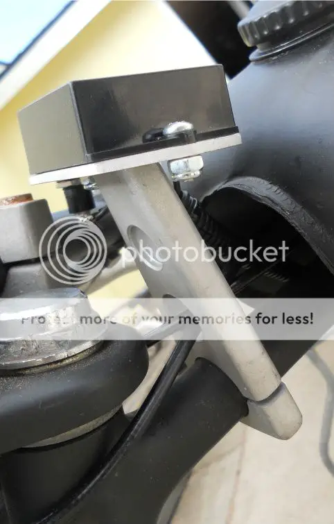

I made a little dashboard to hold my tach and kill button on my race bike. Ran the throttle and compression release cables through the support bracket. Getting it ready for Grange.
