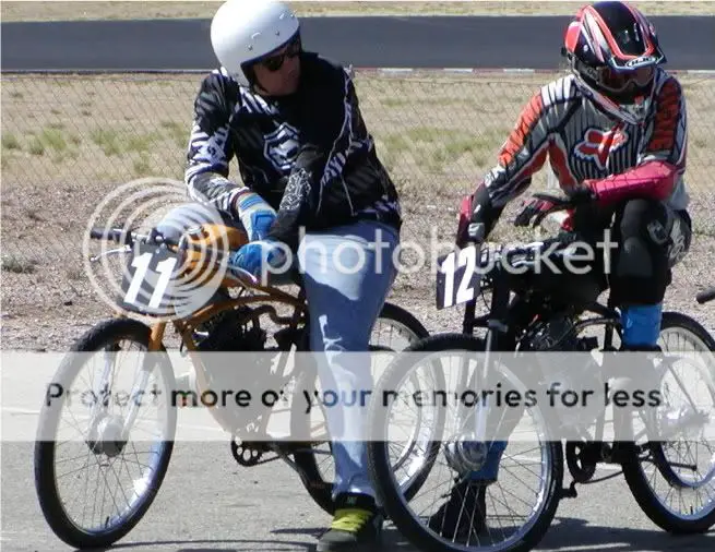

Re: what did you do to your motor bike today?
Yep, it's time for some early spring cleaning and maintenance. So many bikes, too much fun.
Also need to work the bugs out of my next race bike.
Then I can get back on some projects I started a while ago.

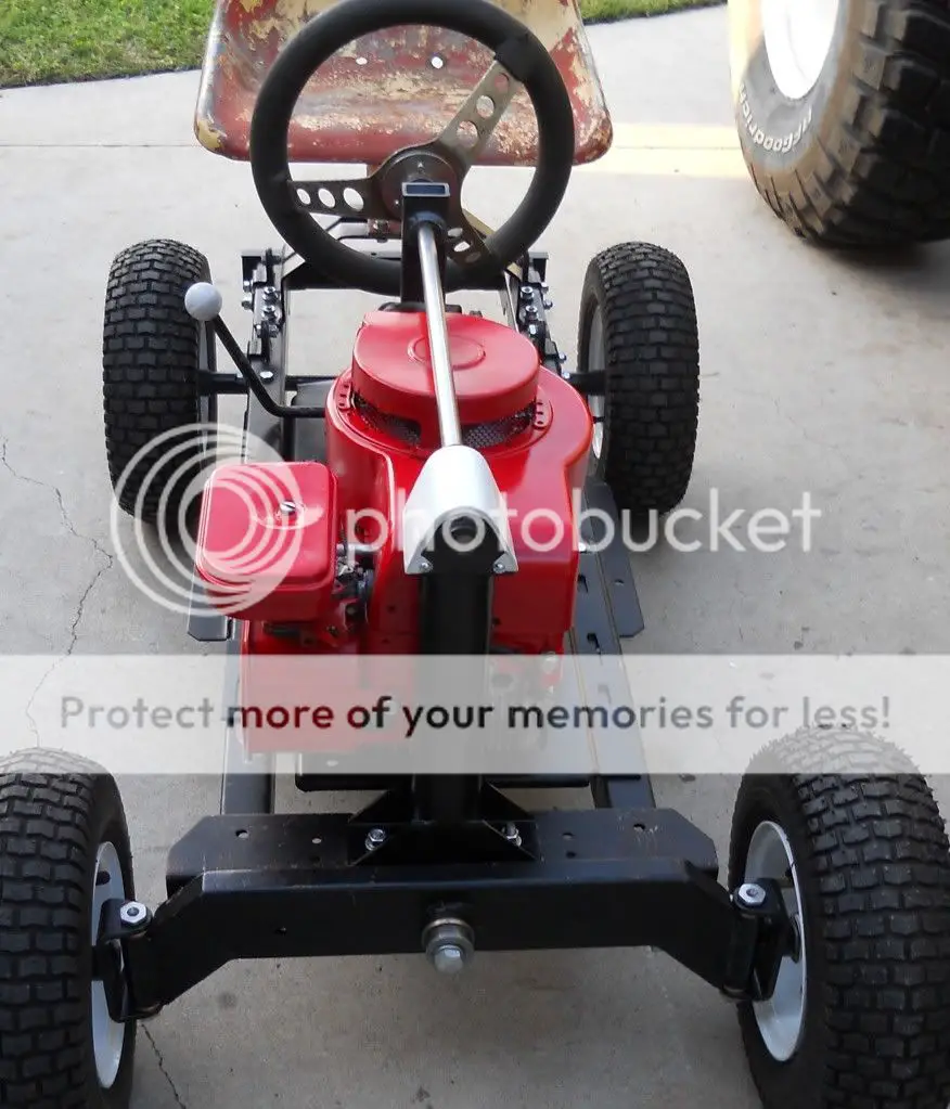

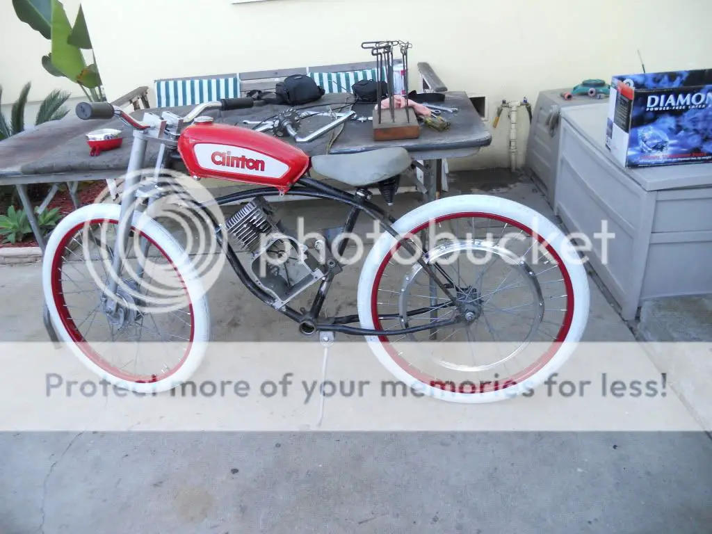

love the look of that race bike msrfan. cool little go kart u got there too. you rebuilding that black bike?
Thanks, MotorNut123, the black bike is one I started building a couple of years ago and got sidetracked with other projects. The go kart is a modified garden tractor I'm building with my grandson to replicate his 1974 IHC Scout 4X4. It's in The Tavern category under Four Wheel Project. We just starded on the body. I have to get it done by this April for an event with his off road club, so you'll be seing more of it soon.
