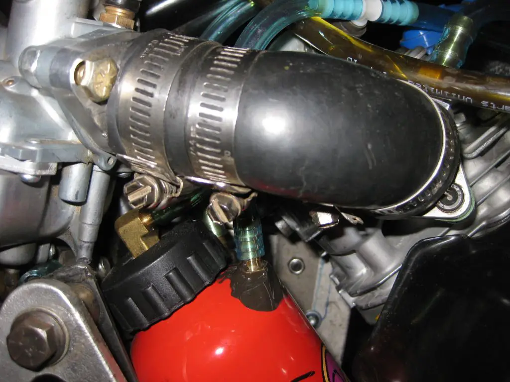

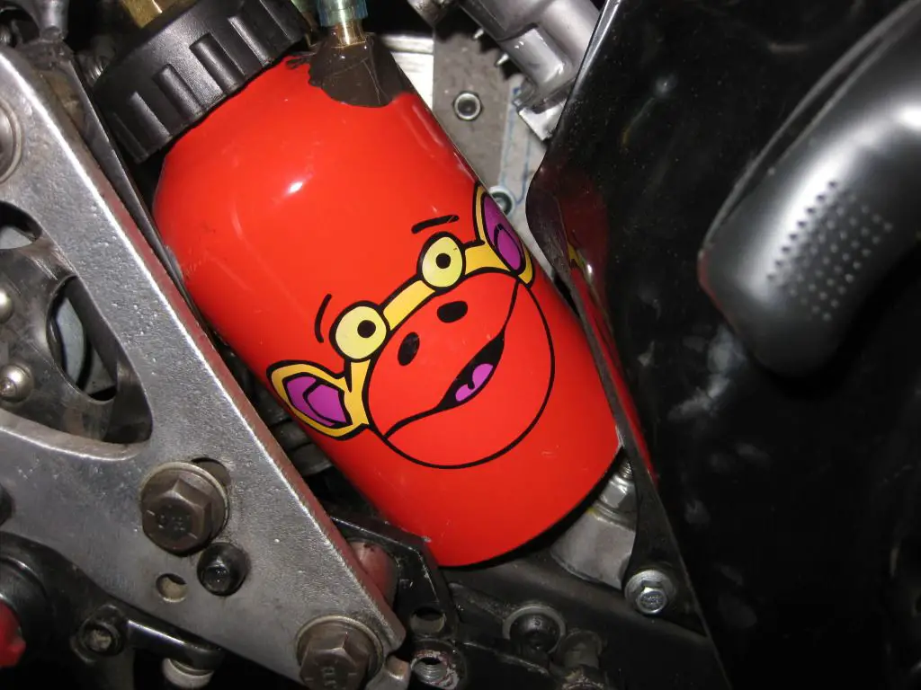

I had an old suppressor lying around (JK) that I used for an oil catch can. It’s not really a suppressor...sure looks like it could be tho. Well it did not work too well, filled up fast and blew oil out the top vent area all over the back tire...maybe that was my problem with traction...da...
I made a new one that is more than twice the size as far as storage, added a site tube to know when to drain. Welded on a tube clamp to hold it. This took some real time to complete but worth it I guess. Good practice for when I build that Street Tracker I want...
This should be a good upgrade, ordered a small vent filter for it...

The new oil catch can mounted low in the frame to keep a low center of gravity.
Happy about how it came out.
Great work CCC.

That turned out really nice Jeff, even better than I had pictured! It's only slightly more exotic than my latest catch can and a fair bit costlier I'm sure. :D
Cute monkey eh? TIG.......nope, JB laff
