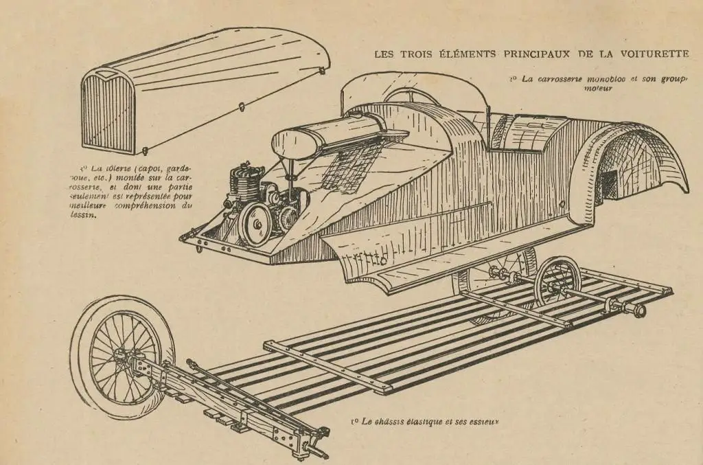

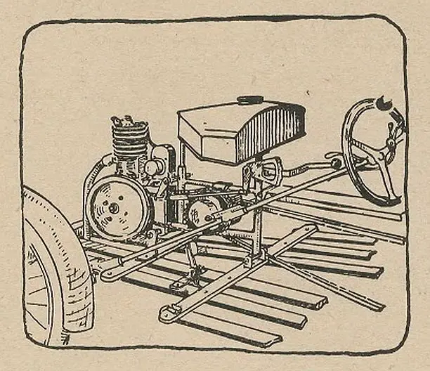

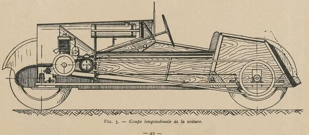

The work Kai did with the scanned pages from the French velocar book is really great. I haven't had a proper look at them until now and the clarity of the images compared with the blurry old scans I had originally is like night and day.
The cyclecar on page 45 has always been a firm favourite of mine and now that the page scans are so wonderfully clear it's become considerably easier to research and plan out its construction.
The design is based on the old Smith's buckboard, but without the motorwheel and with a proper bodyshell. It might be well and good for chaps to go powering around on a buckboard in the open air without a care in the world, - only a lady prefers to have something just that wee bit more dignified when she goes motoring :D
Nice scans, easy to understand even without much French. The buckboard suspension pretty well has to have four wheels doesn't it? Is there no way to make it work as a three wheeler?

I have a plan in mind to check that out Silverbear. I thought the buckboard style chassis would be good for vehicle experiments including seeing whether it would work as a three wheeler. No doubt my daughter will want to try out some of her electric vehicle ideas on it as well.
If the three wheeler idea doesn't work out it can become a quad; - though there is more than one way to skin a cat..........
I'll be interested to see what you come up with for a 3 wheeled car rear suspension. I have my own ideas but I don't want to muddy the water.

[FONT=Arial Unicode MS, sans-serif]Hello Silver,[/FONT]
[FONT=Arial Unicode MS, sans-serif]I think that three-wheel configuration shouldn't be any problem: quite opposite - it would be better for buck-board chassis system than four wheel! Buckboards do not have any kind of "normal" suspension, but have elastic chassis both for up-down "springing" and twisting of chassis according to uneven road, or vibrations... [/FONT]
[FONT=Arial Unicode MS, sans-serif]Therefore, three-wheel base should be even better: no need for twisting of chassis. I suppose that tadpole configuration would be simpler: two wheels at front, and one at rear. Engine could be at front or at rear. Any kind of body could be add later.[/FONT]
I am afraid that buckboard is only possible solution for me if ever start building of my quadricycle (four wheels are better for two heavy persons) - everything more complicated (and expensive) is hardly attainable... Of course, springs under seats (with thicker foam)[/FONT]
[FONT=Arial Unicode MS, sans-serif] are good[/FONT][FONT=Arial Unicode MS, sans-serif] for more “comfort”, but for vehicle structure, too: driver and passenger are the most of the total weight! (in my case)[/FONT]

Yes three wheeled vehicles are like three legged stools they don't wobble on uneven ground :)
What attracts me to the wooden buckboard format is its sheer simplicity of construction as well as its low cost. With the flexible chassis itself providing the suspension it's blindingly obvious that a whole slice of mechanical components along with their associated bearings, bushings and pivots are no longer needed.
I haven't forgotten or abandoned my Colombe/Intrepid cyclecar by the way even though it does specialise somewhat in the pivoting gubbins department with its front suspension. What the buckboard car is all about is being able to build a vehicle with simple tools and simple materials for not much money. My ultimate aim would be to build it with no welding being involved at all.
These wonderful French designs were intended to provide cheap transport in the immediate post-war era using basic materials and I think that is just important in 2015 as it was back then.
I shall now get down off my soapbox and stop lecturing the already converted. ;)
I thought I would use 100x40mm clear grained pine as it's a readily available local material commonly used to construct decks. Ash in timber form is completely unavailable here in NZ unless I was to get it through a specialist timber importer for $$$$$ which would be totally against the whole point of the exercise. Asian hardwoods are readily available here as well, - only I don't want to have any part in the destruction of rain forests in the Third World thank you very much.
As for an engine I've got one of those Lifan 110cc engines with an auto two speed transmission that has been occupying space on the bench for far too long. It originally was fitted to one of those Chinese mini-chopper bikes. I purchased the bike cheap as a non-runner a while ago and sold off everything I didn't want as parts keeping back the engine and its wiring loom.
