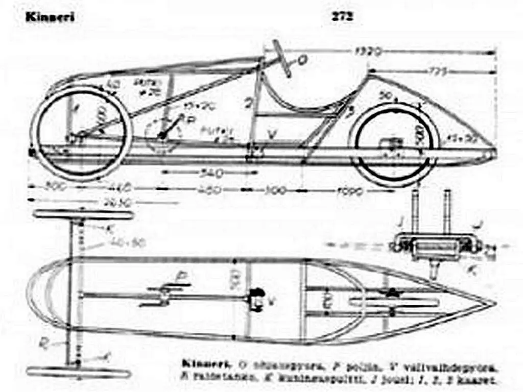

Here you go a vintage plan and a picture to go with it. Well, what are you waiting for? - go and build one. ;)
Please note what suspiciously looks like a bullet hole in the original print :eek:
I like that Kinneri plan because even though it is a single seater, it has a perimeter frame.
Can you tell what is in that detail between the the top view and profile view of the car. A detail of the steering
spindle?

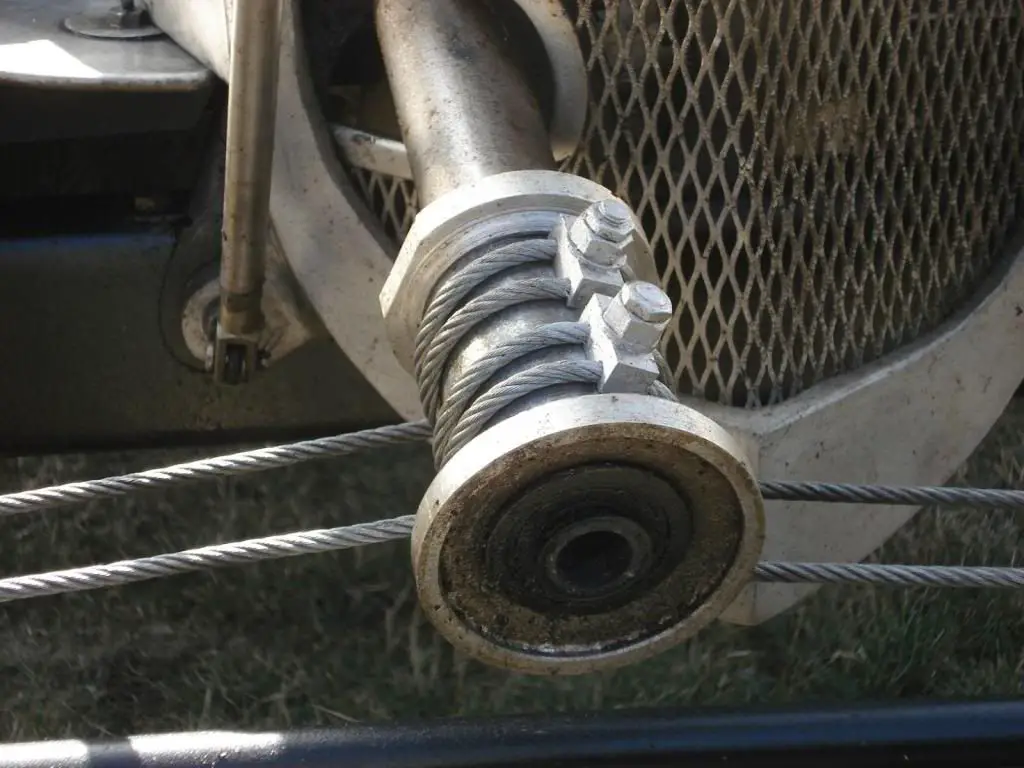

Wheelbender, unfortunately the only plan I have for that particular velocar is that one which I carefully increased in size from a very small diagram indeed using graphics software. Most velocars from this period used bobbin and cable steering, so the steering shaft would basically be a length of steel rod with a steering wheel on one end and a bobbin (think large wooden or steel cotton reel) which would have the steering cable wrapped around it with the ends of the cable being attached to the steering arms.
This is the 'bobbin' from a GN cyclecar, but the principle remains the same.

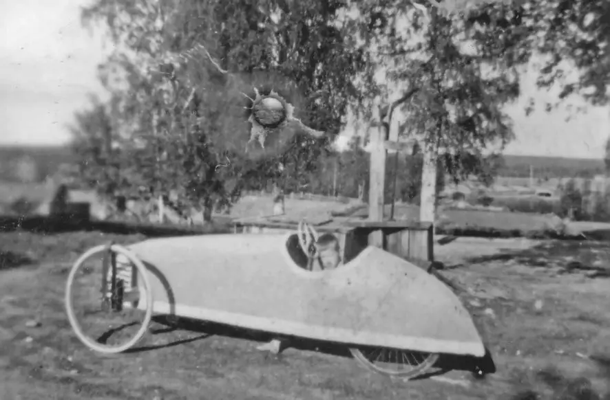

I thought of you I.W. as soon as I ran across this gem.
No info, just a cool picture. Never seen a front end quite like this one, but I'm sure you know what it is.
Your Velo Fu is legendary. I get a Hispano-Suiza kind of vibe...what do you think?
'Chocks away Biggles.' ;)
I think these light aircraft inspired cyclecars are great. I'm sure I've seen other pictures of this particular car elsewhere on the 'net, but I just can't remember where for the moment. I have a feeling it was built by a private individual rather than a car or aircraft related factory.
Velo Fu, - I like it :D

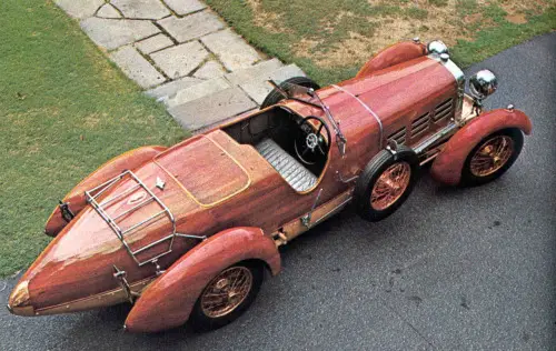

Cyclecar it isn't, but there's this Hispano Suiza for lovers of wooden bodywork
That photo appears in a couple of my books. That HS is one of my favorites; all covered in (if I remember right) tulipwood and copper sheet with copper rivets and copper plating on either steel or aluminum. These cars were built in a day when the big name automakers had time and money to make whatever beautiful thing popped into their heads. Sometimes it was the buyer persuading (with plenty of money) the coachbuilder to work magic. Either way, unless we become rich as a sultan, or build what we choose, we will never see cars like these built again.
Thanks for digging out that photo. I never get tired of looking at that.
PS: I can't believe it took me this long, but NOW I see the resemblance you were referring to before.
