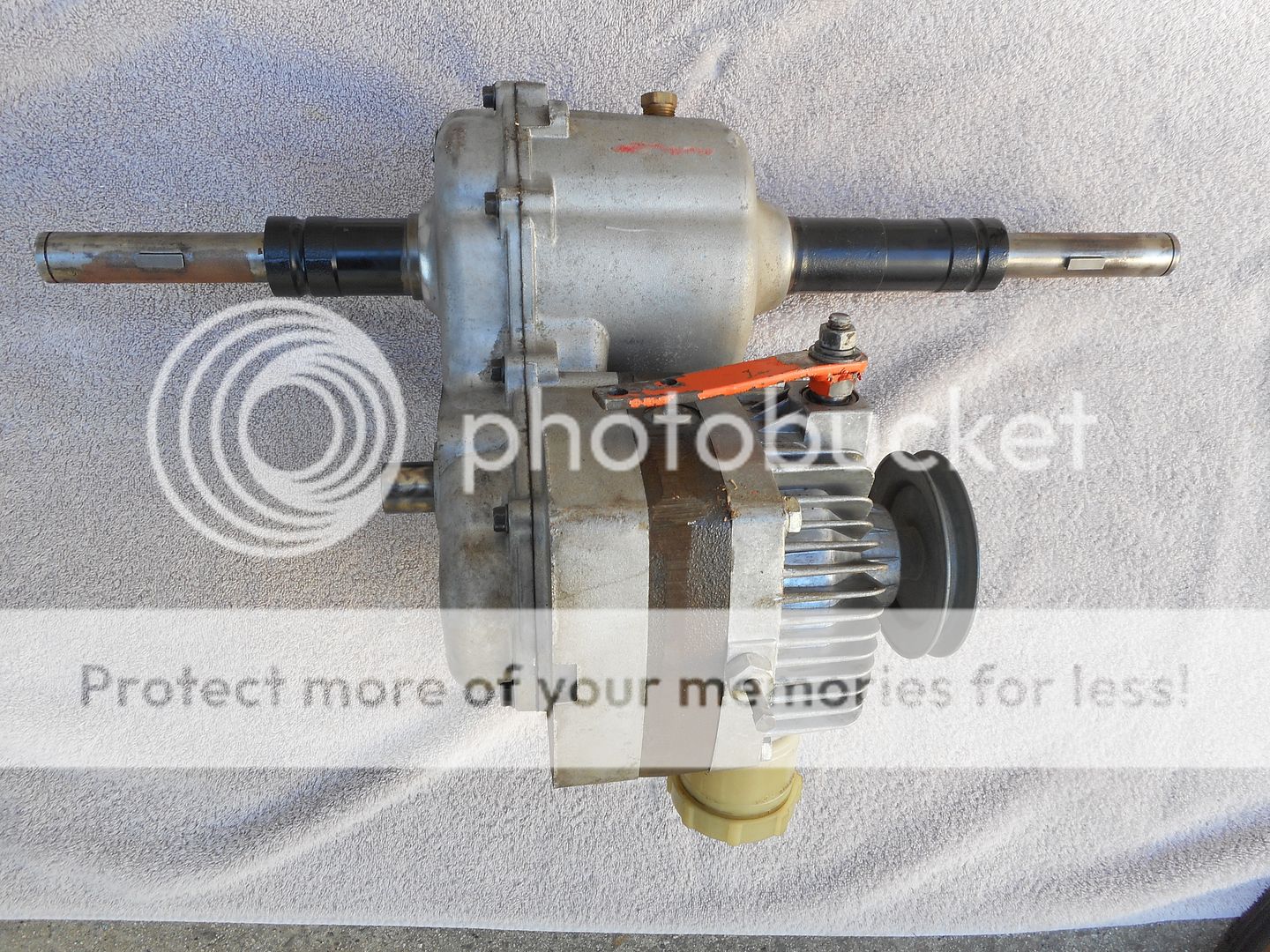

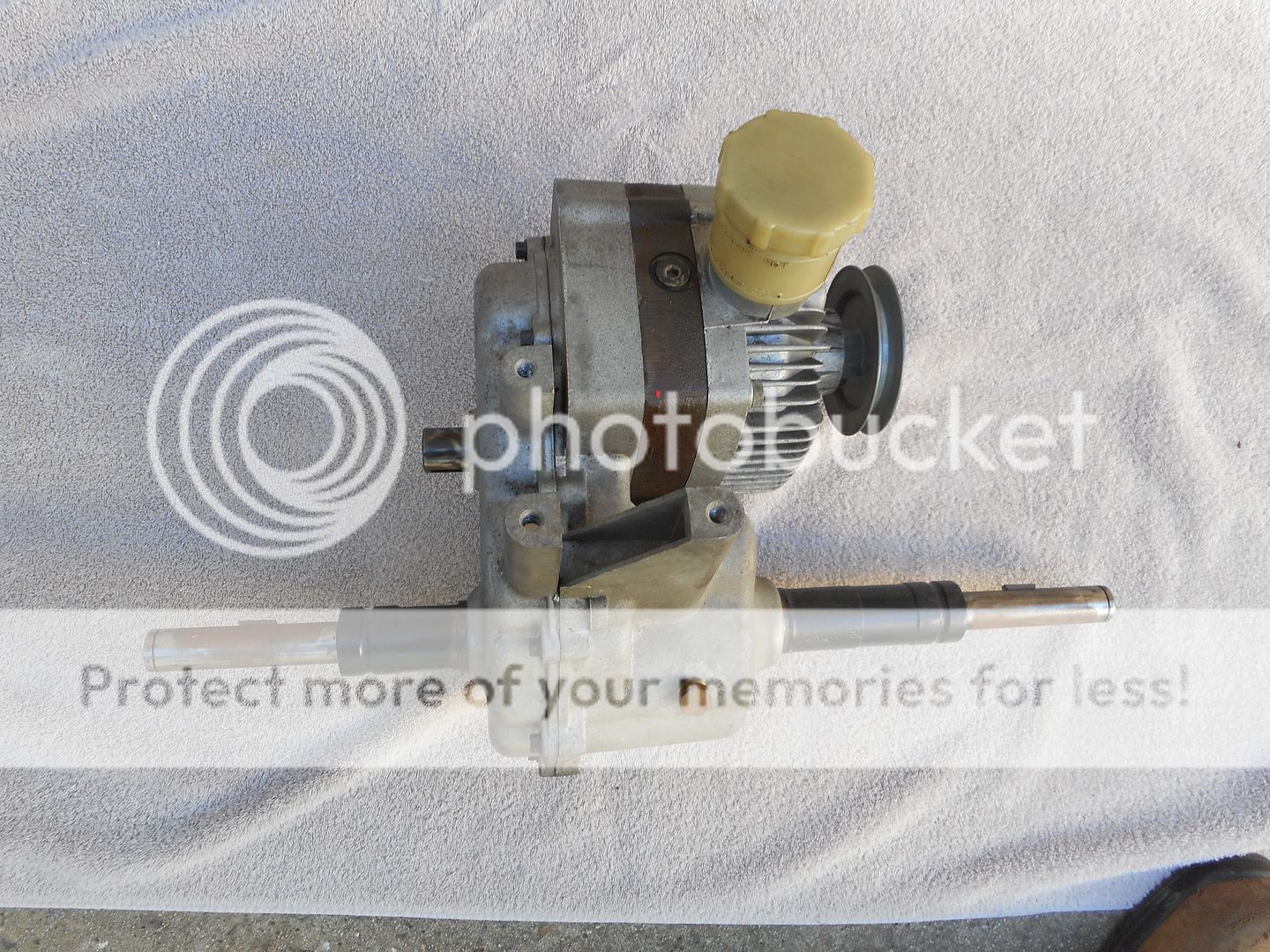

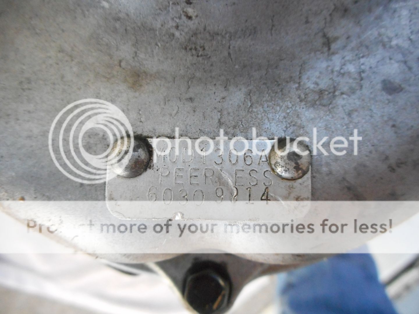

Hey Curt, is this what you're describing? I've been saving it for a special project, and I think a velocar would be a perfect platform. It's a Peerless model 1306A.
Hello,
If I understand well, hydraulic Peerless trans-axles have possibilities:
  • differential function;
  • continual change of speed;
  • forward-neutral-reverse action;
  • braking (parking brake, too?);
I am not sure if they could be bought in Europe - couldn't find dealer...
Zoran
Yep or one like it i have the hole Simplicity tractor, my son got without the deck. I said i know were that going. Go for it that will be KOOL
Zoran there must be some lawn tractors that have hydrostatic drive, they have been out for years here..................Curt
