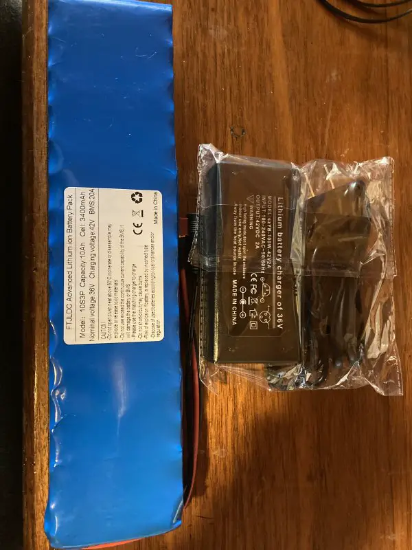

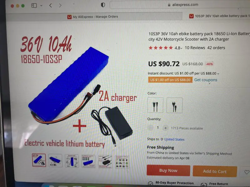

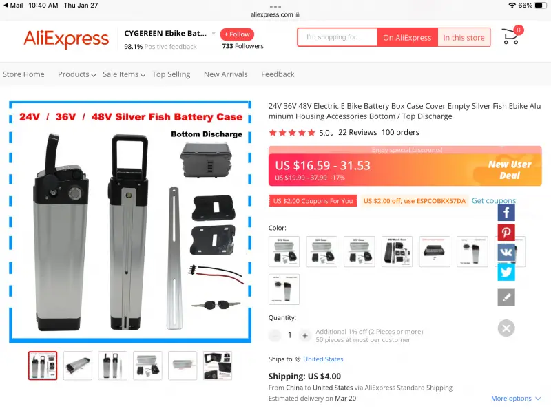

I finally have something for show and tell for the American Flyer. It has been sitting in the background in my shop as I work on electrifying recumbent Terratrike Rovers and doing a little on the old Indian Hiawatha tri-car in the basement. Every now and then I give the Flyer a look over and some thought for later on. You may or may not recall that the bike has a 36V Golden Motor hub front wheel and that I was tentatively planning to up the battery and controller to 52volts, the same as my other electric builds. I have assembled battery building kits from Vruzend along with 18650 cells through Aliexpress out of China. Everything is now here waiting for me to muster up the courage to put the cells together into finished bricks. Bricks are now together and all the cells are producing close to 3.7v. Next is doing the connections between cells which is where it gets potentially exciting if I screw up and create a short circuit. Four different bricks have been laid out in 14S4p, 14S3P and two in 14s2P. These are for the quad and recumbent tadpoles. One of the small ones was going to be assigned to the American Flyer, but along the way I reconsidered leaving the voltage at 36V using the original 36v. controller, thinking that for that bike 36 volts is probably enough power along with the 3 speed Sturmey Archer rear hub. The original intent was electric for hills and using the bike mostly as pedal power. I also thought I would not be tempting fate with wrecking the hub by over volting it… not likely to happen, but could.
Having purchased a number things through Aliexpress with satisfaction in quality of merchandise, price and delivery I took special interest in an offer on a 36V. Battery pack including a low amp charger. From what I’ve seen with electric bike sources stateside there has been difficulty finding batteries and those available are quite expensive. I’m not usually a gambler, but thought I’d have my daring night at the casino by taking a chance on this battery pack. Might be a winner with decent cells or a loser with the other kind. Should I or shouldn’t I? What the heck…it’s just money. Come spring I’ll just pick some more leaves off the money tree I planted this fall. I read in my Lepricon Gardening guide that a small bag of silver coins planted in the fertile ground and regularly sprinkled with liquid nitrogen (urine) is a sure fire traditional practice leading to great wealth with your own orchard. Can’t wait for spring! So i placed my order.
It cost less than that with the special offer to a preferred customer (that’s me!) and just yesterday the battery came.
Nice color and no acid dripping out or smoke so thumbs up! I did check the voltage and it registers at 38v. So far, so good. Who knows what brand they are… pretty well guaranteed to not be the high priced spread like Panasonic or Samsung, but maybe this is a brilliant startup trying to open up a market and I could be getting in at the ground floor so to speak and helping something great happen. Or not. I figure that even if the batteries don’t last through a thousand cycles they will likely last longer than I will. Sometimes when you gamble you lose and it is still fun going to the casino, having some cheap thrills. And once in awhile you actually win something. Either way, I’m having fun. I also upped the anti (sp?) by purchasing a battery holder to mount on the seat post.
What’s another $30 bucks or so?… a few more leaves from me money tree, that’s all. Now it’s time to hurry up and wait for the holder to come. Oh boy…

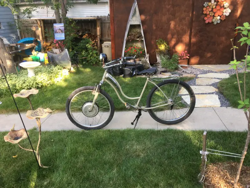

Silver bear I have 3 of those aluminum holders mounted on rear racks two are 36v 16 amp he & one is 48v 16 amp he all are from china and all have lasted 3 years and a lot of recharges the 48v is about to be opened up as it's not wanting to charge up. I'm thinking these all have Chinese cells, but we will see. I'm hoping and think the cells are fine but suspect the BMS is bad and won't reset properly. None of these packs were expensive and like you said the aluminum case adds $30 or so. The slide on, locking mount/on-off switch works well. I mount mine on a rear rack, but down tube or seat tube is great, if there's room.
I'm hoping you will be pleased with the packs performance. I pedal continually and use a twist throttle (no pedal or cadence sensor) and get really good mileage as a result plus exercise. My Mountain bike gets serious miles on a charge but that's pedaling with a 8 speed Shimano derailleur, never tried to test with motor power only though. I tested 3 of my 36 v packs this week they were fully charged. One was 41 volts, one 37.7v & the other 39 a. Thirty six 10s packs do vary a bit and of course age and number of recharges plus add ambient temp matters as well. I have one pack 36v that never charges past 35v I'd think this pack is only at 80 percent of it's capacity when new and it performs great just won't charge up to spec.
In studying up on lithium pack repair I see a lot of BMS problems and the stated reason is using very poor quality think cheap, BMS even with packs having quality brand name cells. Cutting corners? Good BMS replacements of 30amp are quite inexpensive, but tech time is expensive. The hub motor kits use, typically, throw away controllers of 20 or 30 amps (48v kit) I'm in the process of upgrading controllers as they fail, using 30 amp for 36v battery and 40 amp for 48v motor sets.
By going up 10 amp on 36v motor, 20 amps to 30 amps, 360 watts are gained making the 750 watt into an 1,100 watt. Speed is the same, but torque is increased. 48v motor with 10amp controller increase gives3/4 hp gain. Either one is a huge gain in hill climbing and acceleration.
When you buy a hub motor kit grom a specific supplier,chances are the selection of 500w, 1,000 watt and 1,500 watt motors are the exact same motor but supplied with 3 different amperage controllers. Some will have a 750 watt offered as well.
Of course increased amps will, if used recklessly will really drain a battery. On road trips I use enough throttle to keep the bikes pace and enough gear and pedal pace to steady my speed. I typically coast descents or just pedal a little to keep my speed constant.
On short rides under say 15 miles I still pedal but some don't want to and usually they make it home under motor power, if not they pedal and or walk it home. I say told you so....
Anyway glad you guys are finally getting into this as well as gas bikes. Our hobby doesn't have to be either or both are fun and fine!

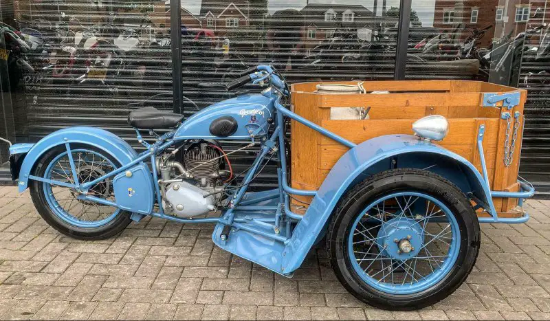

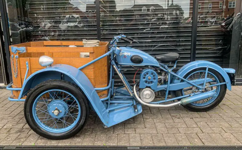

Here's one for tadpole aficionado's out there. Don't see something like this very nicely restored Peugeot Triporteur come up for sale in the UK very often Steve, so I thought I'd share a couple of pics with you. Listed by a well known motorcycle dealer on eBay right now. Leaving you UK£5 change from UK£8k.
Never mind a crash helmet....I reckon a beret, set off with a striped tee shirt and a string of onions round your neck is the correct attire for this !

To add to that Pete, I'm imagining a Gauloises dangling from one corner of the mouth and a canvas back pack with two or three baguettes poking out of it and the distinctive shape of a couple of bottles of wine within.
Thank you for the photos. They are fantastic.
Steve.
... and plenty room in that stowage box to haul your accordion...!
