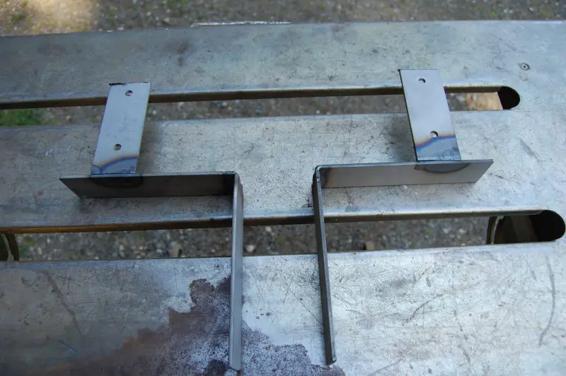

If the weather tomorrow is good I'll weld up the steel for the headlights.
Steve.

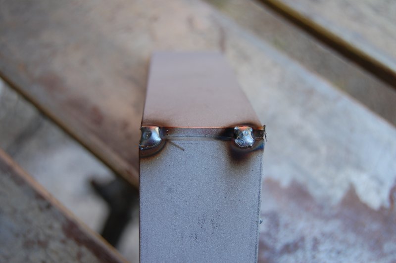

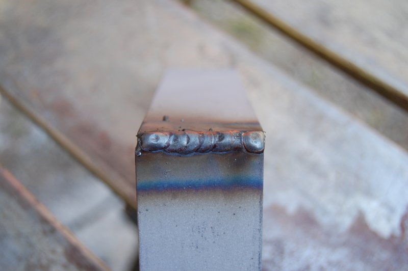

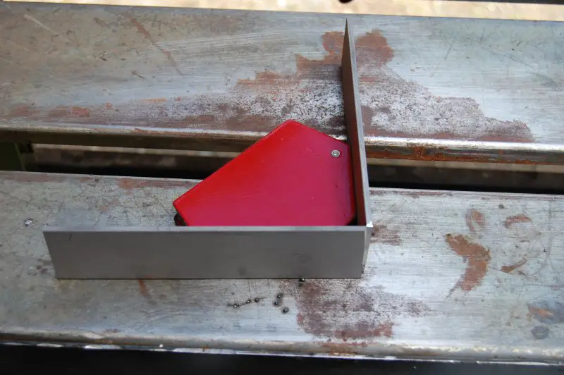

The headlight brackets are finished up. One set for the Epic and one set for the Indian Tri Car. I'll order another set of headlights soon. Working on the best way to attach them to seat of the Indian and the delivery box on the Epic. I think that I'll go with a piece of the 1-1/2" x 1/8" steel I used for the brackets screwed and epoxied to the wood then I can use riv nuts to bolt the brackets on.

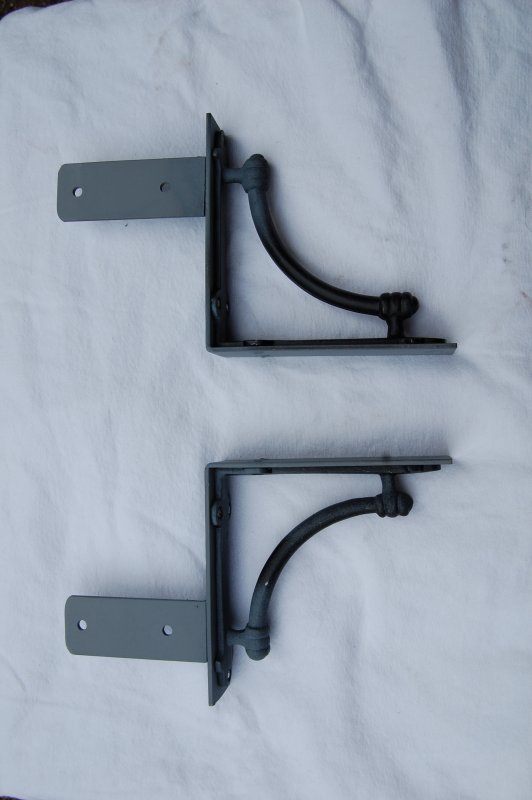

I pop riveted the cast iron brackets to the headlight mounts I made using the screw holes in the cast iron brackets which are shelf brackets in another life. The metal sticking up with the two holes in it are where the brass lights will attach. For some reason the photo is sideways. I'll get a better one tomorrow if it doesn't rain.

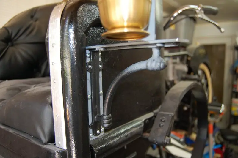

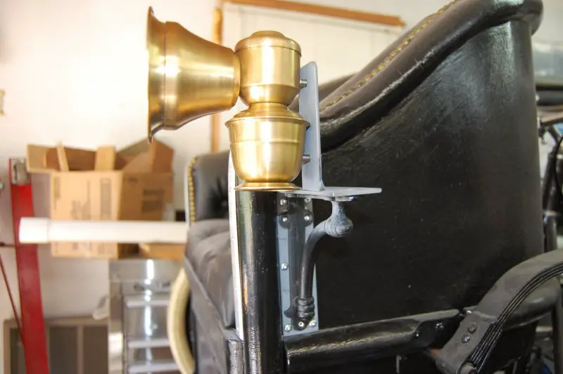

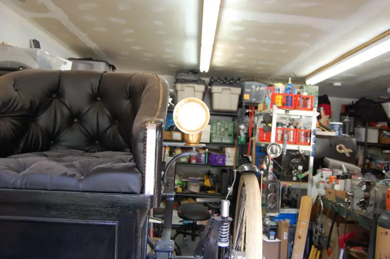

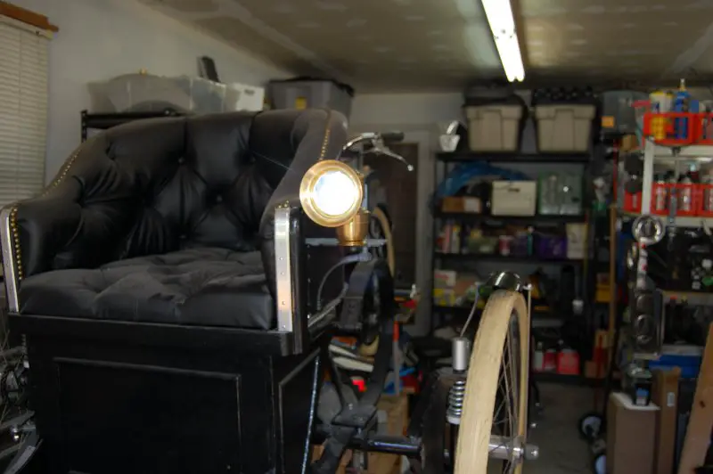

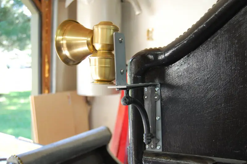

Mounted one of the headlight mounts on the Indian Tri Car and put the brass light on it to an idea how they will look. I have longer bolts for the light coming and when the light is mounted permanently the bolts will run through some copper gas line to hold the light in place.
Next week I'm going to get the paint and some tubing to make Silverbear's front fenders for the Hiawatha Tri Car. They have a very Art Deco style curved fender support.
The box will be made from sign plywood. Crezon plywood is smooth and can be painted over easily. The other choice is gluing metal onto plywood, then painting it.

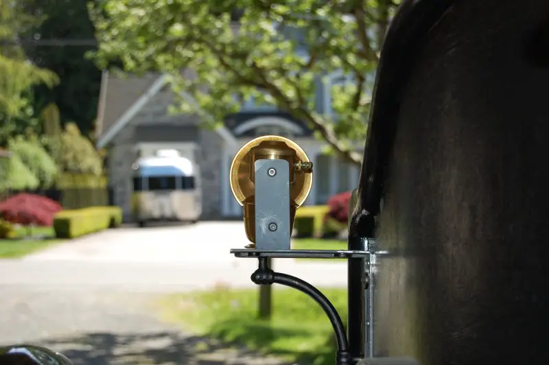

A nice and new Airstream at that. Usually parked beside the house behind a fence. They tow it with a Tesla.
I owe you a huge, Thank You, for pointing out the lights to me. They are indeed bright. They are LED and I will be interested to see how long they last between charges not that I'll be using them much night. More for daylight riding as a safety precaution.
