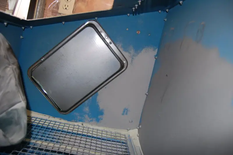

Air inlet baffle. I didn't get a photo of the air inlet gate.

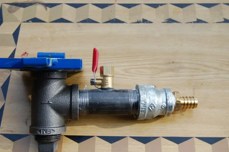

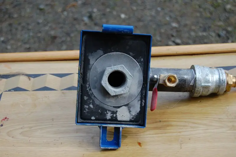

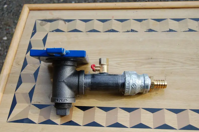

Top photo has the air valve open and the second one has the air valve closed. This allows air into the manifold so the media doesn't bunch up. You set the amount of air you need by opening the valve.
The bottom photo is where it's mounted on the door on the bottom of the cabinet. This where the worn out media was dumped originally. There is a pipe plug in the bottom of the manifold to drain out the blast media. I used a reducing bushing to hold the manifold to the door. Media inlet hole is now 1-1/4"

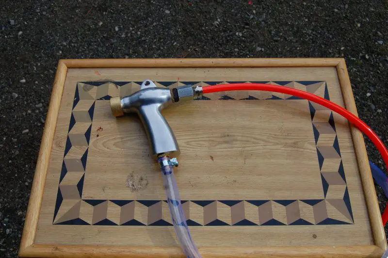

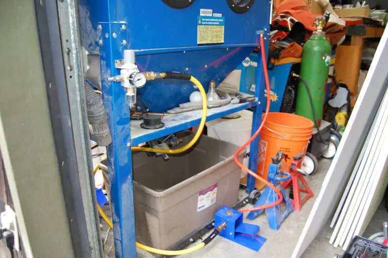

Top photo is the gun and bottom photo is the set up as it is now. Red foot pedal hose needs to be shortened.
Media hose needs to have a hole drilled and I'm waiting for the grommets to arrive tomorrow so I can install it.
I'll post a photo of the dust collection system tomorrow.

Still waiting for the rubber grommets. First it was Saturday, then Sunday, then Wednesday. Cancelled and reordered from somewhere else and it will be here today.

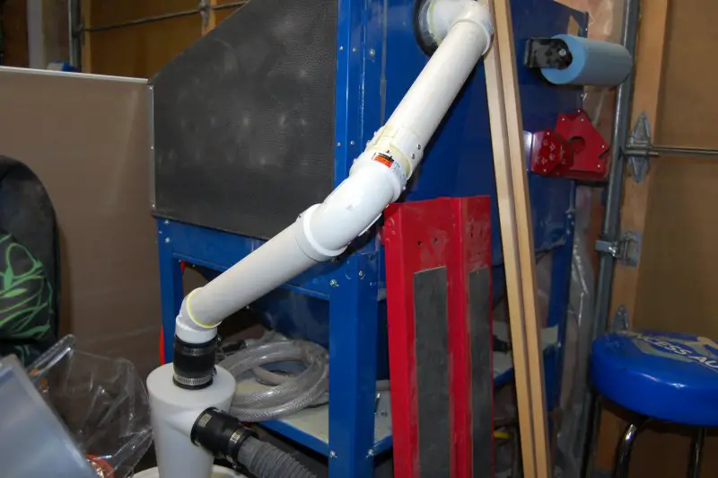

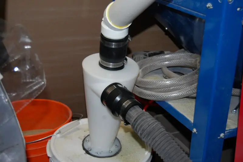

This is the dust extractor set up.
Tried to pull the bearings out of the wheels and it didn't work. I'm going to weld up some thing up so I can use a bottle jack to try and press them out.
Steve.
Finished up the sand blasting cabinet today. Installed LED lighting, and shortened up the hose that needed to be shortened. Hooked up the air line to the air pressure regulator and put Silverbear's head light stands in to see how every thing worked and the air regulator is no good. Another one will be here tomorrow and we will try again Monday.
