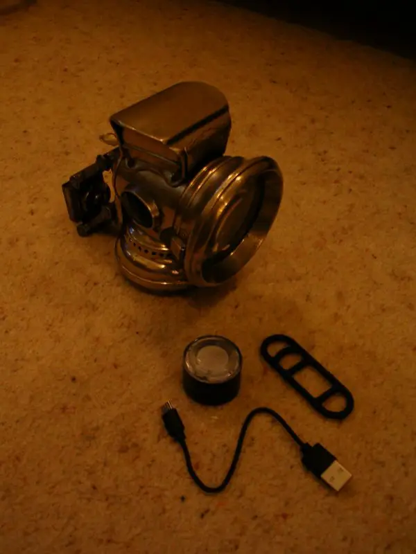

Steve, Shame your brass headlamps didn't come with the necessary USB charge lead. That UK£4 USB rechargeable LED headlight I recently bought from China to convert one of my vintage brass headlamps came with a short lead that I just plug into my laptop to charge up the light.

I like the light, Pete. I'm sure the light seller I bought them from would be sure anyone buying them would supply their own or didn't care. I purchased one from Amazon.
I did hear back from the seller about the battery but it was the usual skirt around the problem, I sort of understood what you were saying but I'm not responsible so I'll put my spin on it. Best part is that I was sure that battery holders would be sold on AliExpress. If I had the proper terms for the lights I'd bet they are for sale there in more than one place.

Odd they sold you USB rechargeable lamps without including a charge cable. The indicator/tail lamp unit and the inertia stop lamp unit I purchased for my BLUE BAMBOO build both came with a cable included. I have three charge cables here now...!
Anyhow, I'm sure the lamps will look the dogs danglers once installed on your ride.
