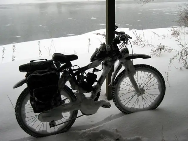

Snow storm? Sounds like fun ;)
All ya prolly need for the engine chain is a half link like this (check proper chain size): Sick Bike Parts & if the engine studs work the way they are - why replace them?

nice, snow bike,...!
well, that's just it, the last time I pulled a nut, the stud came out with it, and getting it back in was no fun,.... but it's in there now (working I guess) but the next time I go to pull the head if that whole stud come out again I think I should replace it, and if I do, might as well do them all,...? ya think,...?
