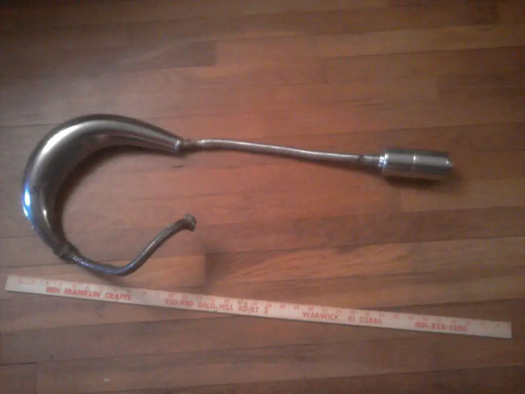

I finally got to work on a pipe, lve been doing a little reading on the best length of the head pipe for bottom end torque. What I came up with is about 16 inches, 3/4 emt bent as tight as I could get it with a conduit bender. I made the chamber section out of a conveyor roller and salvage parts. I'll post pictures when I get it all dressed up, now it in untouched form while testing. Its good on the bottom end and even better on the top.

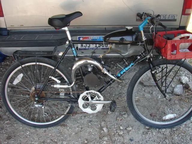

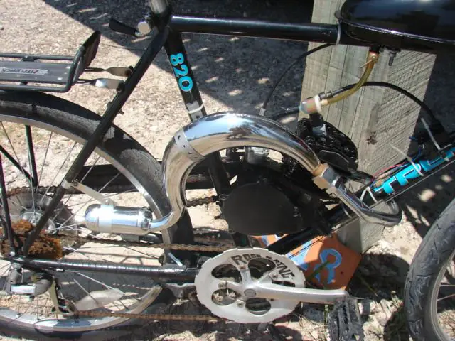

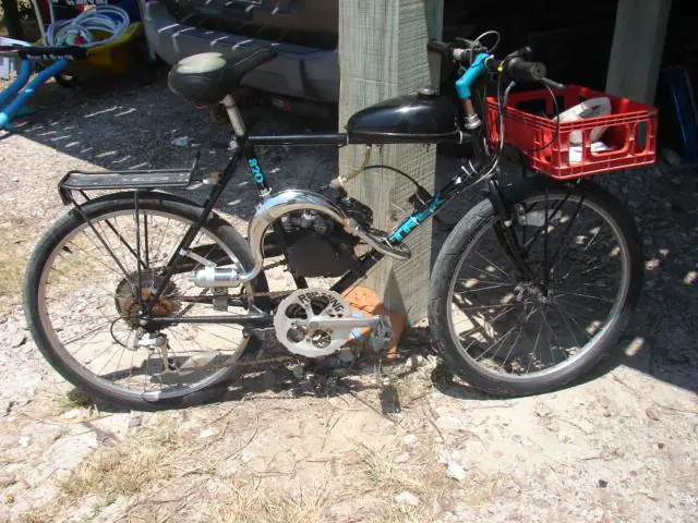

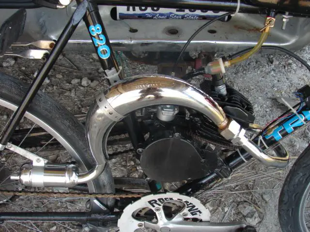

Just put this on today.... Had to bend the pipe just a little to clear the peddles...
I'm still working on the bracing....
Anyone have an easy idea for a leg guard??
Have only rode it for about 2 miles, but it gets the exhaust noise behind me, so all I hear now is the noisy engine....I think it is quieter than stock...
It seems to run a bit smoother and a small increase in low end torque....
I dont know how top end is, I generally only run to half or 3/4 throttle....
This pipe was 50$ shipped......
