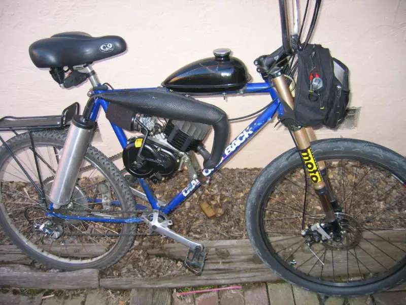

Got Pipe? I don't recall you specifying 2 or 4-stroke, but here's my pipe.......
With muff
Without muff

Nice expansion chamber install. It fits the bike but I'll bet you're glad the heat shield is on there. Expansion chamber exhausts have to be the hardest because for them to work right they have to be the correct length, etc... Is the noise level harsh? Who wouldn't like more speed but I want to keep the MB as quiet as possible and skirt around potential street legal issues.
(I just realized my car's exhaust can set off car alarms but the noise never bothered me.)

I just made this from EMT and a VW bug tailpipe. I don't know what it will do for performance but like how it looks.

It sounds like a deep, throaty 125cc engine now. Not too loud either, but I might make a glass pack insert for it in the future...

Around here these MB's are not legal. I made my exhaust as quiet as possible to stay off their radar. The most notice I've had from the police is a wave back as I ride by. I like riding smooth, quiet and slow but faster than the other bikes can pedal. When I want acceleration I can drive my Stage-II '97 Eclipse GS-T. I still haven't had the guts to find top speed.

It's very quiet. The noise from the intake is the loudest sound my motor makes. It started as a eBay exhaust I could not fit to my bike. I bought a length of 3/4" emt conduit and borrowed a pipe bender. I have a little stick welder. I cut the flange and muffler off the eBay exhaust. I bent the conduit, welded it up, ground off the ugly parts and there she is.
All I can hear from the back of the pipe is a real nice soft pop as it's in the sweet rpm zone between 23 to 25 mph. The longer pipe increases torque. I can climb hills that used to slow me down. No better top speed but that doesn't matter to me. I like seeing, hearing and smelling what is going by as I mosey along.
