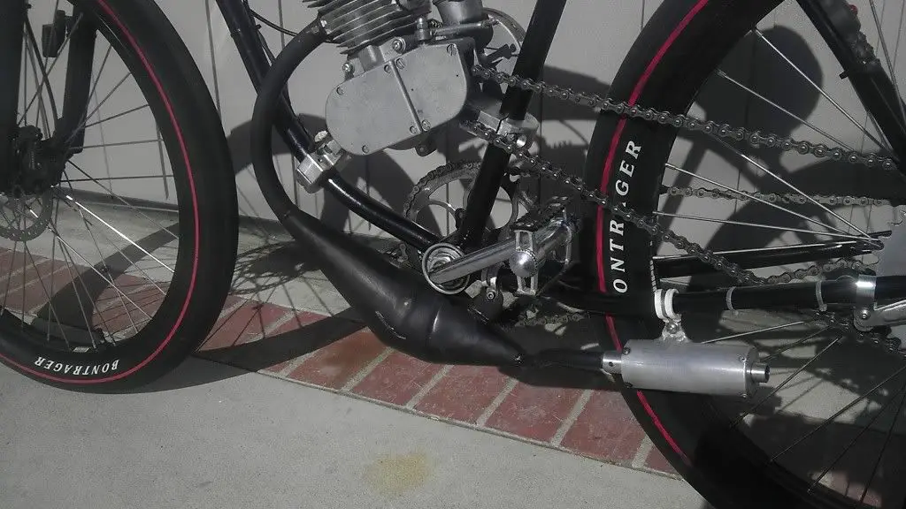

I've been running this one I built the summer before last.
I made the steel flange from flat bar stock and made a much larger diameter opening that matched the size of the exhaust port in the jug.
It's brazed to a pocket bike pipe I got off of E-Bay for $10.
Unlike pipes with skinny header pipes this thing doesn't fall flat on it's butt at high rpm's.

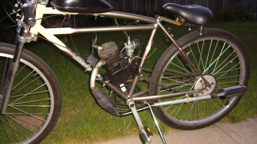

Here's my exhaust. It starts out as stock flange, goes to 3/4" copper, then because of the length, goes to 1" copper, a homemade expansion chamber, and finally 3/4 " copper connection with Briggs muffler. It works good, but ended up longer than I wanted it and the Briggs muffler is louder than I'd like.
All but the muffler is brazed together. There's a hanger between the pedal crank and kickstand, and another one at the rear axle dropout.

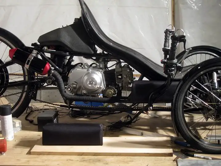

SBP system w/heater hose extension;
SBP chamber only w/kit manifold & fabricated 6" glasspack;
Aftermarket silencer & fabricated pipe w/header wrap;
